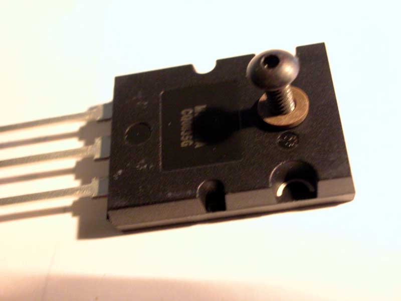

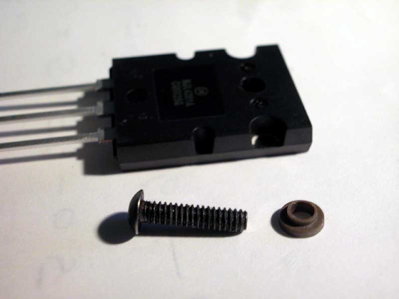

Actually the transistors do use a shoulder washer. (see photo) The #4-40 screw is too small for that transistor. It all fits just right with the part number previously given.

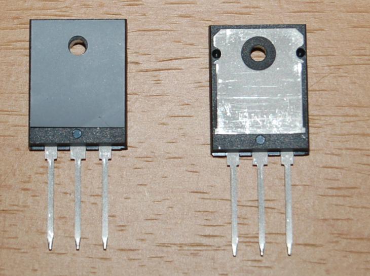

I would like to know if anyone has found a TO-264 insulator? The Al-oxide pads (4180G) just fit the die area under these transistors
I found these insulators at Mouser: P/N:567-175-6-280P. Cost is only 32 cents a piece(half that of the Al-Ox). I believe these will work fine as well.
Attached is a photo of one applied to a 4281.
-Chas
