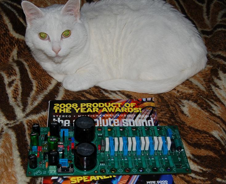

All stuffed!
Currently, both the Leach PCB's (and the cat) are stuffed!
Now to measure/match the drivers & output devices and install.
Unfortunately she has a recurring appetite (big eater), but she likes my music enough to come in while I'm listening and curl up on the chair.

Rob, Elaborate a little on the awards cover story. Where can I read the article and which pcb. Tad
Jen's PCB layout made The Abso!ute Sound's Product of the Year Awards cover!
Tad, look more closely at the picture
Oh boy did I get a good laugh outta this! 🙂
(sorry Tad...)

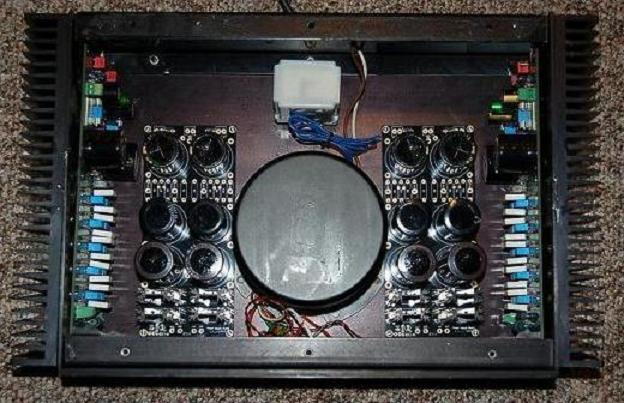

Today I laid out all the parts, checking to see if my chassis have room for two channels, at the urging of another DIYer, who says there's room.
It looks like a tight squeeze, but everything just fits.
Anyone here foresee any problems locating the PSB's so close to the circuit boards?
The approx 600VA transformer is from a stereo receiver, so there's only the one set of center-tapped secondaries.
I'm hoping that I can split it (attaching two sets of leads in a "y") to feed both supply boards, but the total capacitance will be almost 2x greater than in the original receiver- sound feasible?

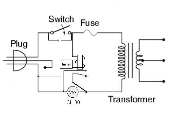

I will be using a CL-30/delay relay combo to limit turn-on surge.

Chas, where did you score the delay relay? Part number? A reasonable price point on this could simplify my efforts...
The chassis layout looks good. Admittedly, I have no idea how much heat the PS will generate but your build looks spacious. What rail voltage will you get from the 600VA?
Total rail capacitance?
FleaBay, of course! They sell for an average of $15.
Check out the following:
eBay Item number: 330308432876 (lot of 4, similar to mine)
eBay Item number: 350167551297 (requires a 24vdc source)
Attached is a diagram of my relay setup, which shorts out the CL30 after a 5-6 second delay.
The secondaries are 45-0-45vac, so approximately 63vdc rails(no load).
I used six 4,700uf*snap-ins per PSB. If you count the 2,200uf KG caps(thanks Michael Percy!) on the PCB(C21/C27), that makes 16,300uf per rail. So the amp has 32,600uf per channel and that makes the total 65,200uf (the receiver the traf came from had one 15,000uf cap per rail, or 30,000uf total).
-Chas

p.s. You may need a relay socket and, if purchased new, these will set you back $5-$10 additional.

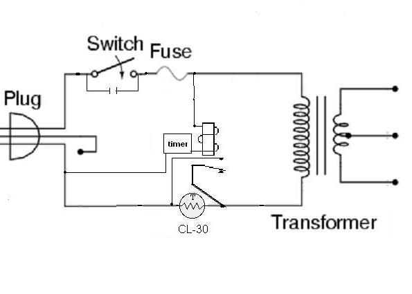

Unless you can set forth a reason I can't think of, I would recomment connecting the delay relay coil at a point after the fuse instead of between the switch and fuse.
In my haste to illustrate, I made an error! 😱
Thanks for catching it. 😎
