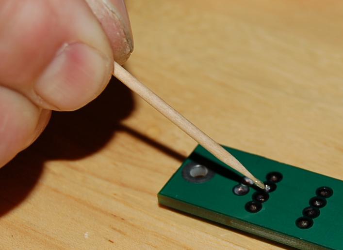

Re: Why insulate at all?
clm811 said:
Guys!
why would we need any mica/kapton/tape, etc at all?
The (mine at least) diode leads do not protrude all the way through the diode PCB!
Why don't we just use a thin layer of thermal compound on the two mating surfaces?
Jens wrote:
While I am not in this stage, I can think of 2 possible reasons:
1. prevent the possibility of the thermal compound being conductive. The compound can go into the hole and contact the leads.
2. the little pcb may not be as flat as it can be, if so, combining the pad and the thermal compound probably have a better heat transfer.
I intend to use the SMD PCB directly to the heatsink with a smudge of grease. The PCB is small/low mass, the mount screw will aid in the heat transfer to the top side, and the devices are in close to that VIA - mount hole
Do we really think that this kind of approach won't be well suited to the task :confused: Personally, My only other real option would be ill-fitted mica, as I don't have the Kapton tape. Maybe I'll use a cupped washer and really crank the screw into the heatsink :devilr:
Fred does make a good point about thermal grease squeezing up into the diode holes and creating an electrical issue. I hadn't thought of that...
... thermal grease squeezing up into the diode holes and creating an electrical issue...
I had dodged that bullet by putting a tiny drop of epoxy into each bevelled hole with a toothpick. Super glue would do as well. Just be careful not to get glue residue on the surface, or it could interfere with the mating of surfaces.
