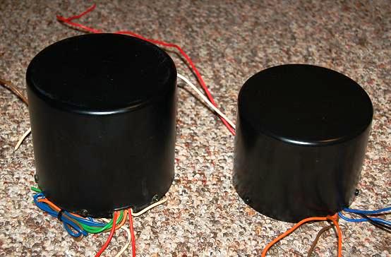

Which transformer
I have two pairs of transformers from which to choose:
Type#1 (from 120W stereo receivers) has a single set of center-tapped secondaries(45-0-45vac), weighs 13.5 lbs and I don' t know the VA rating;
Type#2 (from a 100w dual mono amps) has TWO sets of center-tapped secondaries(40-0-40 vac @ 1.6Aea), and weighs a tad over 9 lbs .
I plan to use the BrianGT power supply board, with between 22,000 and 33,000uf per rail.
For use here in assembling stereo amps, which would be more advantageous?
How about for assembling a pair of mono amps?
Here's a photo of each:

Both stated VA ratings seem low for a stereo amp. However, depending on how much of the weight is potting, they may be suitable.
Avel's un-potted 650 VA transformers weigh in at 10.8 pounds. The larger one could be capable of similar output. The problem is the voltage rating demands a higher VA rating if you want to extract the maximum power from your amps.
In normal home use (is that becoming my trademark?) you can use either, especially if your speakers are near 8 ohms nominal. No, you won't get as much power as the amp is capable of into low impedance loads. However, toroidal transformers can handle significant intermittent overloads. I'd lean towards the smaller one for its separate windings and the fact that you can use 63V caps.
If you want to get higher power into lower impedance loads go for at least 600 VA. You know where I'd look for inexpensive transformers...

I got 170W into 8r0 from a 0-40, 0-40Vac transformer using Jens' 3pair board. It was over 300W into 4r0 but SOAR is well used at this combination of voltage and low impedance.
If you plan to never use 4ohm, nor 6ohm, nor 4 to 8ohm speakers then the higher voltage transformer can be used for 8ohm speakers and above.
But, the 45Vac will require >=75Vdc capacitors.

This translates into 130VA per secondary. If you parallel 2 secondaries, this is equivalent to a 260VA 40-0-40 which should be good for one channel, i.e. one mono block. This is pretty much half of the Avel 530VA 40-0-40 that I plan to use for a stereo.clm811 said:

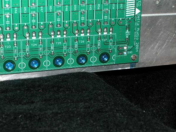

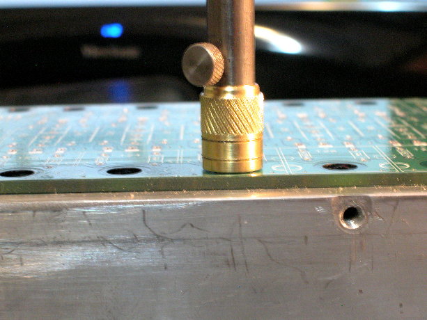

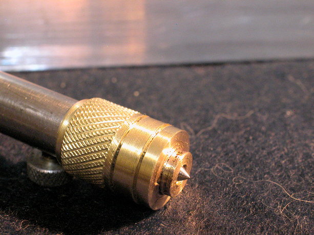

If you are about to drill and tap the heat sinks, putting thoses hole dead on is no easy task. I made a small fixture out of brass. Use a 1/8th drill rod in a hole through the brass. Grind a point on the drill rod. Machine a step on the brass so it will just fit in the large holes tightly on your pc board. Once you have bolted your pc board to your heat sink, use the brass piece and the pointed drill rod to center punch all the rest of the holes. If the drill rod is centered in the hole in the brass, then all the center punch marks will be dead-on.
Heat Sinks
more photos
This should also work with the stand-offs in position if you already populated your board. You will lose accuracy as you move away from the Heat Sink but it should work with the stand-offs in place if the board is already populated.
more photos
Nice going my friends
Thanks, Fred. That is reassuring, since I was beginning to feel a little buyers remorse.
NICE WORK BRUTEPUPPY!!!!
Time and again I'm amazed by your skills and ingenuity! I'm glad those new boards are working out for you. Once the doc sez I can get back on my feet, I'd like to bring my precious heatsinks over to mark them with your cool device- hope I don't Gall'em (hehe) 😉
I consider myself lucky to have such good friends here (you too, Tad and Bob)!
I'm expecting another good DIY friend over tomorrow, just planning to hang out and listen to some music- after all that's what this is all about, right?
Everyone: PLEASE post your progress pics(no matter what stage).
-Chas

BP, That is a nice little rig you built there. I use transfer punches which come in graduated diameters. You can get a whole set from Harbor Freight for about 6.00 bucks. In any case it makes for more accurate drilling using these kinds of setups. I like the nice knurled knob. How did you make that?

Tad, the whole set of transfer punches seems like the "way to go" if you cannot make your own as I did. I have a lathe and can make my own transfer punch, hence. a nice close fit every time. The knurl comes from the use of a kurling tool specifically designed for small lathes. I got it from "Little Machine Shop" on the web. It's the scissor type and does not put a lot of strain on the tool post and works really great. I highly reccomend it to any of you that may have a small lathe.
BP
