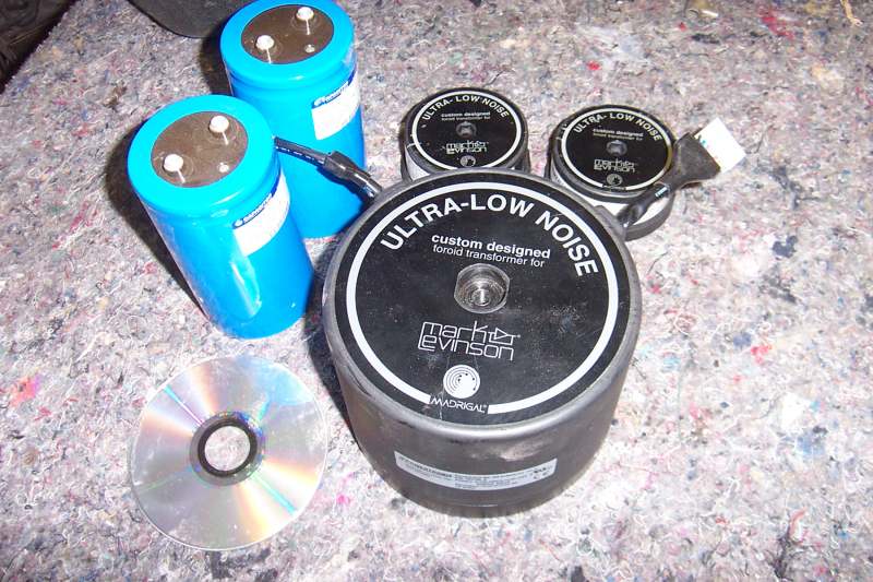

Here is my salvage toroid. Honestly, it came from a scrap guy.
That's why I'm building the amp... I needed a good amp for the traffo😀
Tell me how to dig out these kind of land mine, I will do the suicide dig
Nice find Marc.
Wow, Marc!
Tell me, did your "scrap guy" have any other(say ,"Krell") parts?
That's MY kind of scrap yard!! 😉

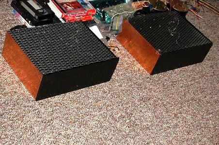

Attached is pic of progress on my two mono-block chassis.
I'm using 2mm copper plate(scraps)which acts both as side of enclosure and as heat spreader to join my two 6" wide heat sinks. The front(inner), back and bottom are 1/8" aluminum plate, adding some heat dissipation as well. Front panel is 1/4" brushed/anodized. All from "scrapped" enclosures. Top screen is expanded steel mesh from Home Despot (gotta let the heat out somehow, or we'll "cook" the caps)...
