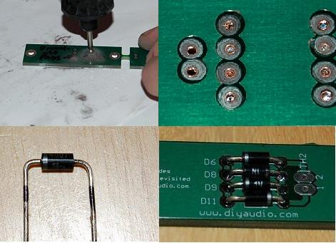

details on diode boards
I noticed that the Thermal tracking diode PCB's in this latest group buy are plated thru-hole to unmasked pads on the bottom side.
I'll grind the pads off with a Dremel.
I just got around to doing this. A small round burr tool seemed to work best for me.
To make sure the diode leads don't protrude, I used a black extra fine Sharpie pen to mark the leads where they protruded from the bottom of the board. I then cut the leads slightly above the marks and soldered them in.
-Chas

Why do you need to do this? Turn the board over and contact the diode BODIES to the heat sink.
Yours may be a fine way to go as well.
Because this is my first scratch-built amp I'm just following the designer's recommendations, since temp compensation is critical to the correct operation of the amp. Plus, Jens shows this orientation on his website.
-Chas

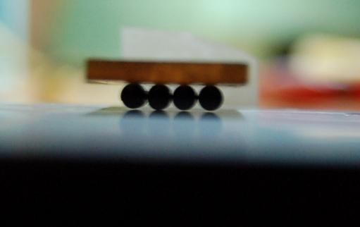

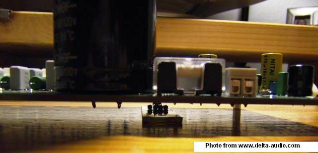

According to Jens the large surface contact of the copper plane(which is tightly fixed to the heatink), plus heat conduction through the copper leads assures good heat transfer.
Attached is a photo of the same board with the diodes against the heat sink. Contact area may not be that great due to small variations in the diode bodies, so be sure to use thermal compound. However, you could work the entire assembly against a file or fine sandpaper to file/grind a consistent flat area across all the diode bodies.
I will probably flatten the diodes where they contact the diode PCB on my second amp assembly just to be sure. Just be careful not to overdo it, or the diode could become damaged.
-Chas

There must be some sort of electrical insulation in Jens orientation. Possibly a thermal pad? I would worry about punch through in the pad. You could also mount TO-126 or TO220 transistors (as diodes) on top of the output transistors to thermally couple directly to them, and connect their leads to the diode circuit board.
