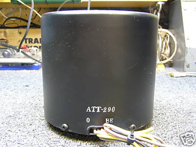

Potted Power Transformer
Guys,
If anyone here is interested, there's one of the nice Pioneer 120W/channel Potted power transformer (Bando#ATT290) listed on eBay.
http://cgi.ebay.com/ws/eBayISAPI.dll?ViewItem&item=260369312805&ssPageName=ADME:B:SS:US:1123
This really does make a nice amp with the Leach boards. I'm using two of them.
-Chas
Guys,
-Chas
Looks like someone snapped up that traf asap with buyitnow; however, another Pioneer (by Bando) 120W/ch potted trafo just came up (surprising, as these are pretty rare- esp. for $30):
e bay Item number: 260369512151
When using these, I calculate the resistor value for R3/R22 to be 2.7k ohms.
Any others have pics to share?
-Chas
