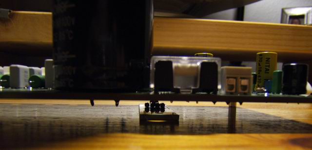

Do you have a better picture of how is the thermal diode mounted on the heasink? There's a picture of this thermal diode mounted at the bottom of the main pcb to the heasink at Delta-Audio website but it's not clear to me. I'm not sure if the diodes should be facing the heatsink laying flat or not.

Fredlock, The diodes you are referring too are soldered directly to the small pad provided as part of the pcb. Standard diodes or smd types both work. You cut this piece off with a saw, dremel or what ever. Make sure the leads of the diodes do NOT PROTRUDE through the board and touch the heatsink. Then you screw this small board down to the heatsink all of which is mounted under the main board. There are two windows for the screwdriver and screws to be accessed. The copper in the diode board provides good thermal delivery for the diodes to track with the heatsink temperature. You then run 2 wires from the small board pads to the pads on the main board. Everything is well labeled on the silkscreen printing. If you layout all of the areas you are going to drill and tap with clean empty board and make your connection wire long enough it is not too terrible difficult.
It would be relatively easy to hard wire the diode pins together to form the Vbe multiplier temperature compensation.
If Diodes alone are used then 5 seem to compensate for the four Vbe variations of the driver and output stage.
When Leaches diode compensation is used 3 diodes seems to be too little (undercompensated) and four is clearly too much (over compensated).

Thanks for your reply. What I'm trying to understand is, if the thermal diodes should be facing the heatsink or not. But based on this picture attached, seems like the thermal diode board is facing upward. Would it be better to be facing down for a better thermal sensing? On the original leach amp, they used to stick those diodes in the heatsink. Just wondering? 😕

If you read Professor Leach's page closely you'll see that three diodes was a better amount of compensation than 4 (slightly overcompensated), but 4 was chosen so that the leads would come from the same side of the heat sink.
There have been hundreds of these boards sold and I haven't heard of anyone having thermal runaway issues. You should be safe mounting as pictured. (just ensure that the diode leads are clipped short enough that you don't have electrical contact between them and the sink.)
