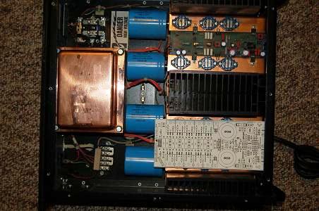

Bob, This is my A-75/250 amp. My trannies have extra auxiliary windings - 12 and 20 volt - I am going to series the 12 volt with the main secondary winding and then I should have a good 16 volts dc over the rails for the frontend. I think this will work. I tried it temporary and all was well. I guess I should put a 100 ohm resistor in there to keep the available current in check. I made two little boards with the electrolytic and film caps you recommended for the supply to the frontend, also has a small homemade rectifier on it. Just makes me mad I did not order the correct trannies. Not thinking again.
Thanks Tad
Thanks Tad
That should work fine as long as the windings are completely separate. The 100R is also a decent idea - Use a 1-2W resistor for reliability.
I've got a couple dual 15V transformers for just the same application.

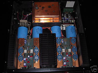

Actually, the previous owner "hacked it up"; I just saw it as a huge power supply and lots of heat sinks for the money... The original design was prone to blow-ups(usually caused by DC offset frying the unlucky loudspeakers)...Also, I read that both the original input and output devices are obsolete and now impossible to source (Per Paul McGowan himself).

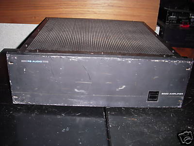

You should show the Leach droooolers a piccy of the 200C's front plate,also a beaut for an amp conversion mock-up job.
Here's a picture of how this particular 200C's front panel looks (it really was "hacked up"!!) I'll have to refinish it somehow... any ideas for refinishing scratched/scuffed anodized aluminum?

You might not be able to put the black finish back on real easy but sanding the front in one direction with good 220 grit paper will give you a nice brushed aluminum look. Then you can seal it. You could anodize it at home -- lots of stuff on the web-- but it might be more project than you want.
Tad
Tad
Assuming you're not in a hurry, I've heard that commercial anodizers can remove the old coating and anodize fairly cheaply. The way to get the cost down is to leave the parts with them to fit in when they have extra space in a batch.

Alternative is to have the front panel powder coated, other than looks it makes little sense to have an anodised front, especially with the heatsink set up of the 200C.

Using T03 Transistors with Leach clone boards?
I suspect that the MJ21195/6 Transistors (TO3 case )will work best for my PSA 200C power supply 75v-0-75v- especially if I want to still use high-bias output. (My speakers are a pretty even 4ohm load) & I can get these devices cheaply from Digikey...
I was wondering if it would be possible(or problematic-?) to run these from the 10 transistor Leach clone boards, say by running short leads to the transistors...?
My 4.5"x 7" heat sinks and pos/neg copper rails are set up for this type of T03 case transistor...
Photo attached, showing one Leach board silkscreen superimposed above the old 200C PC boards.
(Am I barking up the wrong tree here?)
TIA,
chas.

Would you all recommed using 5 pairs of MJL4281/MJL4302 instead, with my 75-0-75v rails, and horizontal mounting the board (not using the copper plus/minus rails) w/just the twin 4.5"x 7"heat sinks, one for the 4281's and one for the 4302's )?
Again, thanks for any input here.
-chas
-chas
5pair of MJL4302/4281 (To264 230W) is a superb output stage and will work very well on a +-75Vdc supply. If the PSU is up to the job I would expect 550W into 4r0 and capable of driving a severe reactance speaker with phase angles approaching 60degrees.
Direct connection of the outputs to the heatsink is always better than using an aluminium mounting block/angle, except when the angle is formed from thick copper. This distributes the heat more evenly along the sink particularly when few devices and a thin backplate are combined.
Your 5pair and thick backplate cannot use the copper to any significant advantage. I suggest you ditch it and go for direct fixing.
Are you building 2channels? i.e. 10off each device. Buy 12off each and select the 5 closest in the lower group and 5 closest in the upper group for the NPNs. Repeat for the PNPs. This should give adequate matching of the BJTs.

p.s. I picked up another PS Audio 200C yesterday(although for double the price of the first); These make a MONDO platform for this amp (plus I'll recycle all that copper to offset my parts cost). 😀
