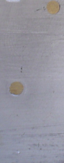

Closing the T03 holes- how would you do this(I'm guessing inserting a similar diameter copper rod, soldering in place, then trimming)? Would you say to avoid using T03's (with their required extra lead wires)?
"Remounting the copper (to the heatsink?)with a silicon insulator sheet" - does this truly preserve the thermal advantage of the copper, as opposed to going directly to the heat sinks, as Andrew T. suggested? Also, would heat sink compound be contraindicated here?

I built a few power amps with MOSFET TO-220 output devices, mounted with just thermal goop on an insulated L-shape profile.
Mounting them with mica insulators straight to the heatsink would have required fan forced cooling of the heatsinks.
If the contact surface between the bracket and the heatsink is sufficiently large and smooth enough, it saves a lot of thermal resistance.
The ground return in the 200C is a copper bar as well, the hardware volume in this early 80s power amp is remarkable, in particular considering it's msrp.
Tight fitting copper rod inserts, flat end surfaces, just a weeny bit longer than the thickness of the copper angle.
Brass works too, though much harder to transform than copper.
Best would be to press them in, but that requires access to pro machinery.
At home you just put the copper angle between two lengths of large dimension solid square steel and flatten the inserts with a hammer, finish with a dremel or a hand-file job.

and then hone "flat" if any semi passes over these "rivets".jacco vermeulen said:Tight fitting copper rod inserts, flat end surfaces, just a weeny bit longer than the thickness of the copper angle.

...Tight fitting copper rod inserts, flat end surfaces, just a weeny bit longer...put the copper angle between two lengths of large dimension solid square steel and flatten the inserts with a hammer QUOTE]
Ok I suspected that, just like my Dad used to hand-make his stuff on an anvil (Grandpa was a blacksmith)!
