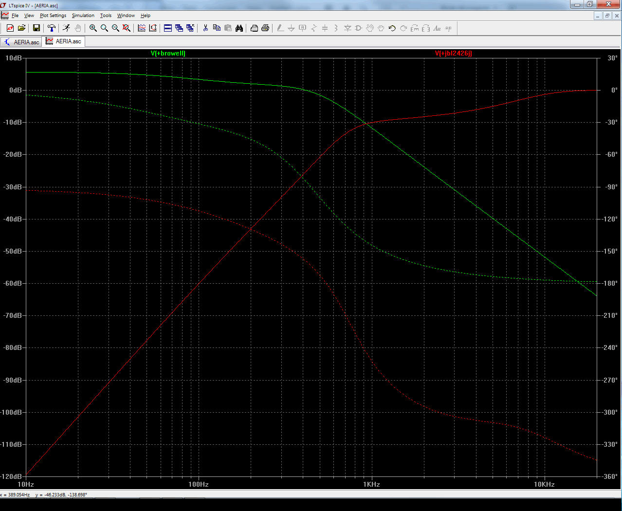

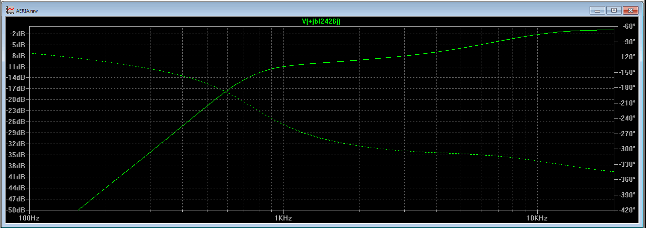

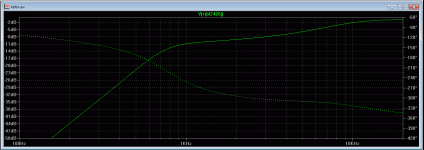

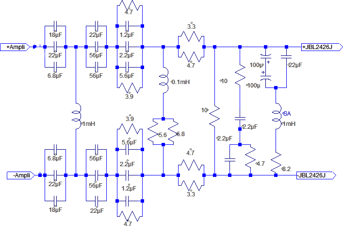

For those who can be interested, the passive filter for JBL2426J (16 Ohms) designed by François Delamare for the first AERIA system, before the catastrophic mod done on his enclosure after his departure from the "Maison du Haut parleur".
First is a 18DB/oct classical filter at 750Hz, followed by a curve response compensation. Then the passive attenuator, then a precise ZOBEL (inductance compensation) up to 100KHz, then a motional impedance compensation.
Response curve is near a strait line up to 16JHz, as well as the impedance curve up to 100Khz.

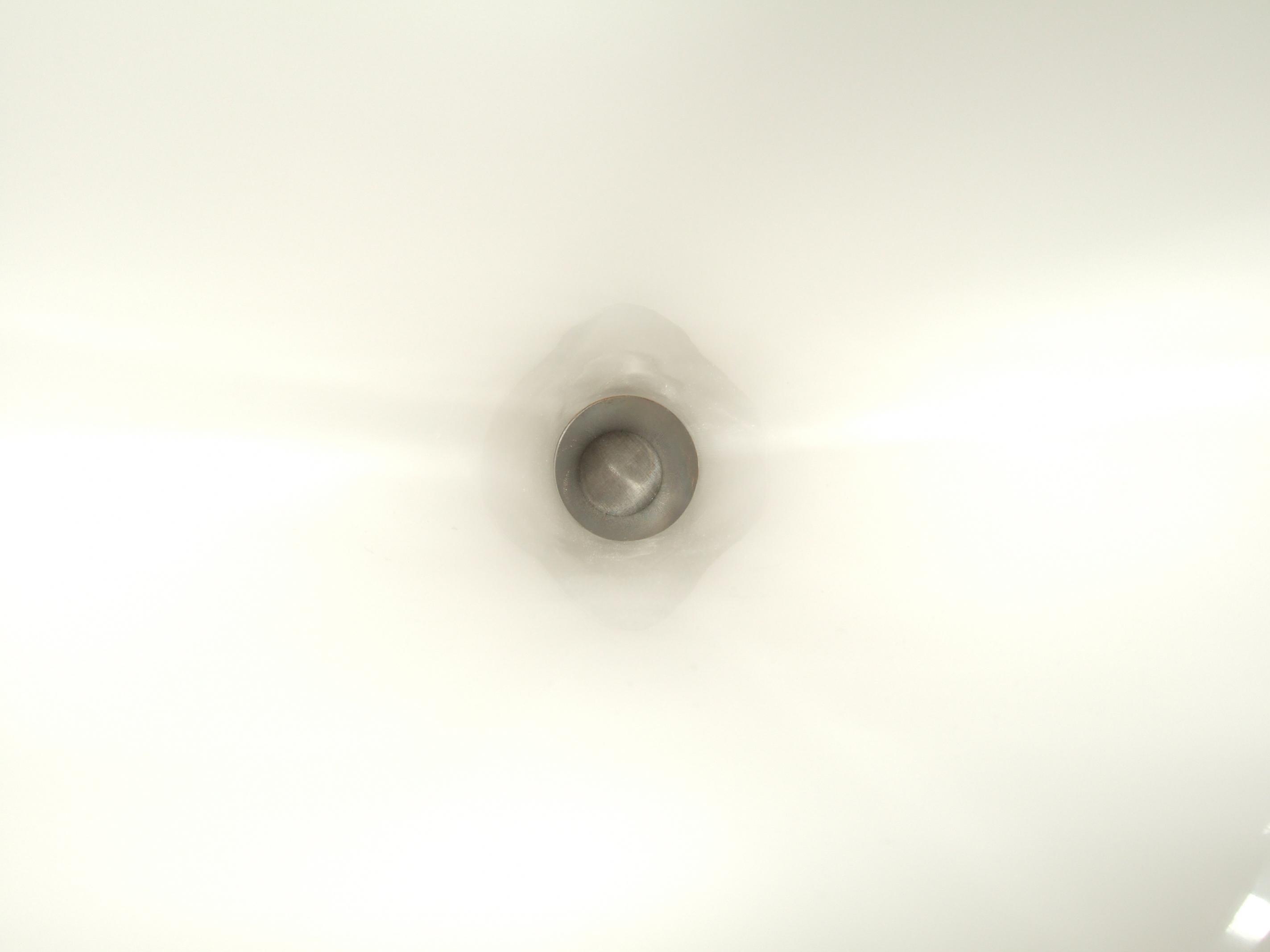

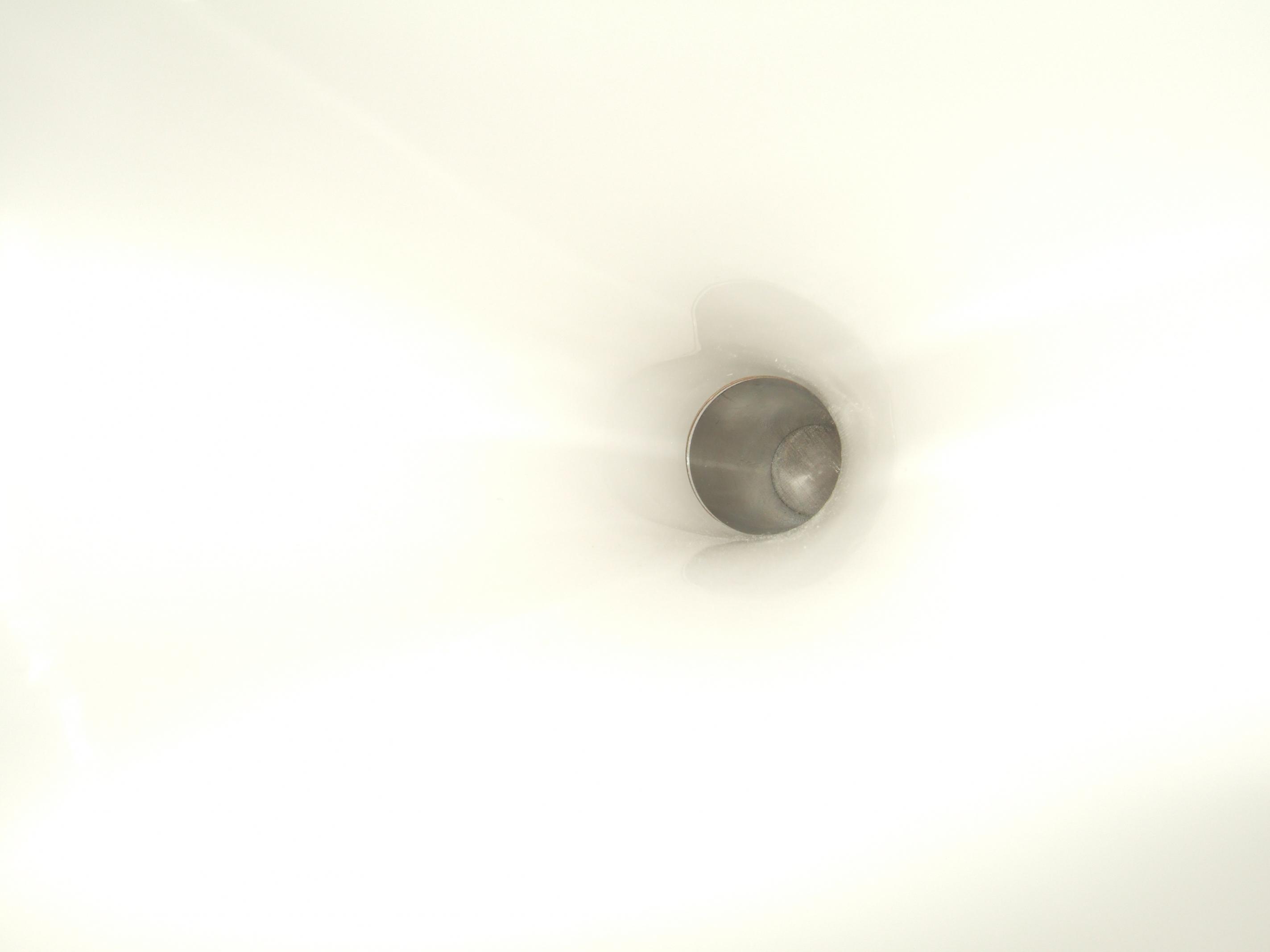

not much i guess
biggest issue might be to achieve exact matching hole size
and the small edge you get when mounting
besides, due to center plug or diffuser, exit throat area could appear to change quite rapidly, and result in totally different exit 'angle'

From what I have read/understood, better matching of the two (driver exit angle and horn throat angle), results in better response. Are there any guidelines on what this difference should be for optimum performance, and is there a point of diminishing returns?
If matching of the driver/throat angle is preferred, it would be nice for horn vendors to provide this data.

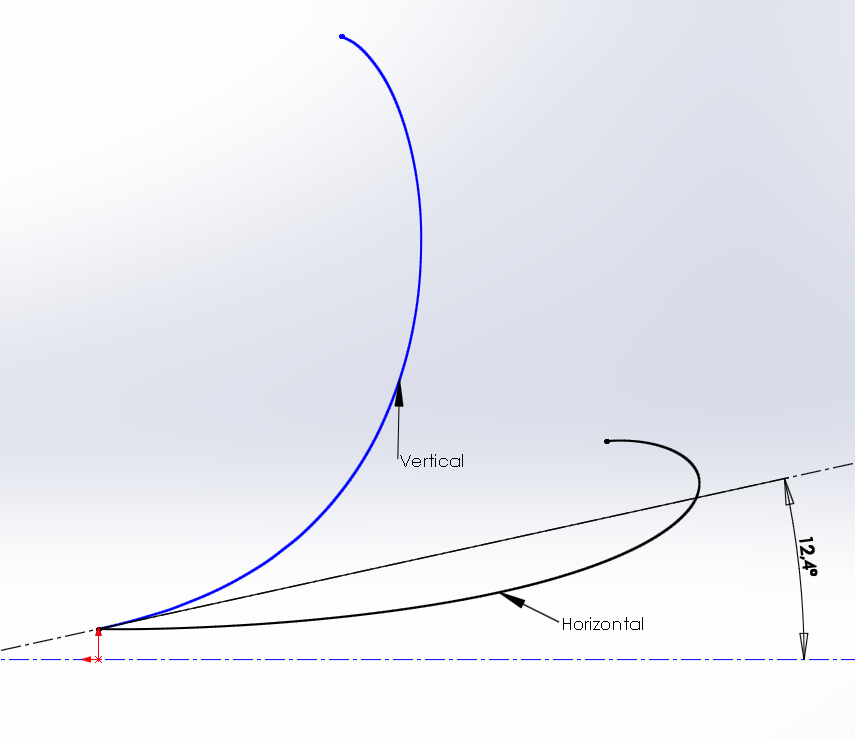

Question : Horizontal/vertical swapped in the picture?

No cut the hair in four parts.😀
The EJLMC 600 + TAD 2001 is one of the best of the world médium / treeble system.
No need to modify any thing for have a very good sound.
