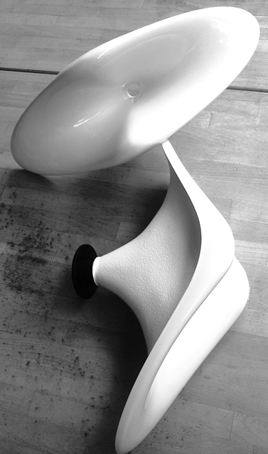

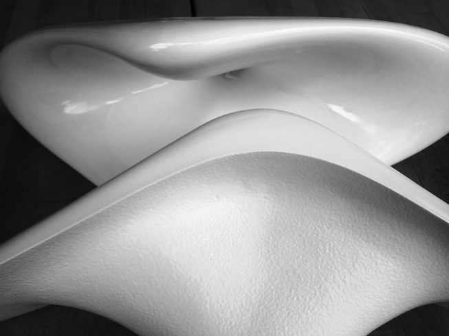

EJMLC 600
Just a quick message to tell you I received a pair of EJMLC 600 horns from Autotech in Poland this morning. The quality is amazing. They really did an outstanding piece of work and both horns are by themselves nice objects to look at. Even my wife said they will be nice in the living room. A big thanks also obviously to Jean Michel for the design.
Just need to build the box for my Supravox 286 GMF and design the filter to enjoy those piece of art. For the ones who would like to know they will be used for the time being with BMS 4550.
