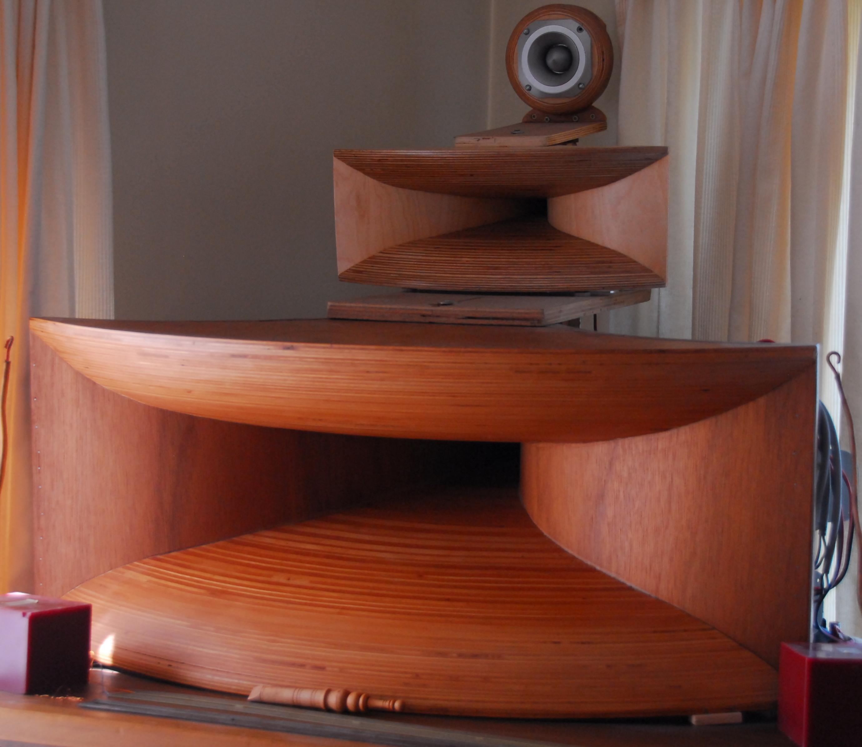

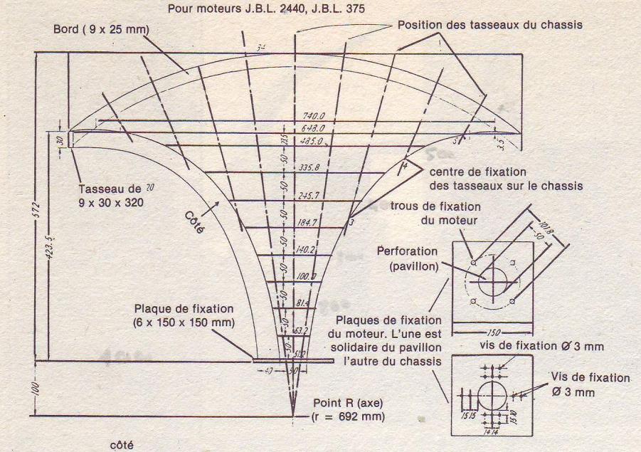

A DIY classic Iwata 2" in wood-multi-slices (glued) ...
Nice & WAF=10/10

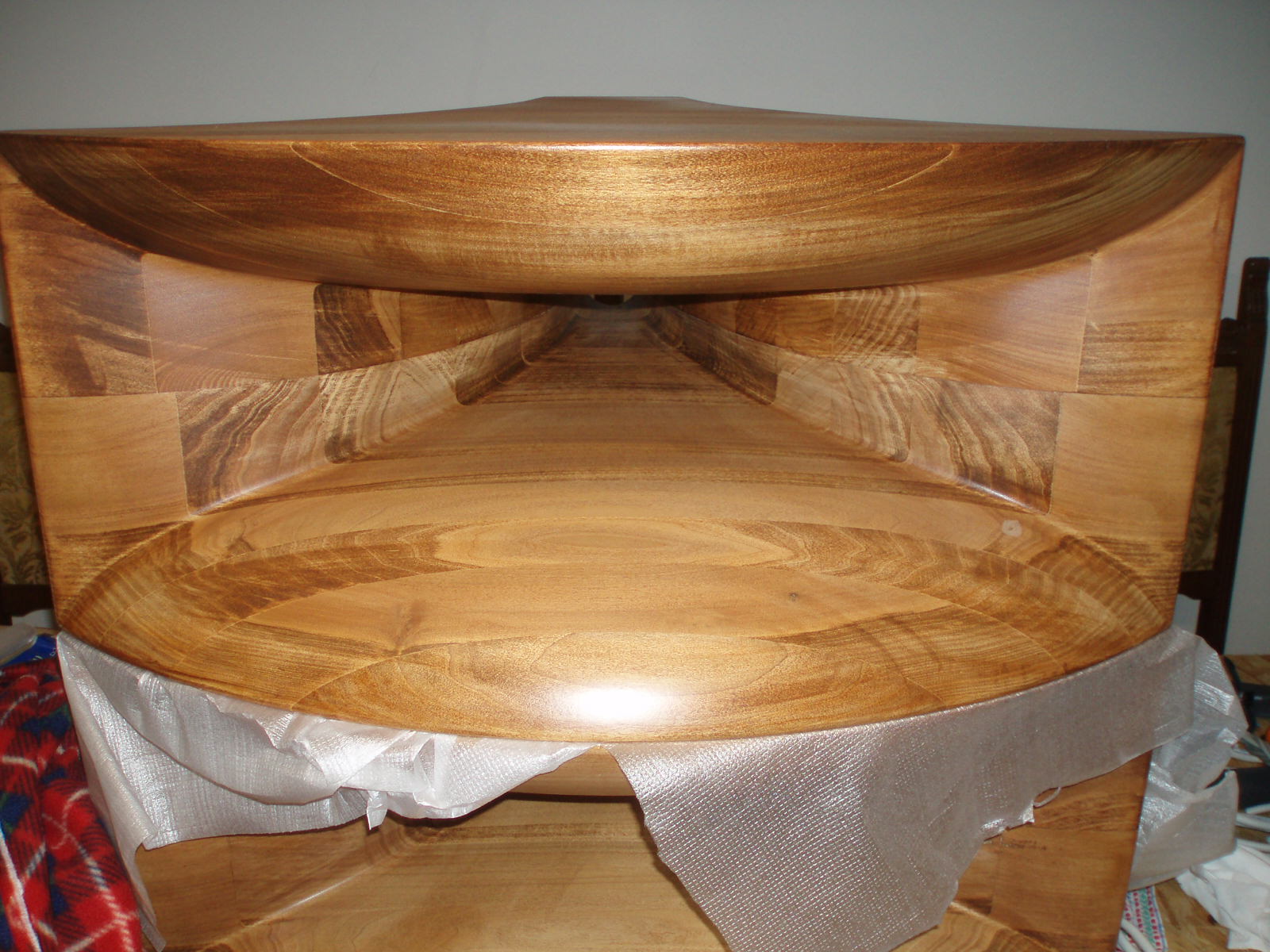

Maybe very thick, dense wood. The throat is the area that needs the most attention.
The resonances are most common in the middle in the front when it is the wood horn I have, built according to the drawings. And the same according to the original JBL horns I have tried. Used freestanding, mounted in a baffle is most likely a totally different issue.
Less predominant towards the sidewall and certainly much less towards the driver.
I have had quite a few horns and I would say that all horns are suffering when the end looks thin like a lip. How many has tried to make the end of the horn a bit rounded backwards for limiting the sharp end so the material is quite a bit thicker? And how does that affect the dispersion?
/Harry

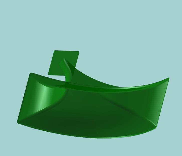

Both Arai horns (A-480) and the classical Iwata share the same problem: their throat adpater 'round to sqyare) is too short and induded diffraction at throat and HOMS.
I designed and calculated the iwata-JMLC in order to avoid that problem.
http://horns.pl/images_old/horns/iwata300wh4.jpg
But the spreadshhet to calculate those horns is large (more than 100Mo) and is difficult to use... So it is not public.
But the spreadsheet I once wrote to calculate the classic Iwata horn is available somewhere on Internet.

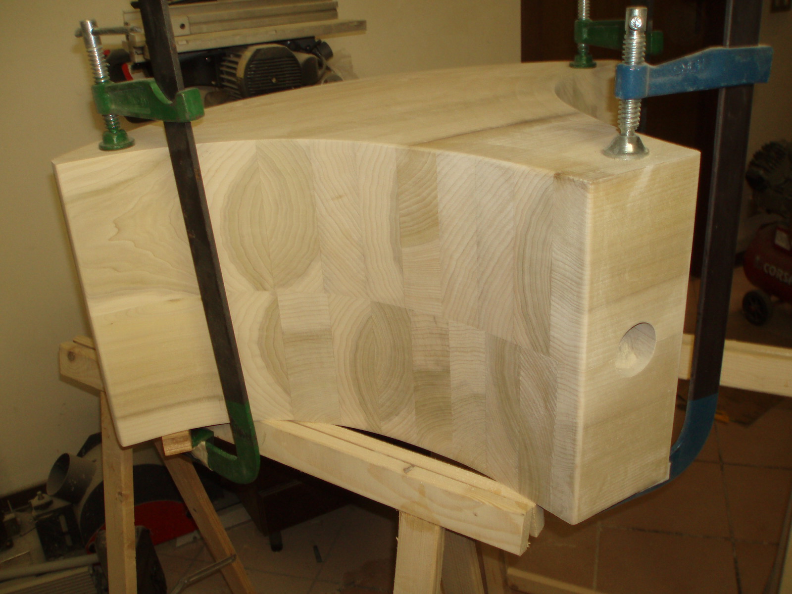

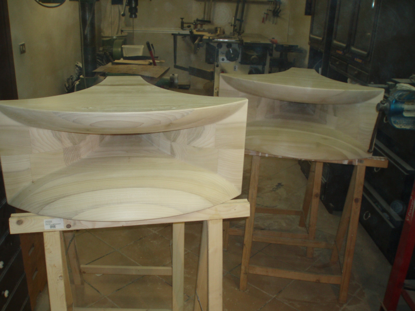

anch'io ho costruito l'iwata classica,
ma vorrei provare a costruire l'iwata di JMC
si potrebbero avere i disegni ?
Qualcuno ha confrontato l'iwata classica con
l'iwata JMC?
Grazie

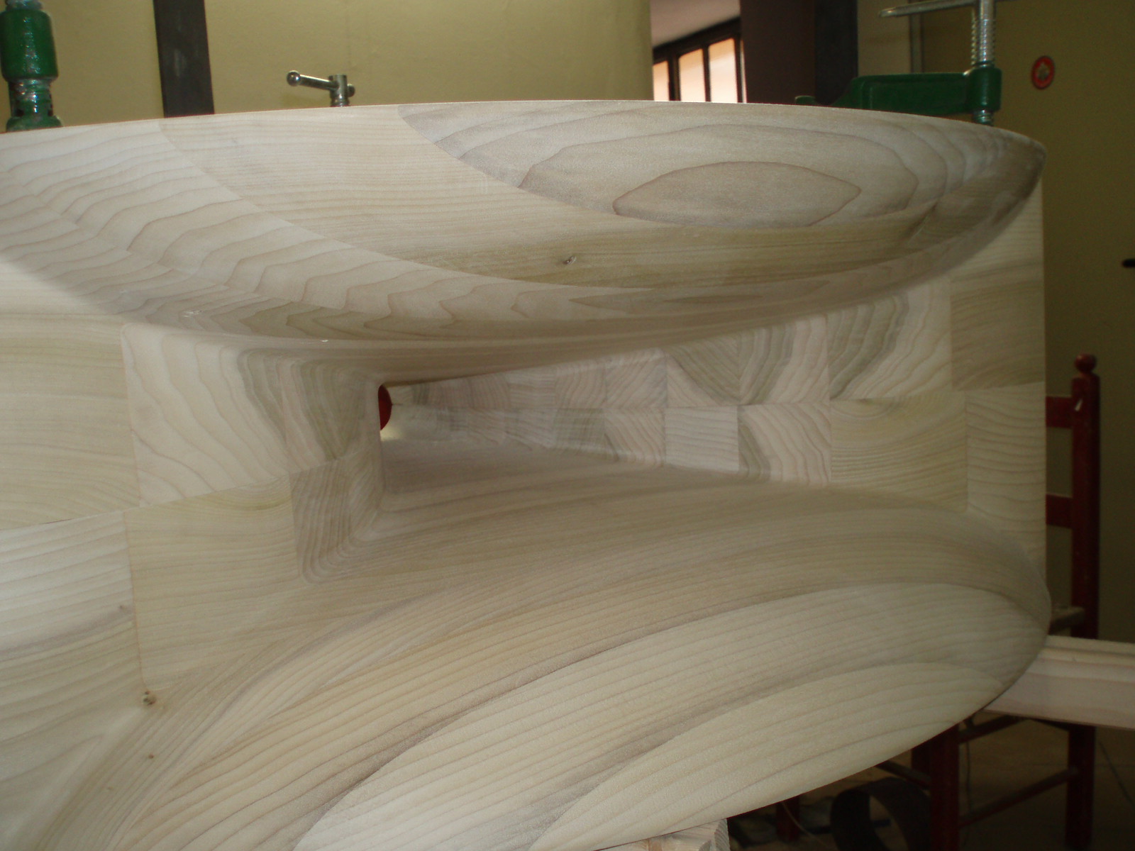

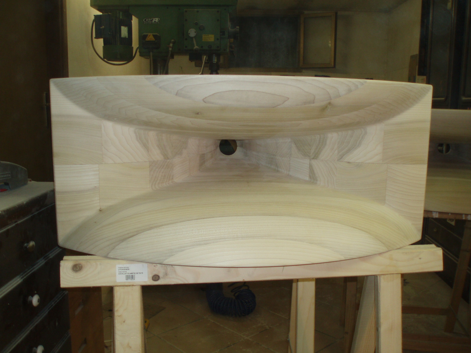

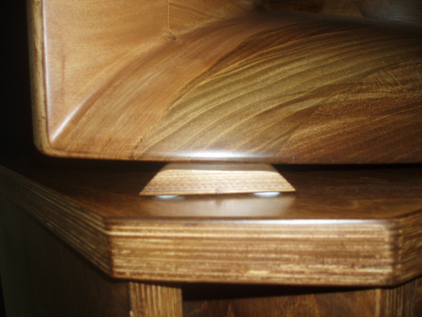

photos
