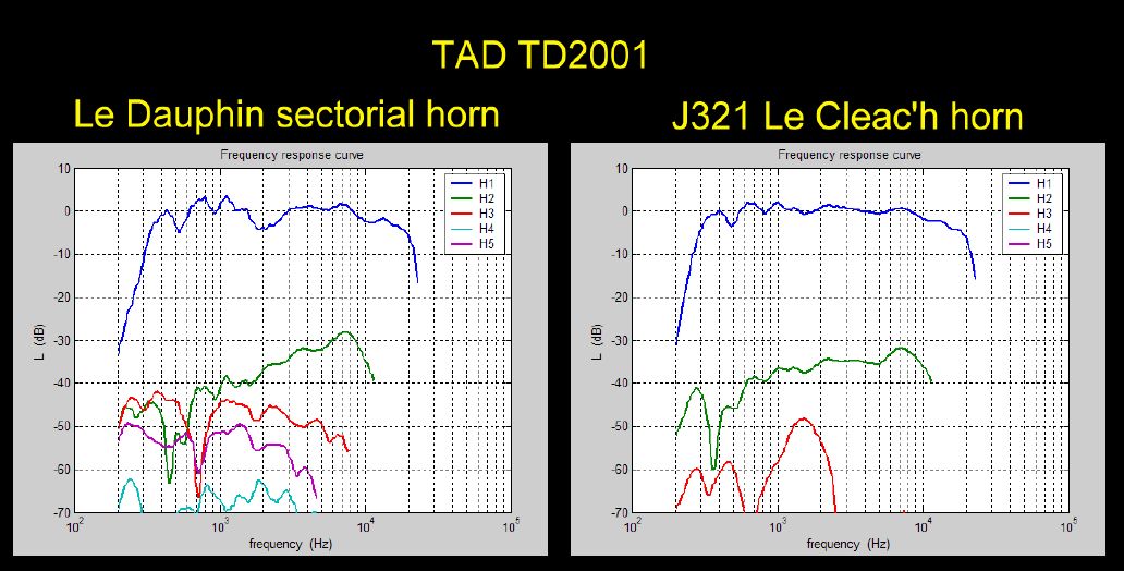

Hello Esperado,
Apart the air non linearity at throat that a horn provides due to a large ratio mouth area / throat area, I don't think a horn can bring distortion by itself.
Bad horns and noticeably the ones based on diffraction (waveguides...) may eventually redistribute the distortion components appearing at the throat in more or less discrete directions. BTW the same effect is desired in ultrasonic devices fro which we want them to deliver a thin ultrasonic beams...
It make me smiling when I see people asking for the distortion curve of a horn considered by itself. There is not such. But the way a horn loads more or less resistively and actively a loudspeaker can for sure leads to differences in distortion curves (on the same driver).
As an example, see the measurement I have done at ETF2010
(Measurements performed on 16 horns ... http://forums.melaudia.net/attachment.php?aid=1760 )
from which I extract the measurement of a TAD TD2001 on 2 different horns :
- Le Dauphin sectoral horn
- J321 Le CLéac'h horn.
see how the H2 curves are similar, noticeably around 1kHz. For the J321 measurement, reduced H2 at HF and other H3, H4, H5... components are mostly due that for the measurement performed on my J321 I used (as I always do with a TAD TD2001) a series resistor (30ohms) which one provides a reduction of distortion of the compression driver due to a better "current drive" (see Hawksford paper : http://www.essex.ac.uk/csee/researc...J12 Distortion reduction MC current drive.pdf )
Best regards from Paris, France
Jean-Michel Le Cléac'h

Thanks a lot, Jean Michel, for this very informative and documented response, in a perfect scientific spirit.
People like you, with such a generosity, such a passion, such a knowledge and such an objectivity are rare and precious as diamonds.
I wonder, looking at those curves, where , most of the time, the distortion increase with frequency, if this is due to the membrane fractioning or the air non-linearity ?
Because i suppose that, like in a cone, for the same level, excursion is supposed to decrease with frequency, so the air compression ?
I suppose that, because the decrease of distortion when driver is feed across a resistance : mean less electric damping, mean less fractioning ?

Hello,
In compression driver there is 3 mains sources of high frequency distortion :
1) dome breakups : this lead generally to peaks and holes visible in the response curve and also in the H2, H3... curves.
For 2 inches compression drivers having aluminum diaphragms the breakup occurs above 7000hz, for titanium diaphragms above 4000hz and for beryllium above 15kHz.
2) back FEM in the coil due to flux modulation in the magnetic assembly. That's why good compression drivers (and loudpeakers) possess a shorting ring. (Also when it is possible to use current drive, this effect is drastically reduced).
3) non linearity of the air at throat. Beranek (even if it a bit schematized) said that for a given intensity harmonic distortion doubles with each doubling of driving frequency (this should lead to a +6dB/octave of the H2 curve).

Jean-Michel,
In Beranek's book “Acoustics”, he describes the nonlinear distortion mechanism:
"If the horn were simply a long cylindrical pipe, the distortion would increase the farther the wave progressed..."
Doubling the distance would double second harmonic distortion in a pipe.
The nonlinear distortion increases linearly with distance traveled in the tube, or the length of the horn.
"in the case of an exponential horn, the amplitude of the fundamental decreases as the wave travels away from the throat, so that the second-harmonic distortion does not increase linearly with distance."
In a long, narrow horn, while SPL is falling at roughly the inverse distance law, the nonlinear (air) distortion increases with distance.
It appears in the horns you tested, those that had long narrow sections had the highest distortion.
It seems your tests support Beranek's view quite well.
