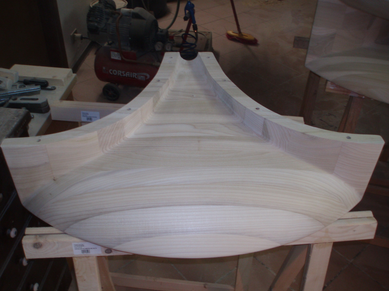

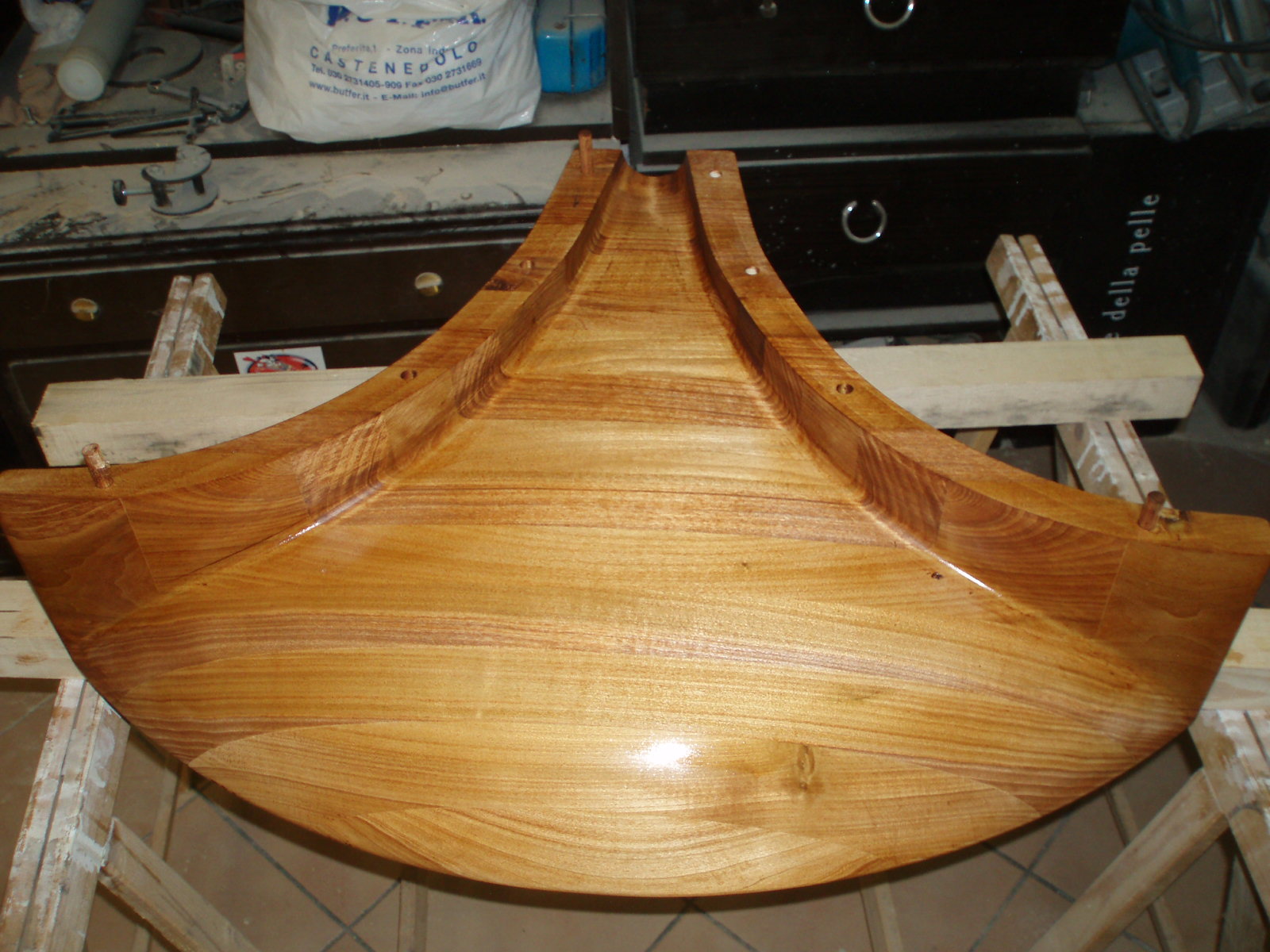

Marco,
Your horns are very nice. It is very good work with a lot of précision.
Congratulations.
Chritophe,
Congratulations.
Chritophe,
