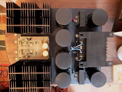

hahaha yes we are having a big party! Nice work! I am also planning on building mono blocks!
woohoo.. looks like Hiraga 30W builders are having a party here..
what i really like is each one of us have followed different approach towards building this monster!
mine is a monoblock build..

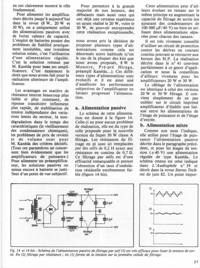

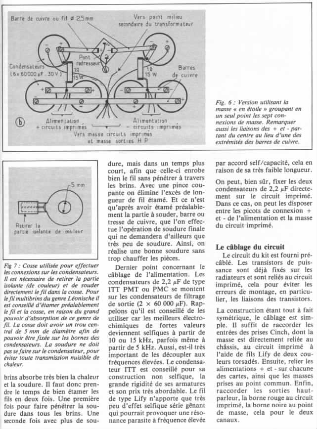

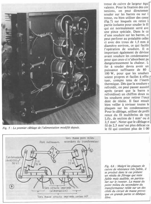

The drawing of the copper bar underneath the photo was later changed into the other drawing. The second one gives less noise just because the cable to the circuits departs from the centre of the bar and not from thje end where the cap is connected.
The picture is another design with the same chokes i used for my 30 watt.
In the small graphic near the power supply circuit drawing you can see the ripple without Rc, with RC and with LC.
If you get an R core just also ask for a static screen and multiple secundairy taps so you can easiliy adjust the output voltage to the circuit.
You can copy the design from the power supply in the attachment. Using other transformer 68000µF LL2733 and a pair of 100000µF or 220000µF caps.
I am not sure if double mono would be better? You will need to spend double the money. I think better get one 500VA R core and use more caps after the choke than spending 200 euros extra on chokes and an extra transformer.
Greetings, Eduard

I can't help feeling all the capacitance in the PSU is a bit OTT. What's wrong with regulation instead?
It is, but that's the point. I was around when this amp was in the works and the idea was to simply test if a massive PSU made any audible difference. It did. Some of this line of thought came from Japan and the Kaneda amps, which have some regulation, along with massive caps. If you think this is OTT, you should look up Hiraga's Le Monstre.
Nothing "wrong" with it, it just sounds different. Remember that you will be listening to that regulation, it's all part of the amp. Making the power supply with massive transformers and caps isn't efficient from a weight or space perspective, but it does work well sonically, and is easy to implement.
Sergiu gives all the documentation you'll need in his very thorough post.
