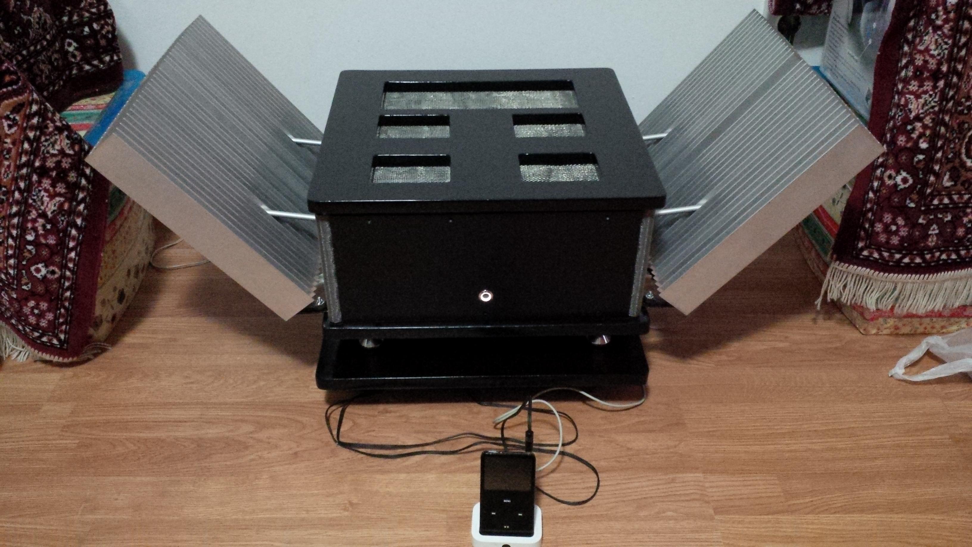

Hi VishalK
The second photo of Amplifier is mine. I would like to suggest you some points.
1. This amp really gets very very hot and it will need a massive heat sink, so do not compromise on heat sink. The Heat sink size of my amplifier is 205 mm Width x 117 mm Height x 82 mm fin length. This is size for each heat sink. I have used 4 of them (each for a transistor) and they also really get very hot.
2. I tested at least 4 different pairs of transistors and the most suited for my taste were
For Output Transistor : NJW0281G & NJW0302G
For Driver Transistor : 2SC4793 & 2SA1837
There was a great improvement in clarity of Vocals & Highs by using the above transistors. The vocals did not get mixed up with high frequencies. I would advise you to take a trial of these transistors also.
3. Try to avoid any ground loop during wiring or else there will be hum. Take care of the wiring during the assembly itself.
Enjoy your built journey.

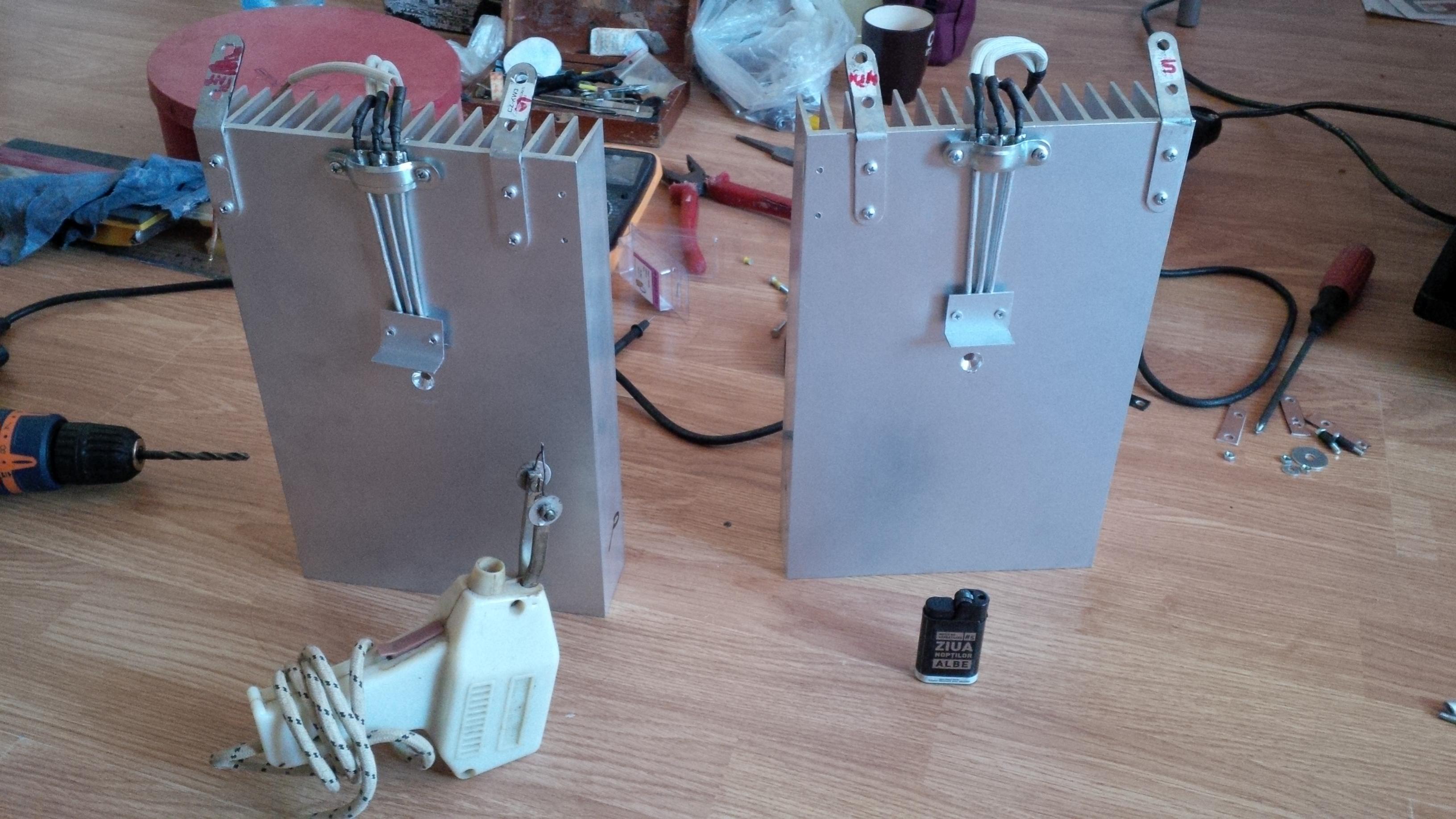

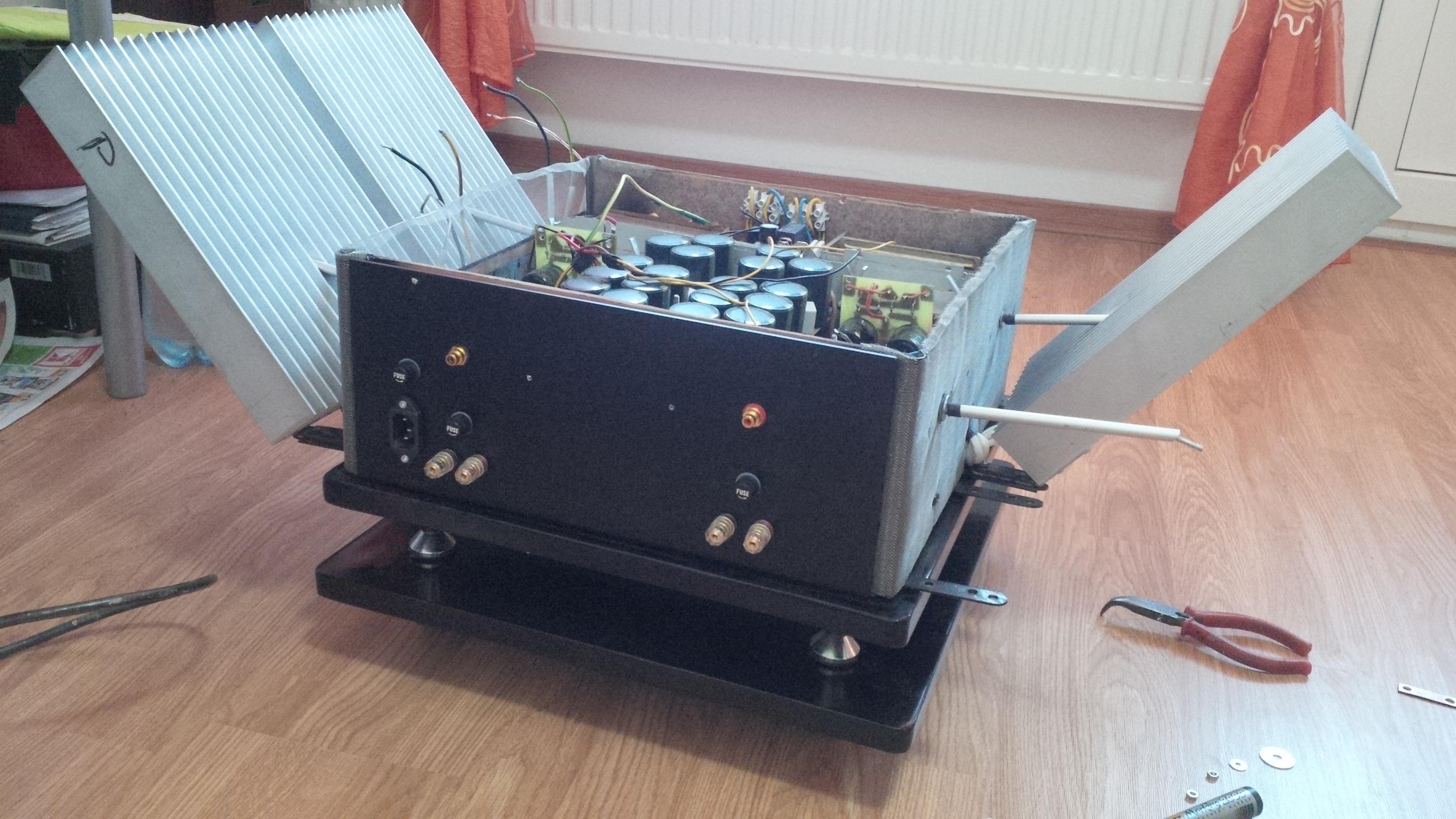

Vishalk, Sadik is right.. just take a look at my final rads used in the pics bellow.
Beware of the huge heat disipation Vishalk! 😎

A very nice Build Sadik, neat and tidy.
Don't Worry i will be using some heavy duty heatsinks, i've been told many times it is important.

Oh my word!!!! Looks like its going to fly! I'm making sure the heatsinks are more than suitable, i think ill provide each transistor with 2.5-3kg of extruded finned aluminium to be on the safe side.

Yup, they have almost 3kg each just for 38w, and do get pretty warm in the summer, that's why they are oriented at preciselly 45 degree angle (for the summer when the chimney effect diminishez) ... 🙂 imagine Dan's 58w version how warm can go 🙄.
