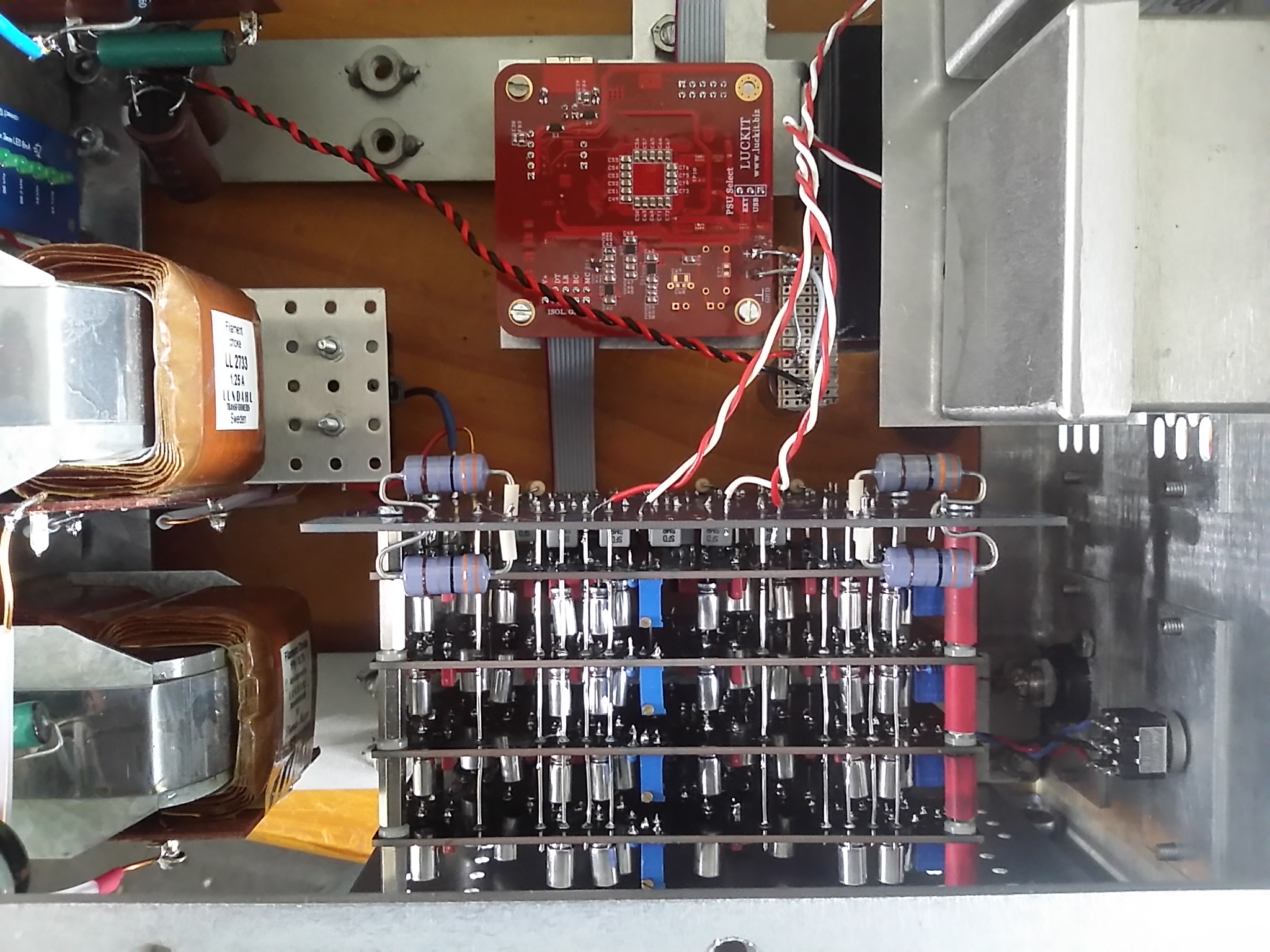

Hello,
I used the lundahl LL2733 in my dddac which has a single rail supply. So i could use one coil in the '' plus line '' and in the other coil in the return.
In the past the French did make a Kaneda ( Solstice ) preamp that also did use a choke with 2 coils. This device did a double rail power supply and they did use one coil in the + and the other coil in the -.
Some years ago i did ask Lundahl if that could be done with the LL2733 as well. They said sure if the load by the amp is symmetrical.
Anyone willing to try that?
In the near future i will use a pair of LL2733 in my mcintosch mc2505. There i cannot try it because i will keep the original power transformer and 1,7 ohm will give to much voltage drop.
I also wonder which connection will be the best 100mH 0,85 ohm or 400 mH 3,4 ohm.
You dont see many chokes in solid state power amps . Like i told before the one i used in my Hiraga was developped for another amp other ones were not available. Now Hammond does make a few but Lundahl is way better and has more mH and the right current rating.
Greetings, Eduard
P.s in the attachment you can see my dddac and how close the ll2733 can be mounted to the circuit. One of the chokes is used in choke input so will have a bigger field than normal

I sugest you find some soft recovery types and forget those industrial diode bridges with radiators..
Cheers
I think none of those diodes are that good for your aplication. Pano is saying that you may have higher switching noises induced in your capacitor bank, and if the grounding and wiring is not done well you can hear some noises other than music, coming out from your speakers...
Your diodes are 60eps(very low voltage drop) series and mine are 60epu (ultrafast soft recovery)series.
Look closely at your diodes:
https://www.google.ro/url?sa=t&sour...MgIiPW72mnZNGQrQA&sig2=aNnWU7l895s_e9h1s8klgw
And mine:
https://www.google.ro/url?sa=t&sour...Bqu2Yx9Vodj55ehQg&sig2=VIbaoHwl6CXWRIo99CBlRw
Cheers
Or instead of a single expensive r core you could buy two well made custom EI's. You should know that when i tested both channels on a single trafo i got less spatiality and depth of field and 3d imaging than with two separated psu's (one for each channel). Dont get me wrong, with just one trafo the voice had presence, effects and all the finess but if you want a "be there effect" and the singer singing at 1m in front of you and catch every breath and wisper clearly and pick up each and every instrument with accuracy from the stage go dual mono like Sadik or dual mono in the same case like mine. You wont regret the extra money.
If i were to build this amp again from scratch i will go dual mono again.
Ps: i think that the single Hiraga with fuses on the rails and fuses on trafos and outputs is mine. The amp has no prob with this, neither the music..
Hello,
If i would build it again i would use an R core which will give two secundairy windings that are identical because R core has two identical parts. Cannot make that with EI core.
If i would build it again i would make it with a choke input power supply. A bit difficult to get right because you need a transformer with higher output voltage. You need to create a minimum load through a resistor to assure that there is alkways a minimum current flow through the choke.
I did use the dc protection developped by the people in Paris. It was fed by the 24 volts of the output stage. I also did use a resistor and a switch to lower the 24 volts as a kind of standby. Caps were always charged with around 10? volts. The amp would run verry low on energy. When listening just had to toggle that switch.
In France one seldom sees double mono Hiraga construction. I think one big power supply is better than two smaller.
Greetings, Eduard
Greetings, Eduard
