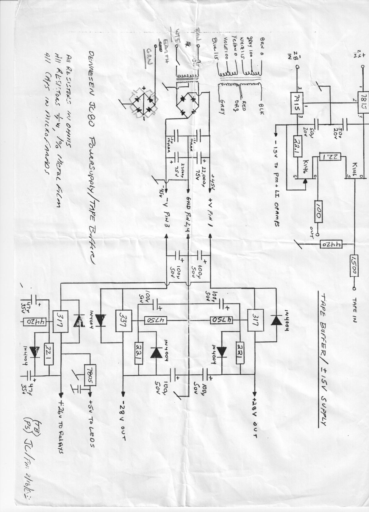

I was actually thinking of removing the onboard reg and cap multiplier and supply with a Jung regulator.

If LM317 / 337 regulator cap multiplier PSU Is used and approved with years It Is well done and LM317 337 are not so bad
I wonder If I can use same tip - add a cap multiplier to LM317 / 337 only based dac PSU

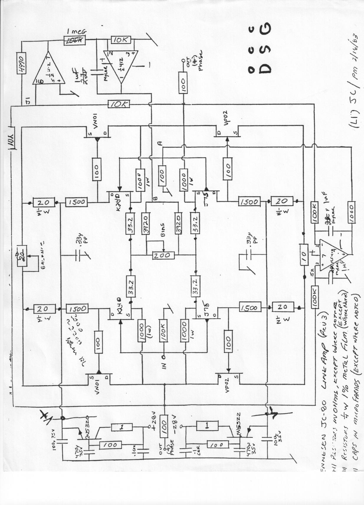

Chris, where would you take the AC measurement for the impedance change? At the amplifier's line input/R2R shunt ladder output?
The theory (to be tested) is that the volume control (assumed to be at the front of the signal chain) and the active electronics' input (assumed to be next in the signal chain) form a voltage divider. If both channels' impedances are the same, they'll have the same voltage at the junction of volume control and active electronics for both channels.

What type of signal would you pass into the amp to test? Regular music or test signal of some sort?

1Khz sine wave as signal any good for testing?
Nowhere near enough 😉
100hz, 1khz and 20khz thd + 19-20khz IMD tests will do good 🙂
It just depends: If you have a good 1K source and a way of seeing individual harmonics, you can do well enough. I personally use a 5K source for most of my testing.
This is not true for ALL circuitry, but for the JC-80, this is OK.

Yes of course.

Many thanks John.
BTW excellent hand writing and technical drawings.
Best regards,
Patrick
Best regards,
Patrick
Would you care to comment on the use of VN01 / VP02, compared to the well-known Toshiba or Hitachi TO220 devices, or even TO92 devices ?
