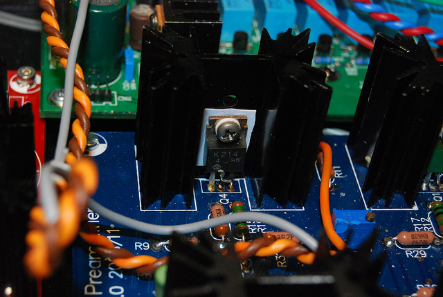

Hi Ignacio, I used lateral Mos at the output and set the BIas an order of magnitude higher than that. Can't remember the figure exactly but it was like 250-300 mA. I followed John's description and schematic as much as possible but I had matched 2SJ79/2SK216, that are closer to original devices. Anyway I guess starving them so much (20 mA) won't lead to the same sonic performance. Must be tested to hear ...

Cannot edit anymore but the output devices are 2SK214 and 2SJ77 ( a lower voltage variant of K216/J79). They have different pinouts compared to verticals, and it can be seen in the picture that I have switched D with S, to match the PCB.
Still, even with verticals, I would not go lower than 100mA. So if I were you, I would leave room to experiment higher bias settings for the output.

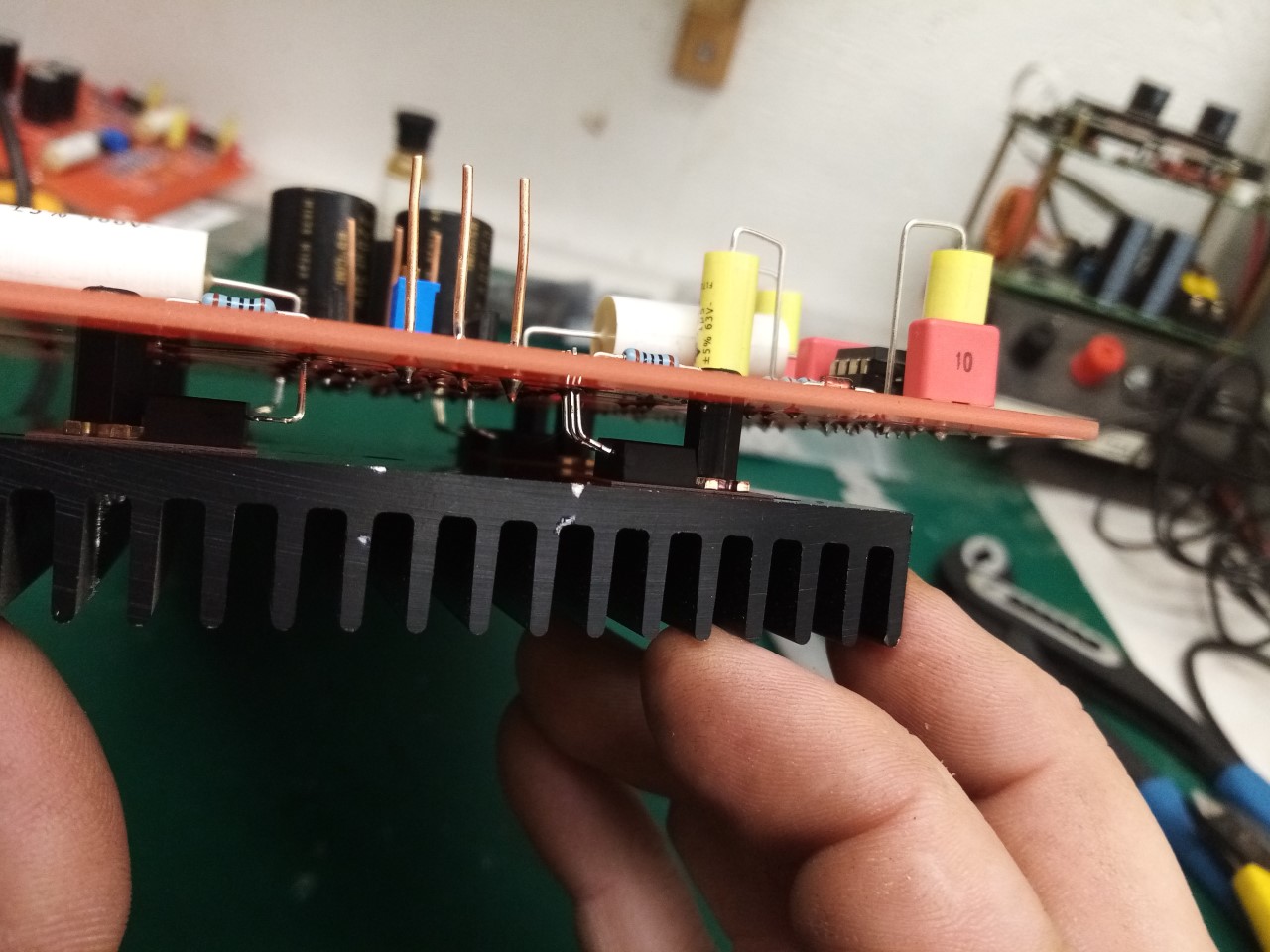

How did you guys solve cooling the new boards? I am a bit worried they'll end up too hot if I run them for long.
Here's how I ended up doing it. I had a big old heatsink laying around.
Drilled and threaded it, pinned fets down with stand-offs. Screws through the board. It was a pain in the rear to align all 18 pins at once, but doable.
