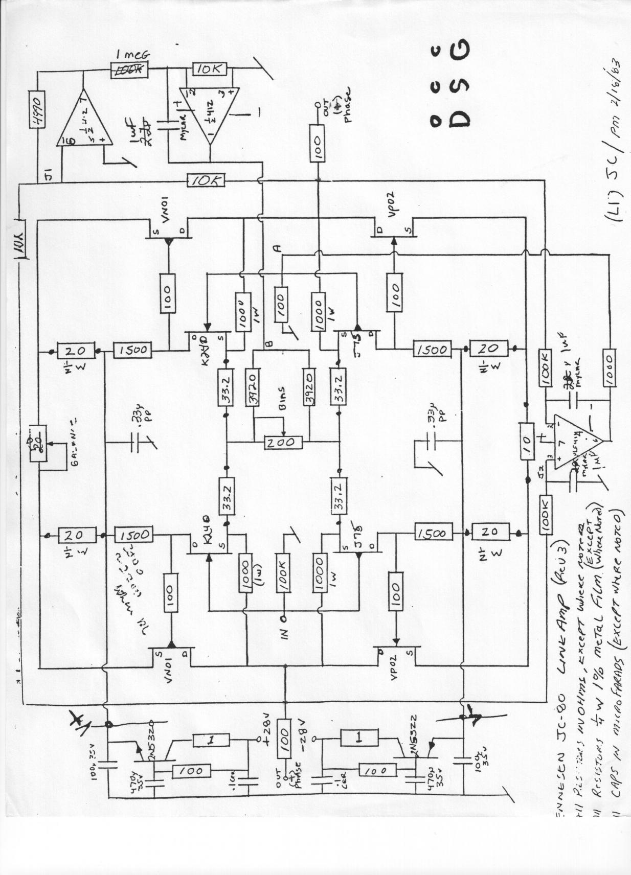

JC-80 balanced input
Earlier in the thread the topic balanced input was briefly touched, without any other conclusion that Jim's PCB although prepared for balanced input was not really suited. I am aware of the fact that the 411 servo opamp fingers the negative input. The JC-80 could possibly has performed as a nice clean balanced in/balance out preamplifier without the actual DC servo regime. It would have required a very precise (four-gang) volume attenuator of course.
The reason for bringing this up [again] is all these nice DAC boxes with balanced outputs.
One could maybe buffer the negative input with a complementary JFET follower - ML-2/"Beast with a Thousand JFETs"-concept.
John Curls old drawing (by Peter Madnick) for reference:

You don't need an impossible to buy 0.1% matched 4 gang potentiometer.
Read Bruno Putzeys' article (it's linked a few times in this Forum) on balanced volume control.
It converts the balanced impedance signal to unbalanced, applies the normal stereo vol pot and then converts back to balanced impedance output.
Yes, AndrewT, thank you for steering me back on a sensible route. I got a little lost here, and also forgot Albert Einstein who said "Make things as simple as possible, but no simpler".
Four-gang potentiometers will not be good enough, and ditto stepped attenuators is to expensive etc (in my opinion). I forgot that, I must admit.
In my opinion a good balanced system must have proper instrumentation amplifiers on the inputs. One should not just route the positive and negative signals through (four-gang) potentiometers and separate amplifier stages. But fully implementing an instrumentation amplifier violates the simplicity of the original design - that is where I got lost last night.
