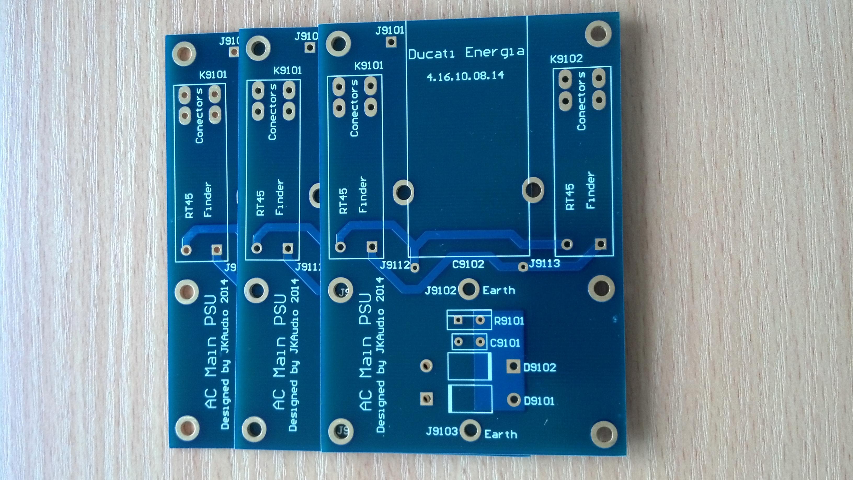

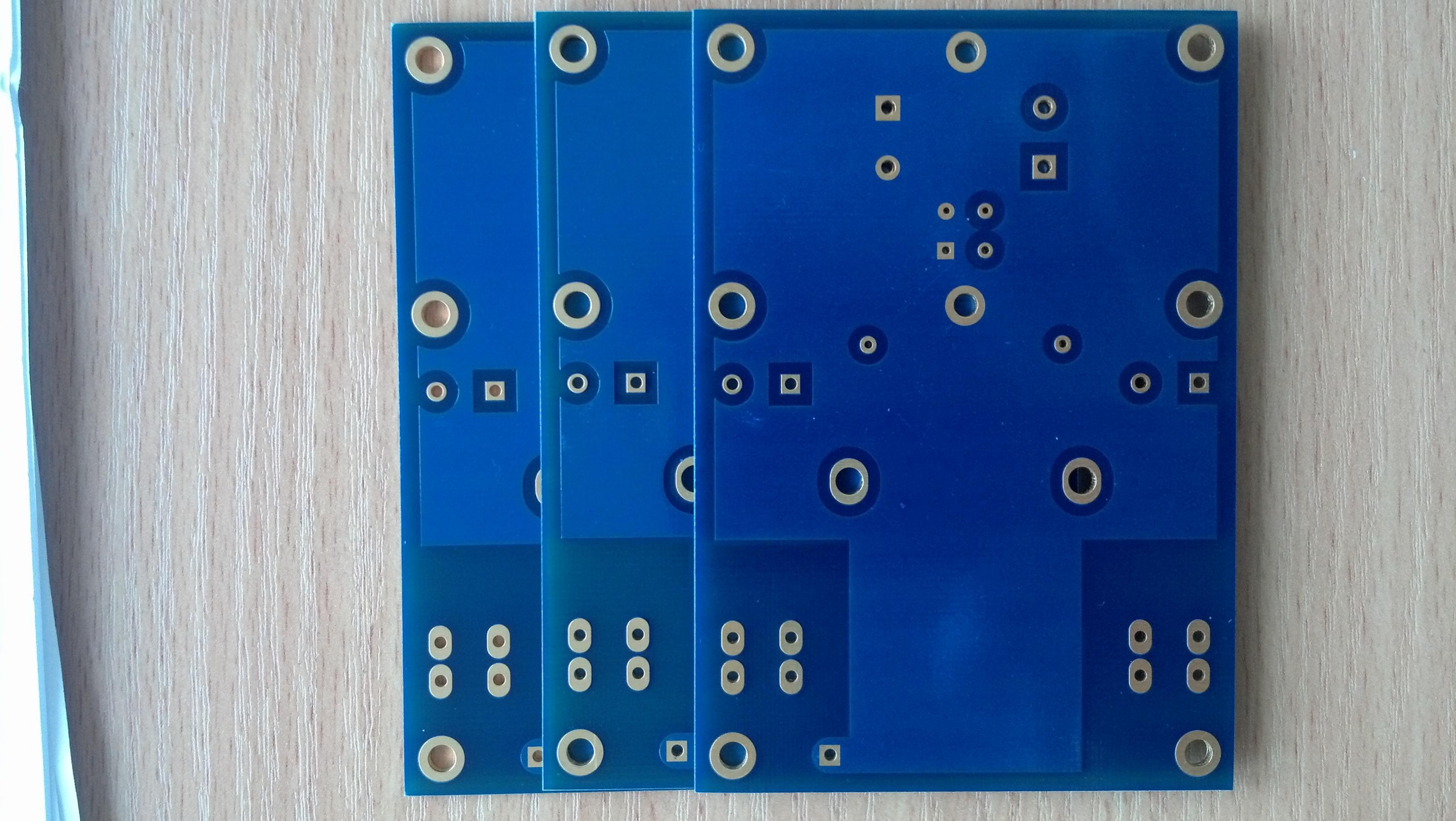

Nice work JKoch,
I just saw your company's web site, now I can see how you're so good at PCB designs! 😀

Thank you for your admiration of my job. I am not such specialist as you think. Did you see my company's web site? I have my private web site only. Maybe you find not my site but other one?

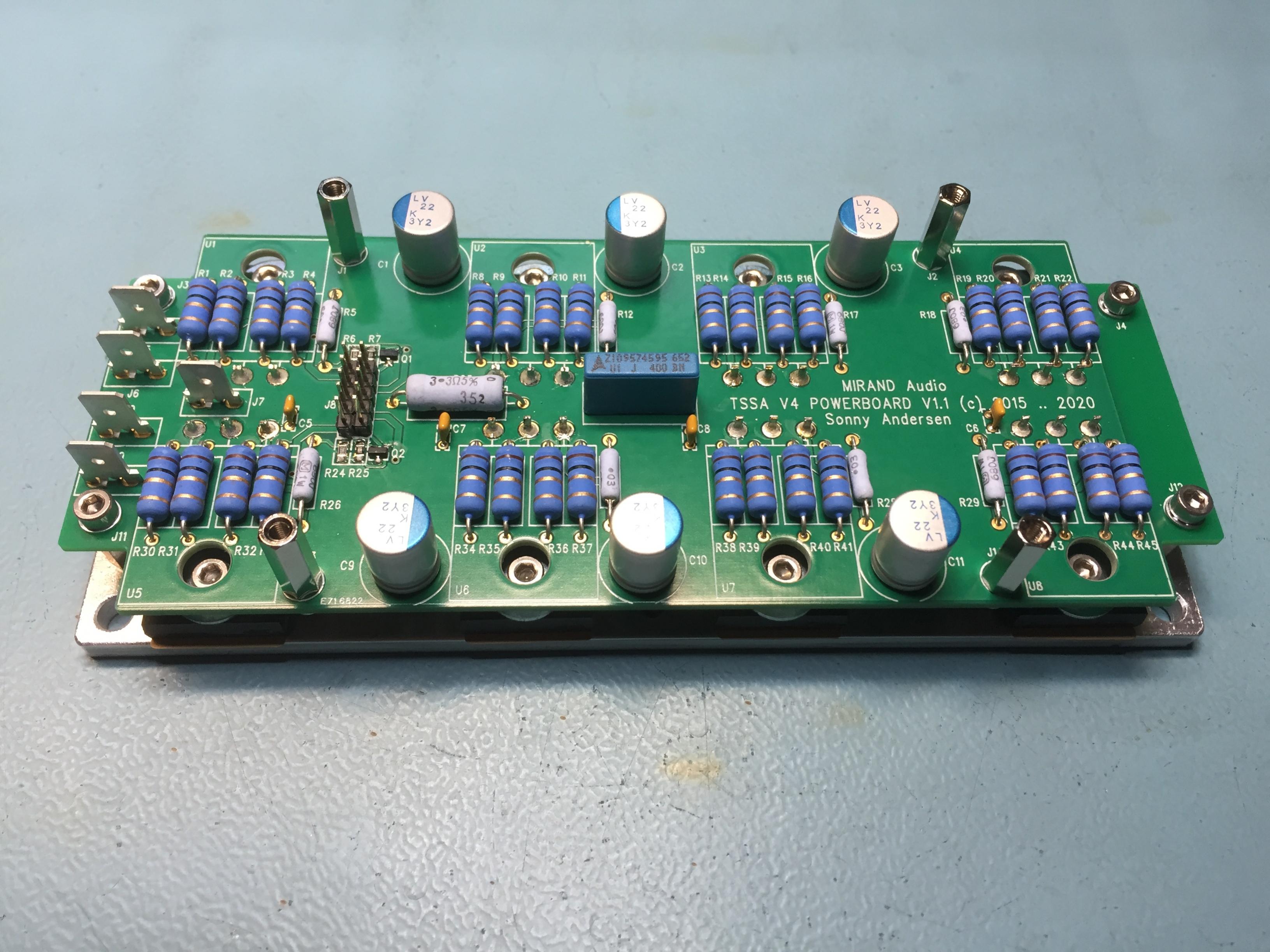

Hi Rønningstad,
It is an interesting new layout as metallicus69 is pointing out! They would be mounted under the board and the hole should be big enough to pass a screw and plastic isolator washer. I would put the board flush against the surface where it will officially be, take a marker through the screw holes to mark the screw hole positions then drill and tap. You will then have to bend the legs of the transistors to the upright position to go back on the PCB. I would do one or two transistors at a time, solder, unscrew and then do the next ones.
Here's some examples
Don't install this on a 1-2mm thick aluminum, it will get too hot once biased.
Let me know how this new JC-80 performs!
Ciao!
Do

when the screw is tightened the transistor tends to turn and strains the leadouts and solder joints.
It is extremely difficult due to the transistor being under the PCB to hold it and prevent this turning as you tighten down.
Instead if you place a thin, maybe 1mm washer plate across all 4 devices and insert temporary screws in the open holes, then tighten the screw down on the installed devices. You get a straight down clamping action and the washer plate acts as the washer shown in the pic.
