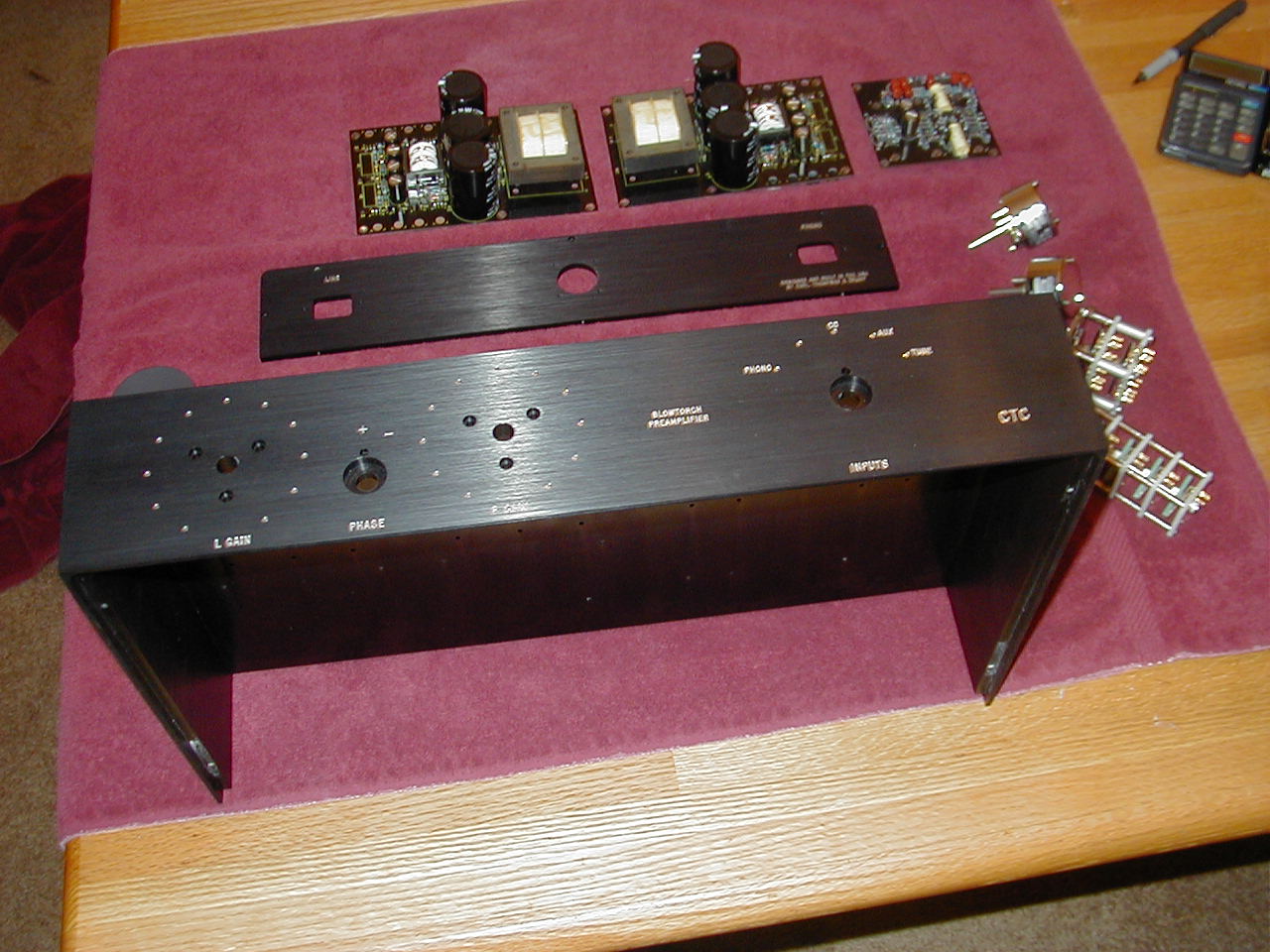

The Blowtorch power supply choke is a common mode choke in both the DC positive and DC negative lines. The center tap choke (1 to 3 mh) not needed in the Blowtorch keeps HF noise out of the ground, but dual bridges eliminates /reduces it even more. There are dual bridges in the Blowtorch supply for each channel.

Thanks for detail. Look on my schematic. I use two bridges and one common mode choke and next series resistors in each rails. Next are two el-caps with common ground. And one el-cap is connected between both rails before choke.

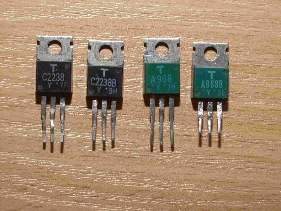

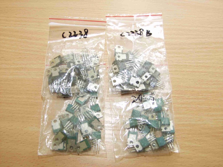

I have bought Hitachi 2SK216/2SJ79 on ebay:
1pair or 2pcs Transistor Hitachi to 220 2SJ79 2SK216 J79 K216 | eBay
I hope they are genuine Hitachi. Building clone Krell KSA50Mk2 I was finding Toshiba 2SC2238-Y/2SA968B-Y. I examined and checked many pictures and offers from: electronic distributors, ebay and Chinese alibaba sellers. All of them offered 2SC2238-Y/2SA968B-Y in black TO-220 case. But original Toshiba P-channel/PNP TO-220 transistors were encapsulated in green case. Only used Toshiba/Hitachi transistors have green colour from Chinese sellers. All new 2SA968B were black. They are fake, I am sure. Finally I bought about 20 pairs of used 2SC2238-Y/2SA968B-Y. All were matched with success. Well I am sure they are genuine original Toshiba transistors. Similar situation concern Hitachi 2SK216/2SJ79. All new this type transistors offered on ebay and alibaba are in black cases. But they were encapsulated by Hitachi in black and green cases, so I hope the above ebay seller have original Hitachi transistors. I afraid if he will send me the same transistors as showed on ebay picture. I made special notice sending money that I interested in original black and greed transistors only. After I will receive them I let you know my opinion about the transistors (and the seller).
