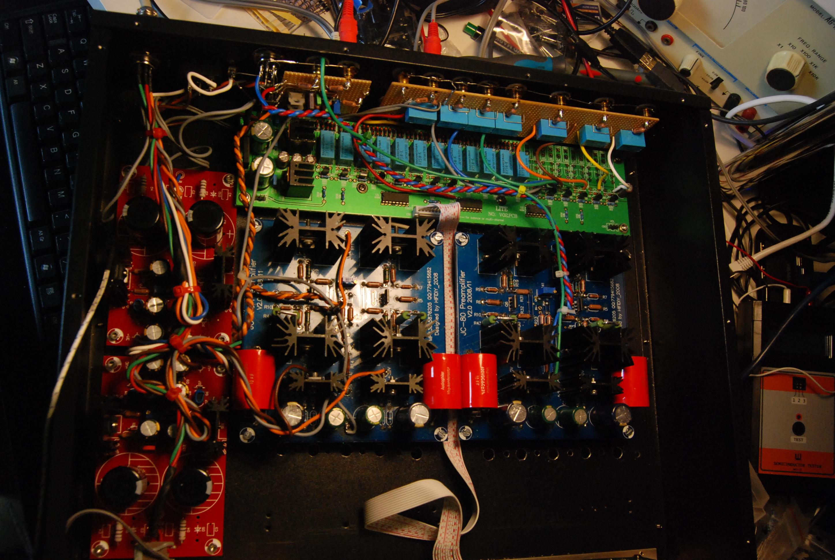

i have the transformers, rectifiers and first stage of filtering in a separate box. A special cable is built to carry Two differential sets of voltages and the control voltage. i have the second set of filter caps in the main box, followed by Kubota regulators and then one ebay kit board per channel.

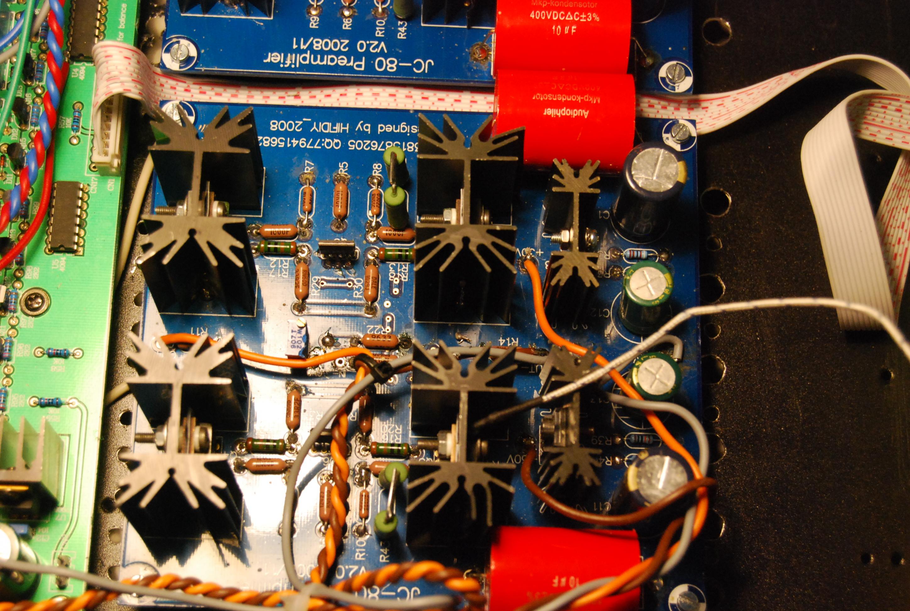

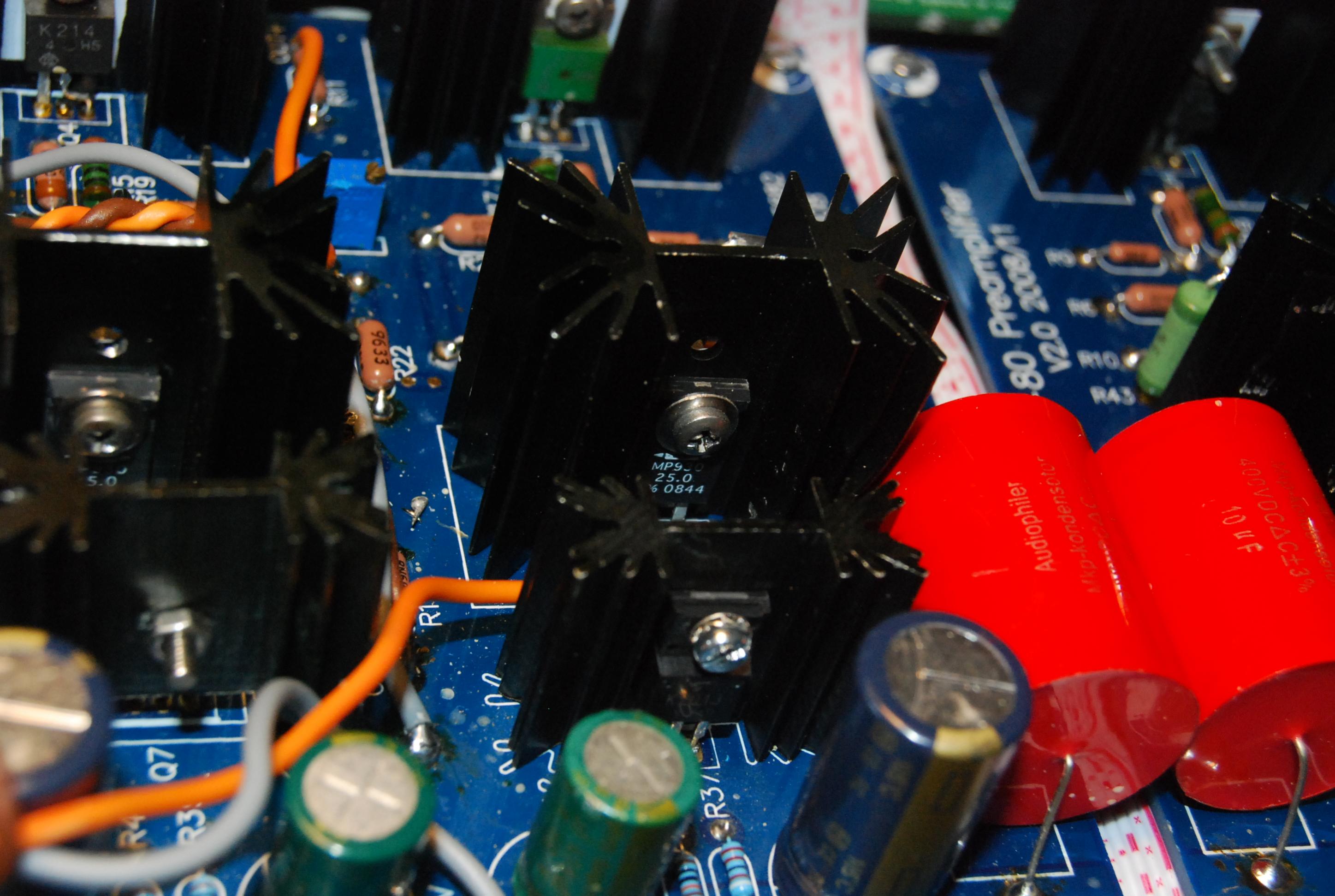

Active devices are 10mA Idss dual fets (2SJ109, 2SK389) followed by matched pairs of 2SK214/2SJ77 in the output stage. The cap multipliers and the active devices in the Kubota regulators are matched 2SJ313/2SK2013.
Everything runs quite hot, but bearable. The case is huge and vented and it seems to have enough passive cooling power.

Well, it's delightful! After one more day it really shows itself like a great preamp! Maybe the idea of cascoding through us into the blowtorch area, but I think it's just fabulous.
Anyway, JKoch, if you will design the whole thing again, please use the case as a heatsink, for devices sake. You will have a great preamp even in the original state, if you have Toshiba's and Hitachi's in original format. Probably you can get better results with cascoding the Hitachi's and using VN's, but this is a new experimental field, if you dare to approach 🙂 I didn't as I had the PCB and no VN's, but even this way is a success!

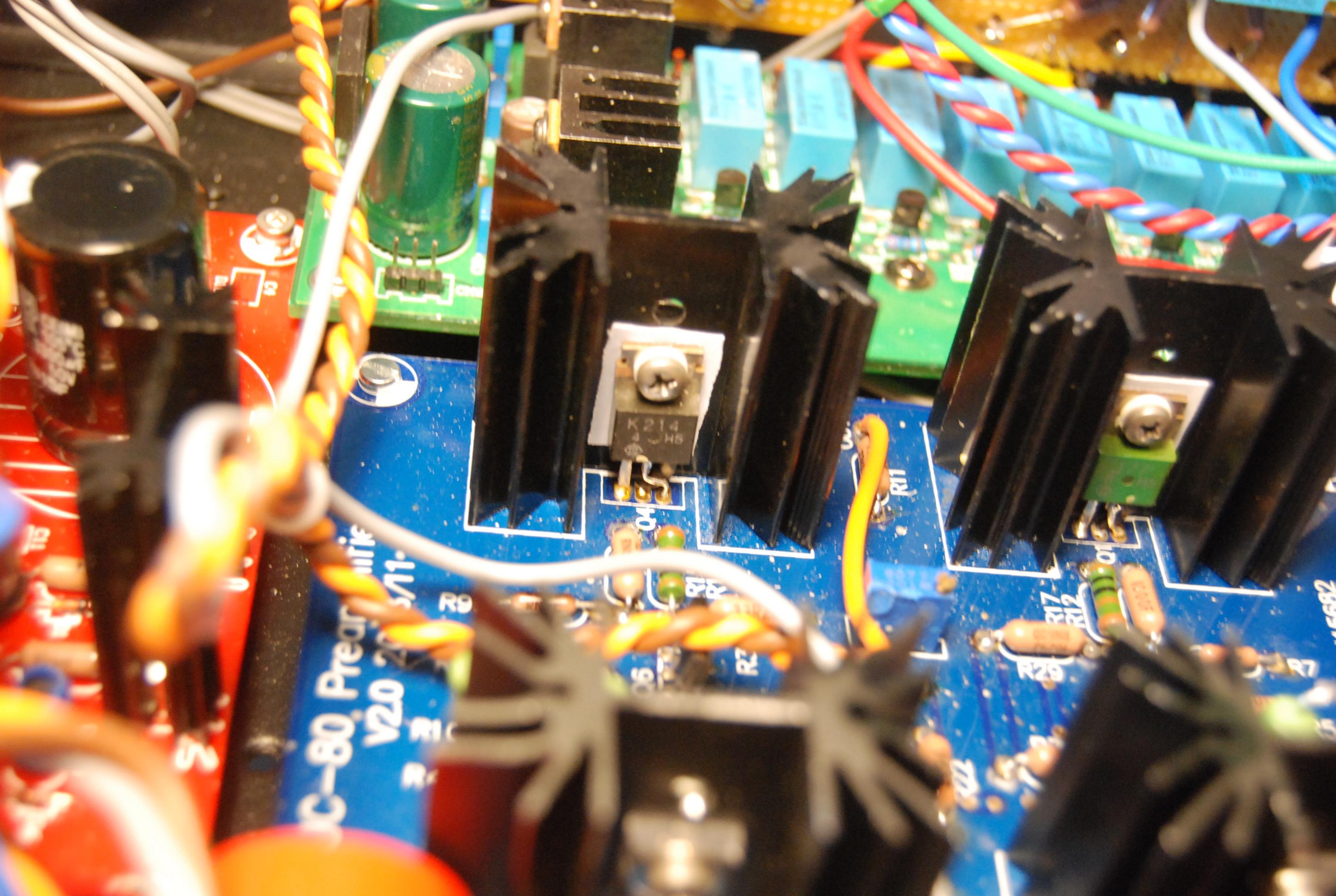

It's not a joke with thermal dissipation!! Two 2SK2013 just went to Valhalla after few days of continuous running. I had to reopen the case and drill some holes around the JC80 PCBs. i reduced also the Ids through the final MOSFETs to 80 mA (which is the lower limit regarding symmetrical voltages and also considering the sound). I measured the temperature after replacing the dead MOSFETS through the vents in the upper side of the case, just at the 2SK214 case, and after 2 hours, the temperature is 63 degrees Celsius, which I guess will be safe. Probably I can raise the Ids with few mA, but the sound is the same as with 100mA, and I would not take any chance to increase it further.

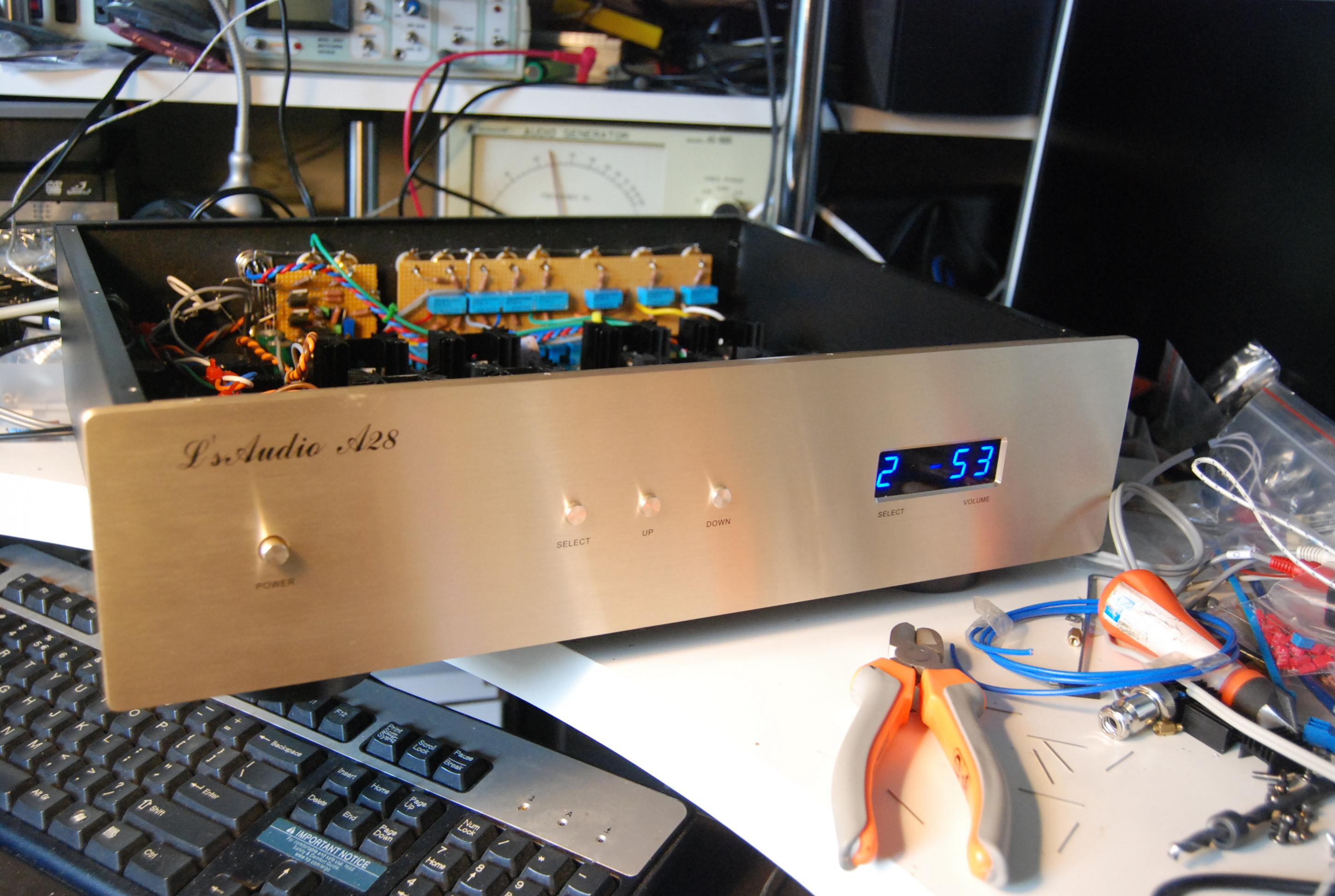

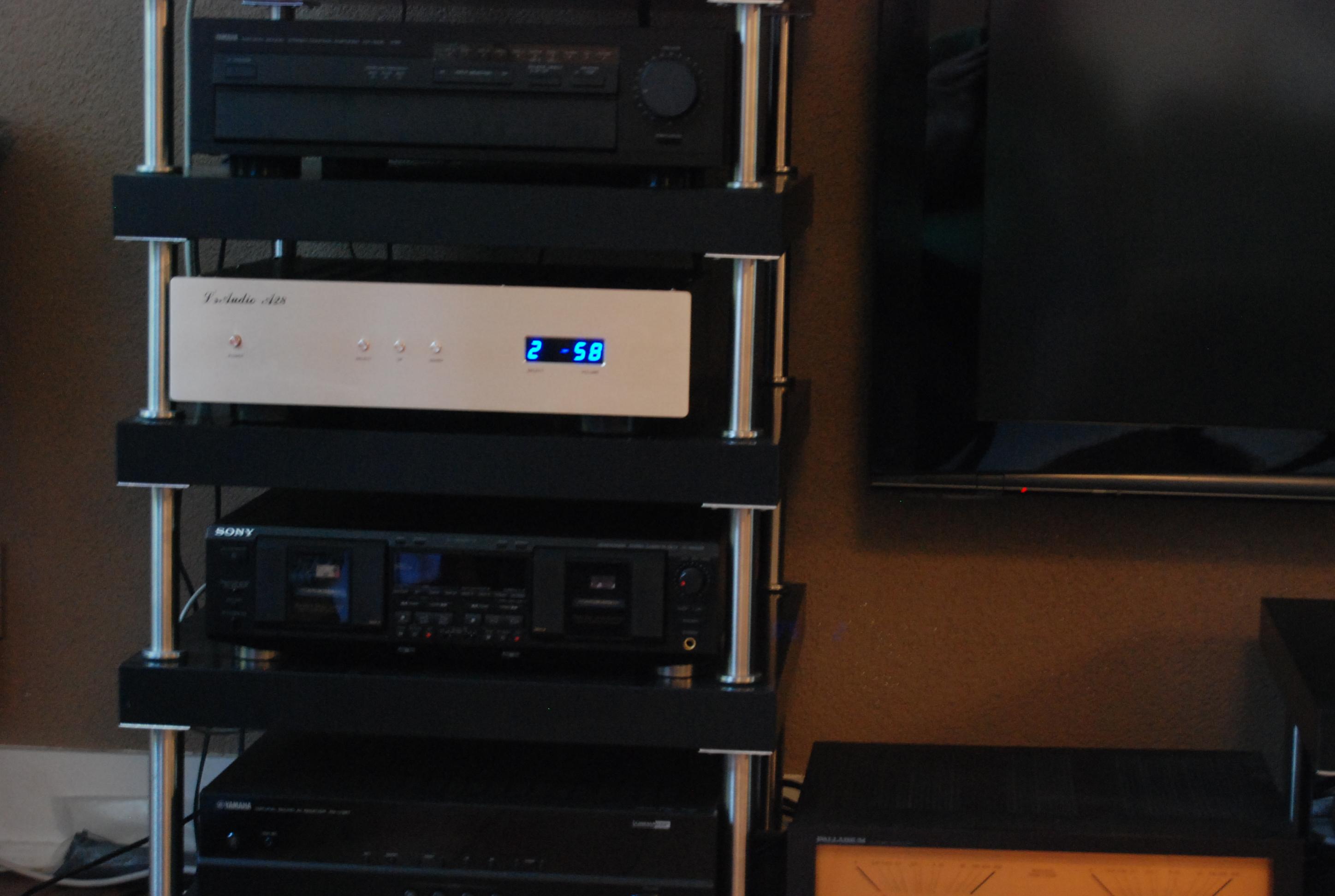

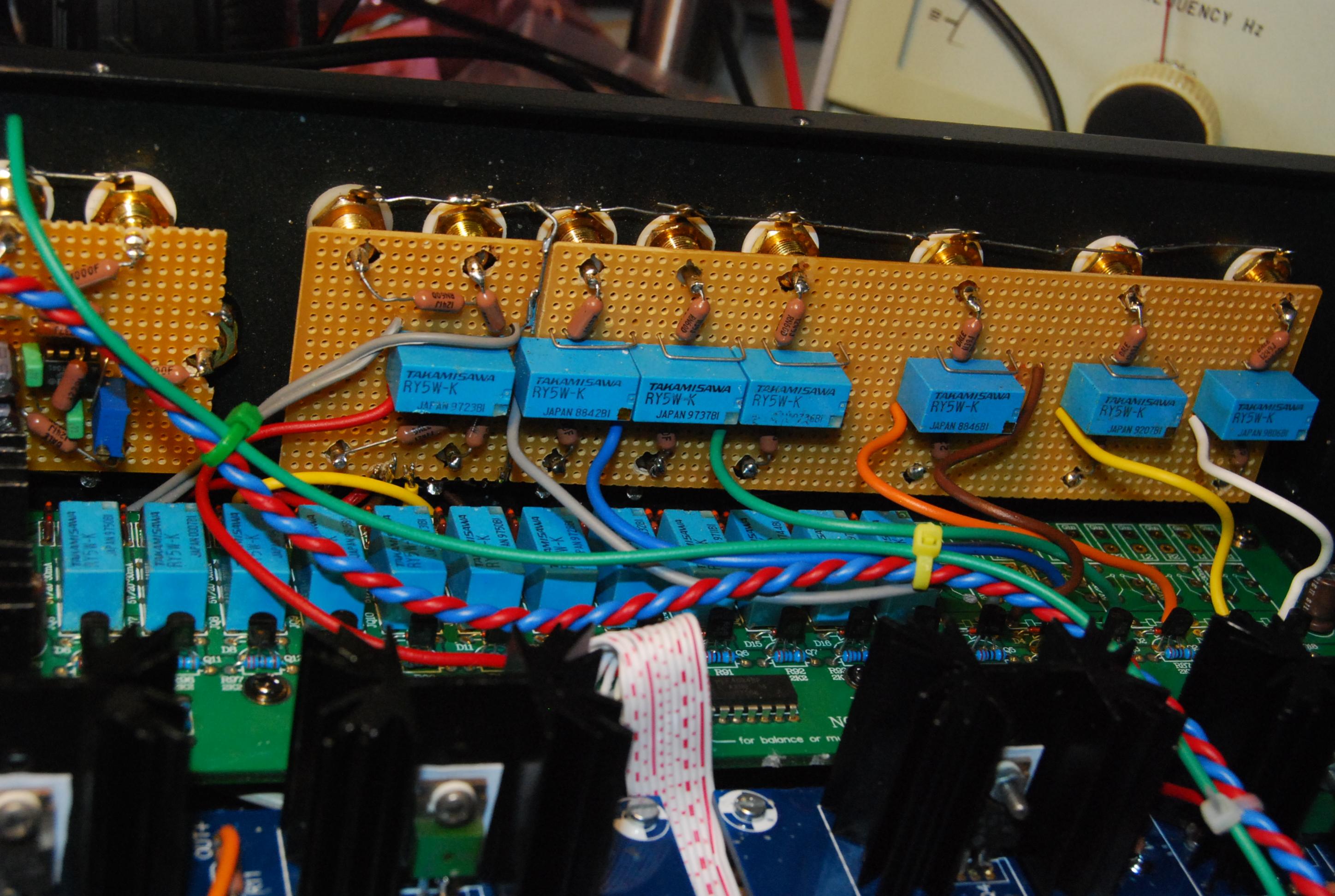

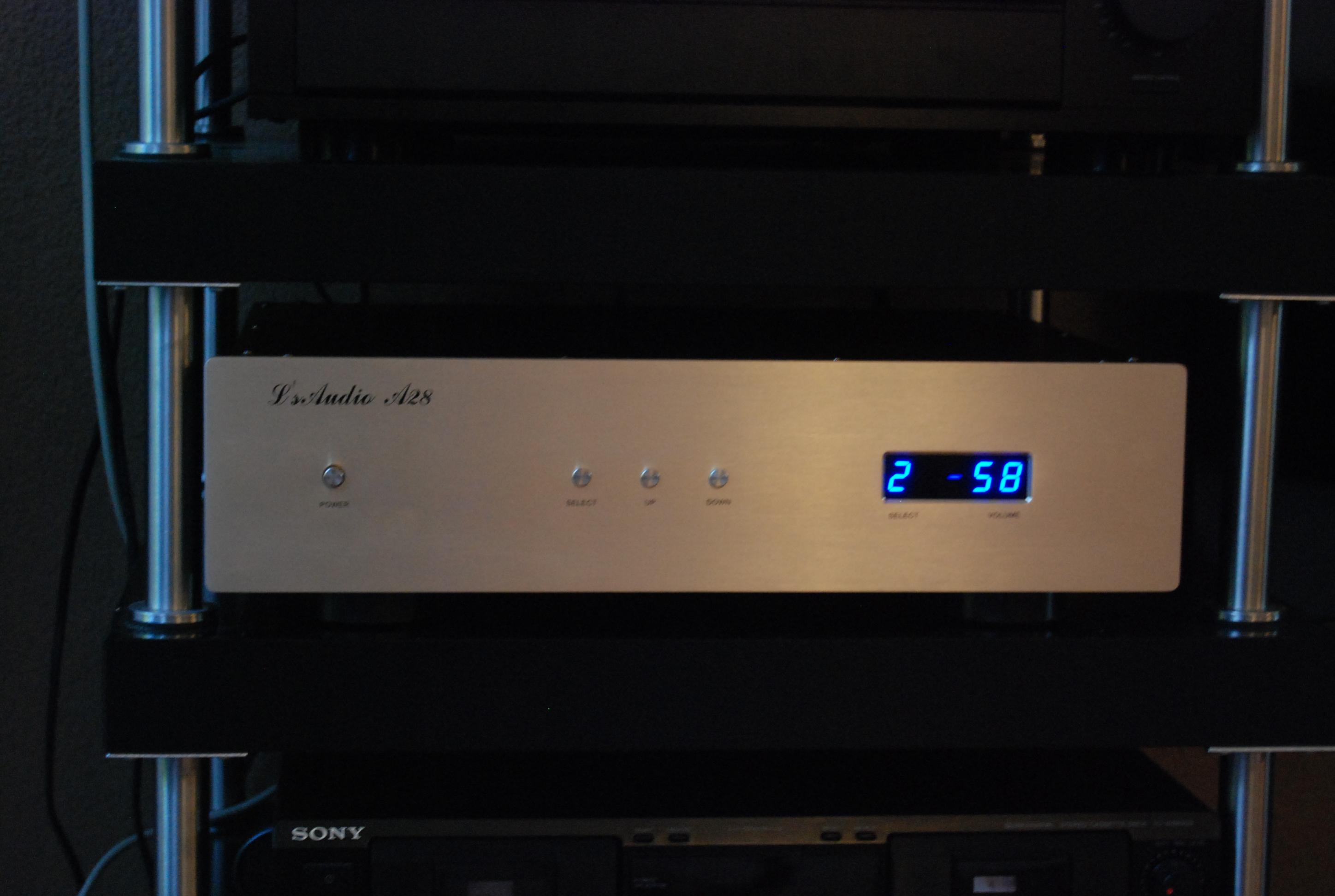

As some people asked me in PM's to take some pictures of my build, I did it now. Please check the attachments.
The blue pcbs are JC80 line amps, the red ones are Kubota regulators and the green one is the relay based atternuator. I moved the relays for source selection on a test board because the original has the unused inputs left open, while I wanted to have them connected to ground. Also, the power button of the case it's used now as a "Tape Monitor". You can also see the preamp integrated in my home-built audio furniture that's using cheap IKEA parts 🙂

Hi metallicus69,
Very nice work!
Very happy you like it. I am very satified of mine as well. I use the AMB Delta 1 and Delta 2 for source selector and volume control.
Hope more will join and try this build, it is really worth the efforts!

Thanks Do!
I used the attenuator from diygene.com which matches the case from audiophonics. There is no way I can build such cases with my home equipment so I prefer ready-made solutions.
I also hope more will join, but that is why I posted details and my notes about thermal issues. This really should me regarded as a small power amp rather than a preamp when considering power dissipation of the devices.

Hi metallicus69
Great work. The simple preamplifier looks very complicated. You packaged many circuits in this case. It looks very nice. Congratulations!
Thanks JKoch! There are not too many circuits;JC-80 (one for each channel) Kubota regulators (one for each channel) - these are the heat sources 😀 - one relay based attenuator (unfortunately not dual mono) with relay based source selection and the control module for this, mounted behind the front plate, that provides also the convenience of remote control.
What I also did was moving the selection of sources relays near the inputs and modifying the switching circuit to ground every unused input. Probably an overkill, but in my opinion this is the way input selection should be done.
All the primary sources (+/-40V for each Kubota and +15V for the atenuators) are located in a separate box to be able to cope with the space and electromagnetic field issues. It could not be any simpler considering my goals (remote control for example).

Hi JKoch,
On each MOSFET there is a source resistor, original 20Ohms, In my case still an acceptable 25 Ohm. You measure the voltage drop over it while adjusting the 200Ohms BIAS trimmer and apply the OHM's law. 2,5v/25Ohms = 100mA for example. If you correctly match the transistors and passive components, you will see very close values in all 4 source resistors. In my case I have 80mA and works like a charm. If you go higher it's better, as long as the heat has a way to run out 😀 😀. No need to go higher than 200mA I suppose. 70mA was too low in my circuit.

If something is not terribly wrong you should read same voltage values on N Bias and P Bias on the same branch. So voltage between NBias1L and V- should be equal to voltage between PBias1L and V+. Of course there are also the 10Ohm resistors between sides, (R6120 and P6101) but in case of good matching the currents flown through them are negligible compared to the main currents.
