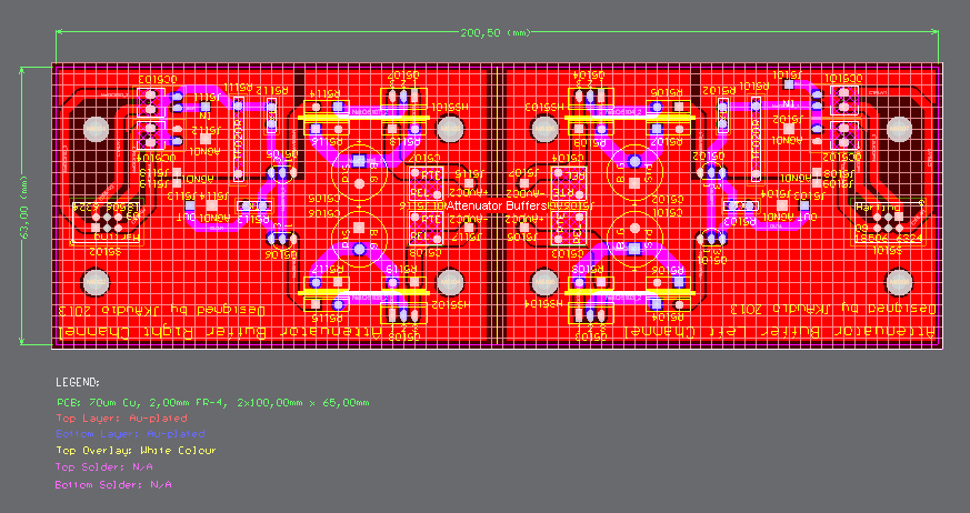

The pcb is designed for transistors: Toshiba 2SK389/2SJ109 and Hitachi 2SK214/2SJ77. I have completed all these transistors yet. So footprints are adequate for above transistors only. I know that purchase such old transistors is very difficult but not impossible. The pcb was designed for my project of preamplifier exclusively, not as an universal kit. Dimensions of pcb and placement of sockets and heat-sinks are suited to project of my preamplifier's housing.
I made some improvements of previous design: all power and output signal traces are wider (3-5mm), ground plane is on top layer (power plane) only, under (bottom layer) the PSU section and Power Section have ground plane but not connected to ground plane on top layer (AGND1-L, AGND1-R). Both bottom ground planes are connected to GND-Case's vias to connect them directly with housing star ground point) - it will be working as a shield under PSU section and Power Section. I hope it is suitable idea.
First I thought to use teflon as the board material but I gave the teflon pcb up (to costly and low mechanical durability). So finally the pcb will have features as follow:
1. material of the pcb: 2mm thick FR-4
2. double copper layers 70um each
3. both layers are gold plated
4. lack of solder-mask on top and bottom layers (gold plated layer are resistant to any oxidation and need not solder-mask)
5. the pcb will be screwed to 5mm thick teflon plate under the pcb
5. the pcb has 19 holes to fit with teflon plate + 6 holes to fit with both heat-sinks + 2 holes to fit shield of Power Section, so finally the pcb will be very rigid and resistant to any vibrations.
The pcb is finished but during few next days I will be looking at the pcb to find any errors or to make some improvements else.

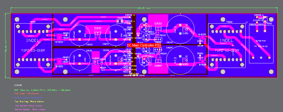

Here is a next pcb design: DC Main Controller PSU. The module contains four regulators +5V, +12V and +/-19V to supply uController, relays and driver of attenuator.

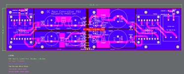

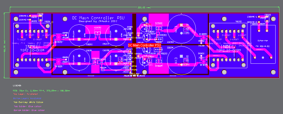

Improved pcb of DC Main Controller PSU adapted to 230VAC and 115VAC.
Very Nice JKoch,
Have you tried designing a regulator based on the TI TPS7A4700? Supposed to be real quiet supply.
Ciao!
Do
The TI TPS7A4700 is quiet (4,17uV output voltage noise) but it is housing in VQFN package only. I need not such quiet regulator in this place and the TI TPS76750QD has fixed 5V, so is simpler to use (one resistor only). The regulator will be supplied 2 x PIC uControllers and 2 x LED displays.
