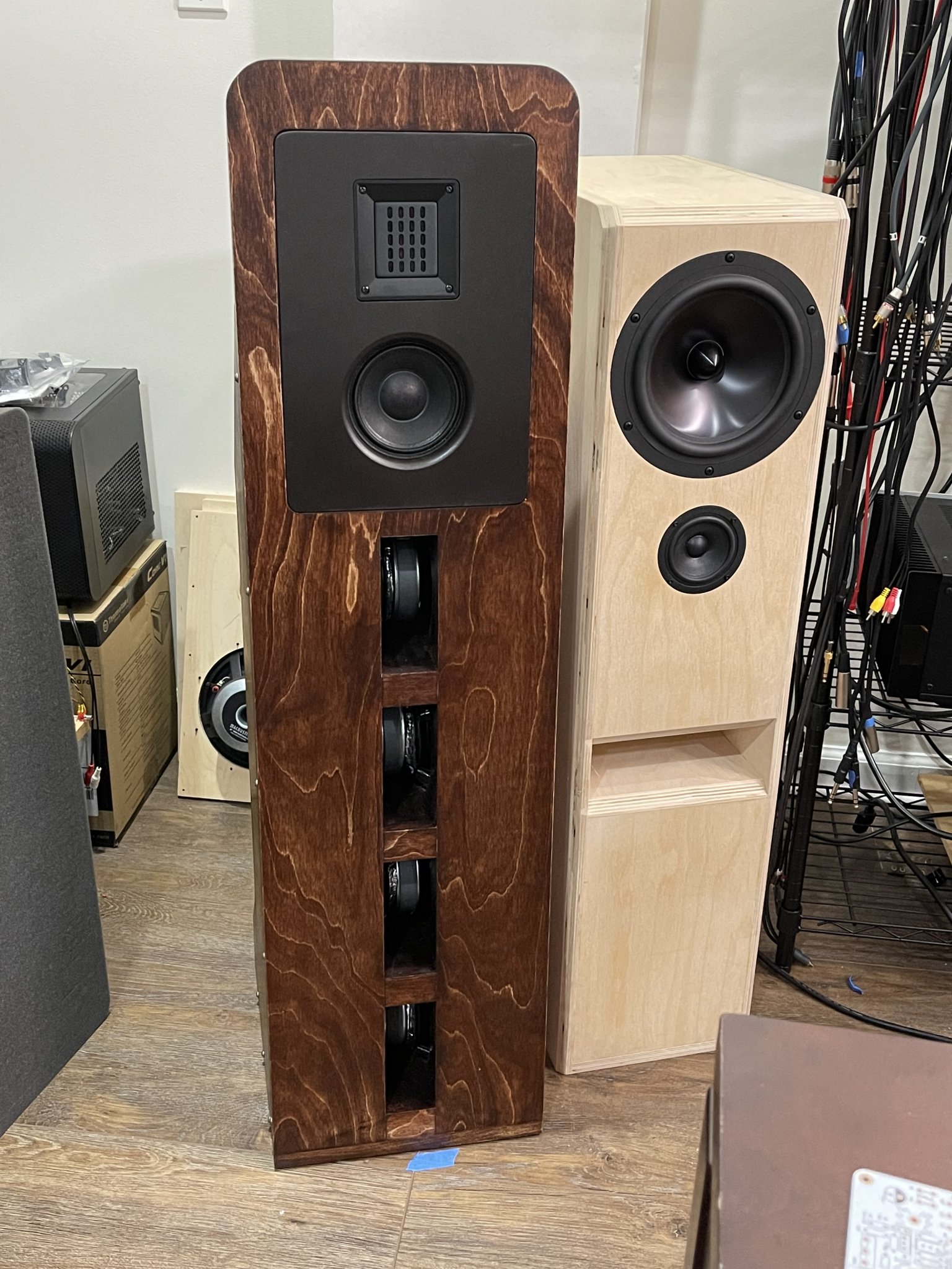

If you notice a difference in engagement and soundstage and imaging with Aleph, you are starting to see what I mean. There are even better amps and better speaker combinations of course that will be even more amazing. My recent XSD speaker is 91.5dB sensitive and has huge headroom as it uses 8x 6.5in woofers, a PA rated midrange and a thin light planar tweeter above 4500Hz. The soundstage on that plus the level of engagement and visceral bass slam is crazy. It likes low impedance amps SS Class AB amps or Class D. However, some SS SE Class A amps have great damping factor (like Alpha Nirvana).
Ironically, this speaker addresses a bunch of issues I'm having with the 530s:
When I measured the 530s in my office, there's a peak of about 10dB at 119Hz! I think what's happening is that sound is radiating into the floor and the ceiling, reflecting, then coming back in-phase at 119Hz.
Simultaneously, there's a dip at 60Hz. Basically the same issue, but manifesting itself as a null, an octave lower.
The floors of my house are laminate on top of concrete, so the surfaces are really speculative.

The 4 port “line array” of dipole woofers seems to have less sensitivity to floor bounce nulls or room mode nulls. The bass is much more uniform as you move throughout the room unlike monopole woofers. I think that’s the one thing about dipole bass is that there are fewer room modes.
same PC? You mean the black cube chassis or the silver HP laptop? The black cube I am actually using as a chassis for a 50W fan cooled single ended Class A amp called the Glass Harmony by Hugh Dean. It uses CPU coolers and the like to dissipate about 150W of heat, so a perfect fit.
