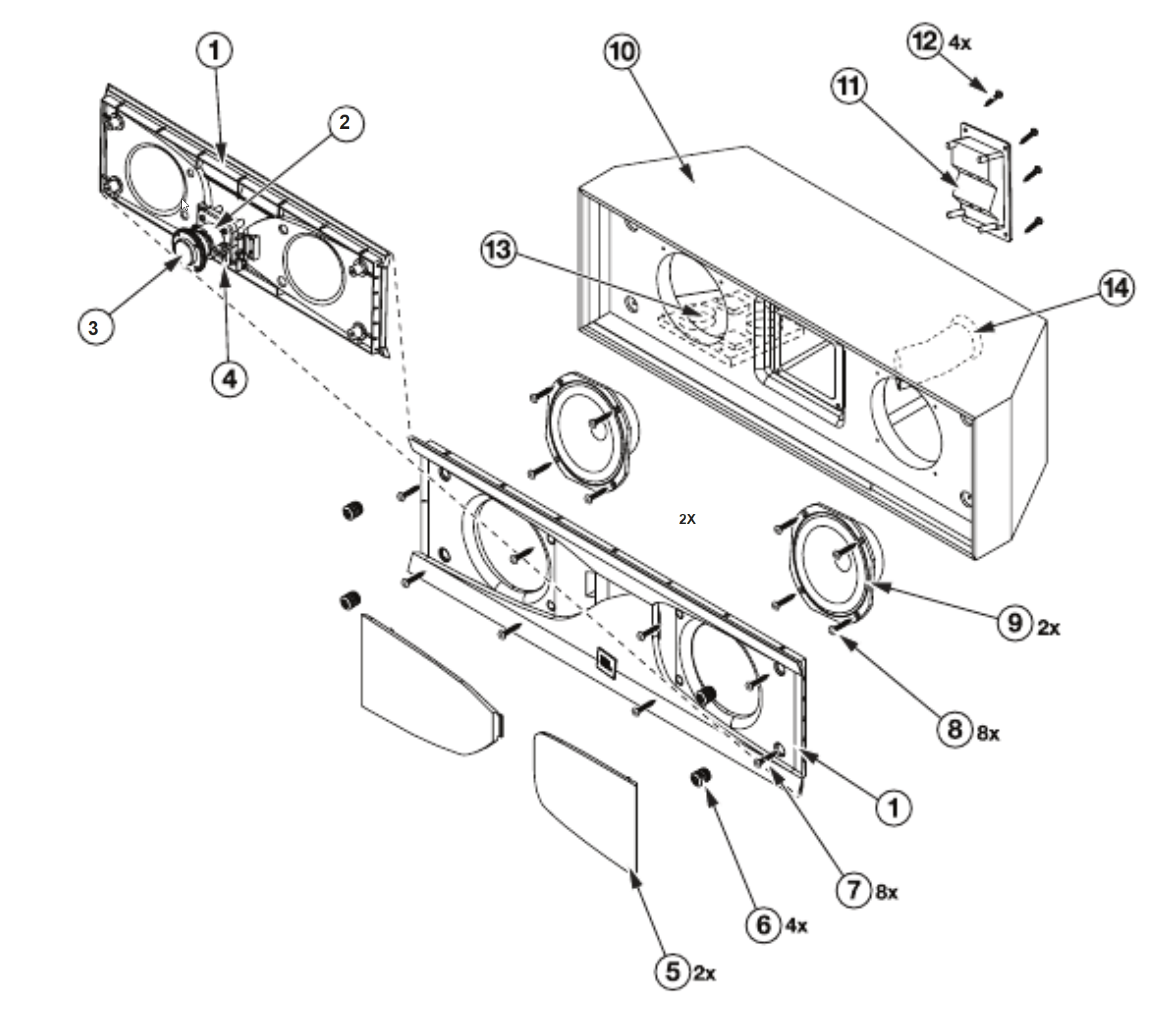

In the past, it has been challenging for me to get midranges to work on existing waveguides. Basically, most glues don't stick to ABS very well. This is complicated by the fact that the surface of waveguides are curved, so you're trying to get something flat to laminate to something that's curved. It's tricky.
I once tried to "unitize" the QSC waveguides used in the Econowave Deluxe, and I gave up because the 3D printed mounting plates peeled right off. Bolting them to the waveguide certainly helped, but I wasn't keen on the idea that the glue might be delaminated while the bolts are holding the midrange mounting plate, leading to a leak between the waveguide and the plate. So I shelved it.
With that in mind, I wouldn't rule out the possibility that I might just create an entirely new waveguide for the 520C, and just keep the enclosure alone.
My woodworking skills are abysmal, and at a price of $135 for the entire speaker (delivered), that's not much more money than a flat pack would cost.
As illustrated in the attached pic, the entire face of the speaker is a single piece of plastic.

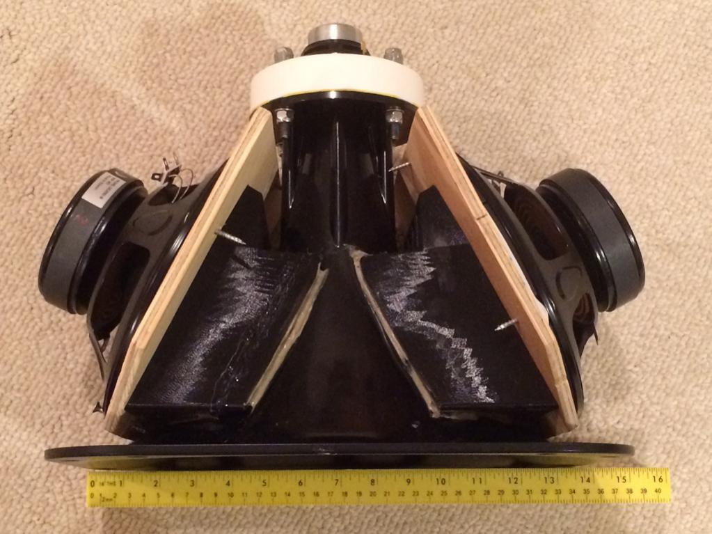

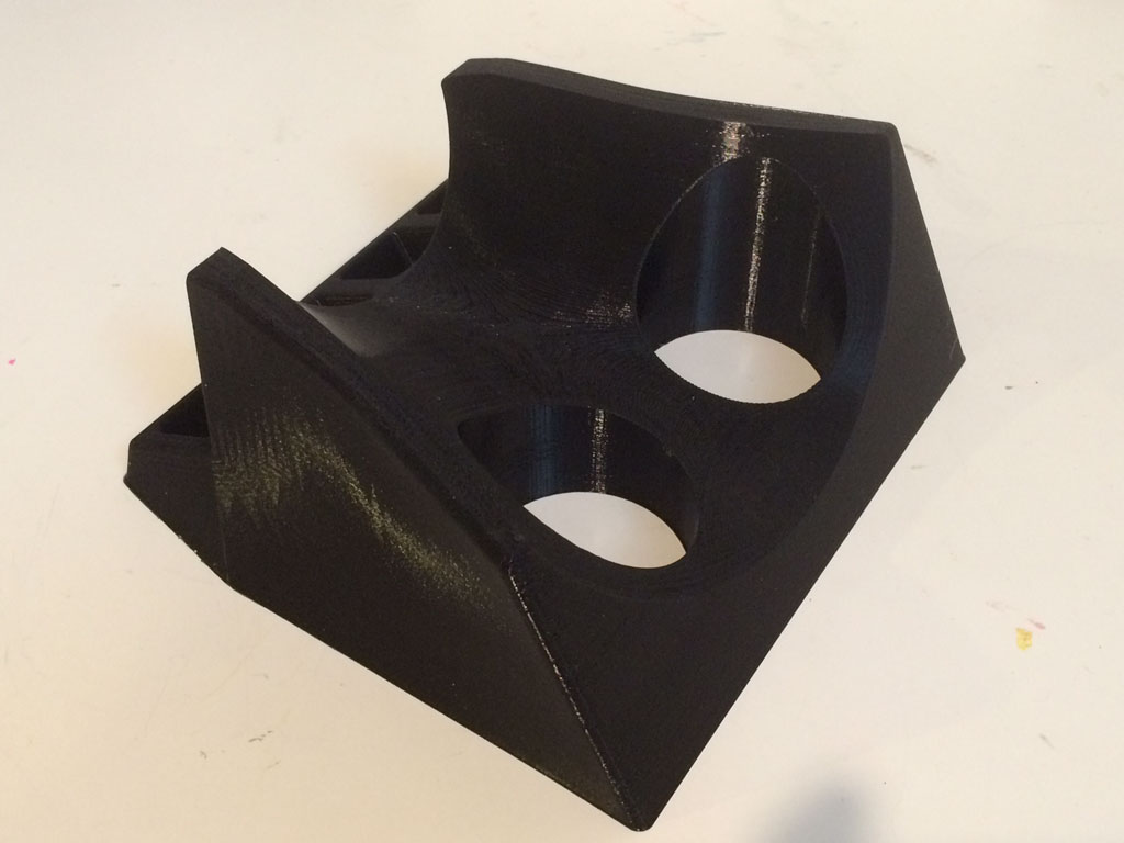

I found that a 3D printed adapter that matches the curve of the waveguide plus PL Premium adhesive sticks like crazy to ABS surfaces. I did that with the point source bookshelf horn.
https://www.diyaudio.com/community/threads/a-bookshelf-multi-way-point-source-horn.285030/
Here’s the adapter:
That compound curve was crazy to make. I don’t even remember how I did it. We did not have 3D scanners on our iPhones back then LOL!
I traced paper cutouts and digitized them and then spline fit them on SW I think.
Here’s the adapter:

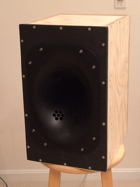

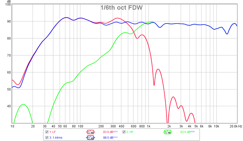

Yes, this speaker here:
XO was DSP Harsch at 600Hz:
I originally used a pair of Dayton classic 8in paper cone woofers but eventually moved up to Dayton RS180P-8 7in woofers and a SB65WBAC 2.5in full range at the throat.
Here was measured polars:

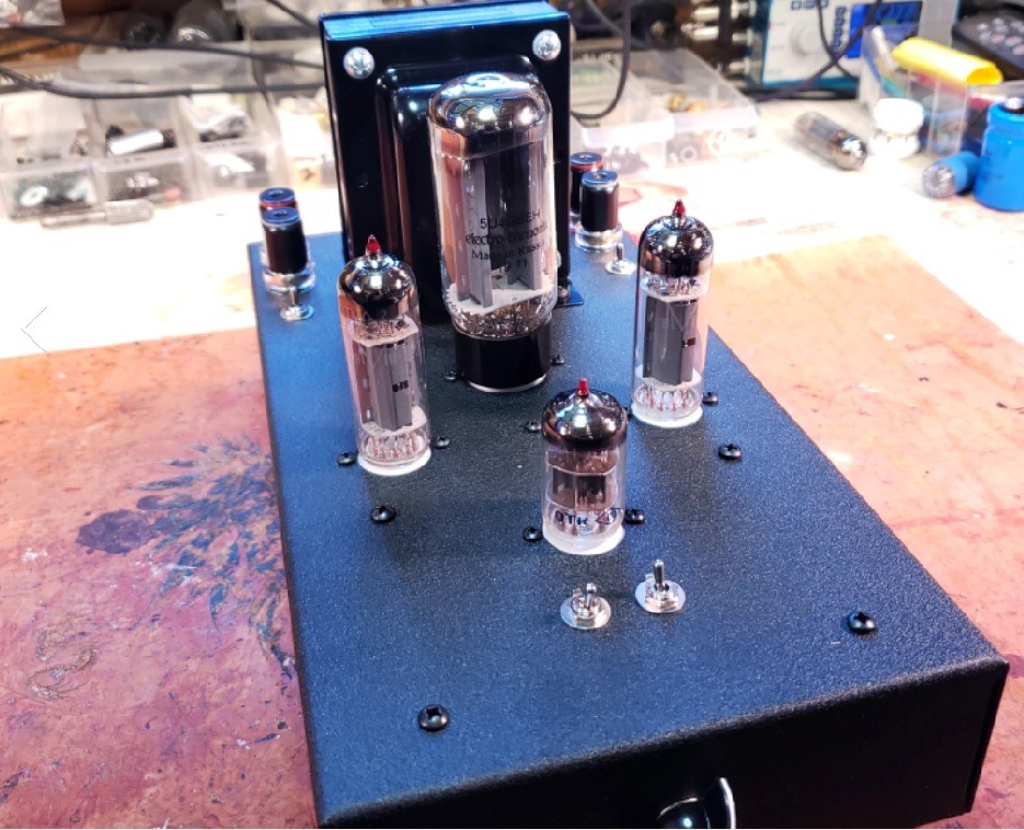

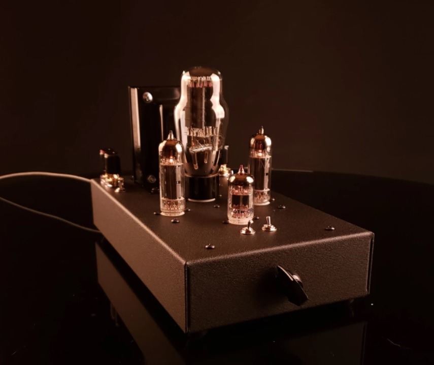

I am working with JPS64 on a new 350W push pull monoblock tube amp. 🙂
