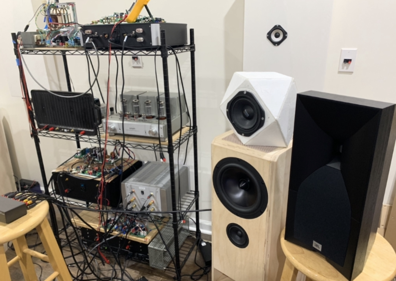

I recently got an pair of JBL Studio 530 monitors on sale for $250 direct from JBL. I was curious what an entry level horn loaded CD 2-way monitor could sound like. They actually sound quite decent and measure well when the tweeter is padded down a notch. The reviews of these are generally very good and for $250, no DIY project will come close really given the nice cabinet (no parallel walls in sight), a horn, passive XO, and decent bi-wire/bi-amp 5 way binding posts.

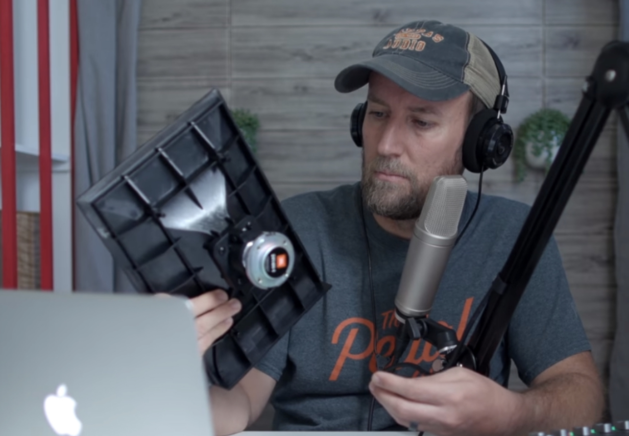

What intrigues me about these is that the horn has lots of opportunities for cutting slots and holes for mid range injection to make a bookshelf Synergy. Has anybody thought about doing something similar? My one reservation is that this speaker sounds very good as is and I would hate to cut into it.
Here it is next to my 10F/RS225 TL speaker for size comparison. It works well with either my Class AB or class D amps. It needs so e power though, probably at least 40w to really come alive.

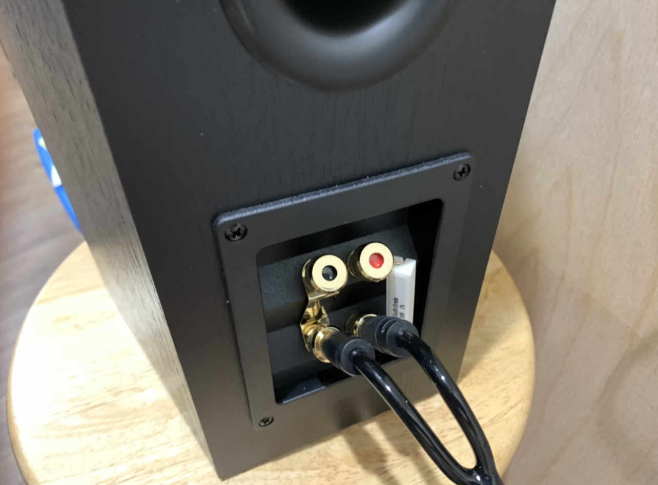

This is how I padded the tweeter but adding a resistor between the woofer binding post and tweeter binding post.

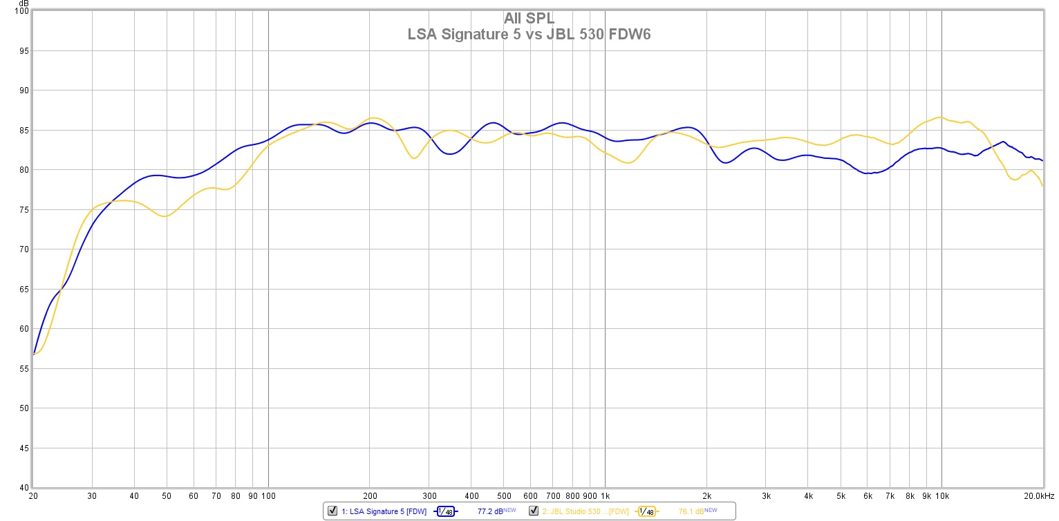

Here is how it measures with the tweeter padding in place. Without it, the response is a bit bright for my taste. The JBL 530 is the yellow trace and the blue is a new speaker I just developed with a typical “Harman house curve” voicing for comparison.
Here is what is interesting, Ron from New Record Day, did a tear down and you can see the inside of the horn. Lots of open surface area for mounting small 3in midrange cones for a mid injection a la Synergy.

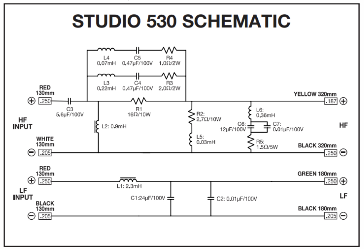

Here is the XO schematic from The manual:

The published existing XO is quite complicated. I was surprised because they normally don’t use that many components on a “budget” speaker.

I am going to see if bypassing the terminal posts helps or not, I am looking for a good way to do it .... my first idea is to run the wire thru a small hole in the terminal cup or very near the terminals out the back of my speaker then clamp a good quality ring terminal connector on that wire , then terminate my speaker wire with a ring terminal connector , put some shrink tubing on the original post and put a plastic washer on first then snug both ring connectors up to each other then another plastic washer and tighten down the nut ... saves me the money from buying the Tube Connectors to see if there is anything to the idea. I could Just run the wire out and connect wire to wire but I want to try it on several speakers before deciding and this lets me connect things a little faster and not keep having to wind the wires each time.... but I'm still thinking it thru to see if I can come up with a better idea.
