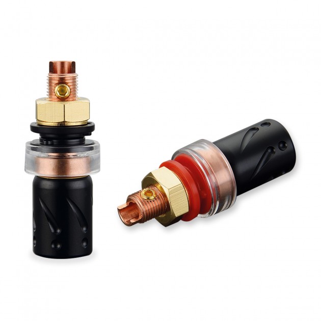

Hi xrk , sorry I forgot to answer your question as to why not just bypass the internal crossover completely - I will be trying this idea on all of my speakers , to see how much of a difference it will make on each speaker. And the nice thing is all I have to do is take off the two plastic washers and the plastic tube that will cover the bolt and I can go back and forth as many times as l like to compare to the original speaker post to no speaker post. I want to answer the question for myself, no reason to spend extra for Tube connectors if I don't think the difference warrants it.... But if it does make a difference , every little bit helps!!! - --- Especially if I can't afford the really high end audio equipment.
Try it your cheap way if you want, but if you're truly interested in loudspeaker performance and quality sound just stop watching those video's made to an agenda of earning some easy money from unsuspected viewers like yourself.------ So that is why I am going to try my cheap version first - then if I hear a difference then maybe try Tube Connectors. ....
PS. Hope I didn't ruffle too many feathers.
try reading some good material to get a proper education, like Toole's book. It will not have all the answers but it will give you a more useful education
than buying those Tube connectors. The price will probably be close enough to consider the alternative (the book).
I think there is an easier way to test this and that is to use 12ga high strand count silicone jacket RC race car/drone copter wire as speaker wires and run it through the vent port and solder it directly to the XO board terminal. That will be better than any connector.
I do not completely discount connectors and wires as part of the critical path. I have found that 6ft long 12ga speaker wire provides measurably improved damping factor at the speaker vs 16ga lamp cord.
I think cheap binding posts or, heaven forbid, plastic springs clips on cheap speakers, may impact the sound. Mostly by impedance and impact on damping factor.
for this reason, I spec pure solid copper 8mm dia thread binding posts (Viborg BP603) on my commercial amps and speakers. They are not cheap, but I feel they provide a solid signal throughput and they look and have a nice “feel” when you use (touch) them.
Wesayso’s point about spending the cost of the “tubes” on books/education is a great one.

The seeds of doubt....all say that if the speaker is designed really well
A small problem like binding posts deserves a small amount of attention. They should be practical. There is a study here that fruits and vegetables can make good conductors, and they sound good too.
If you learn the kinds of issue that wesayso is talking about, you can remove your doubts.

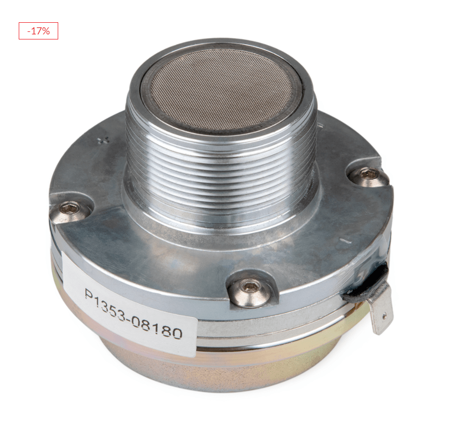

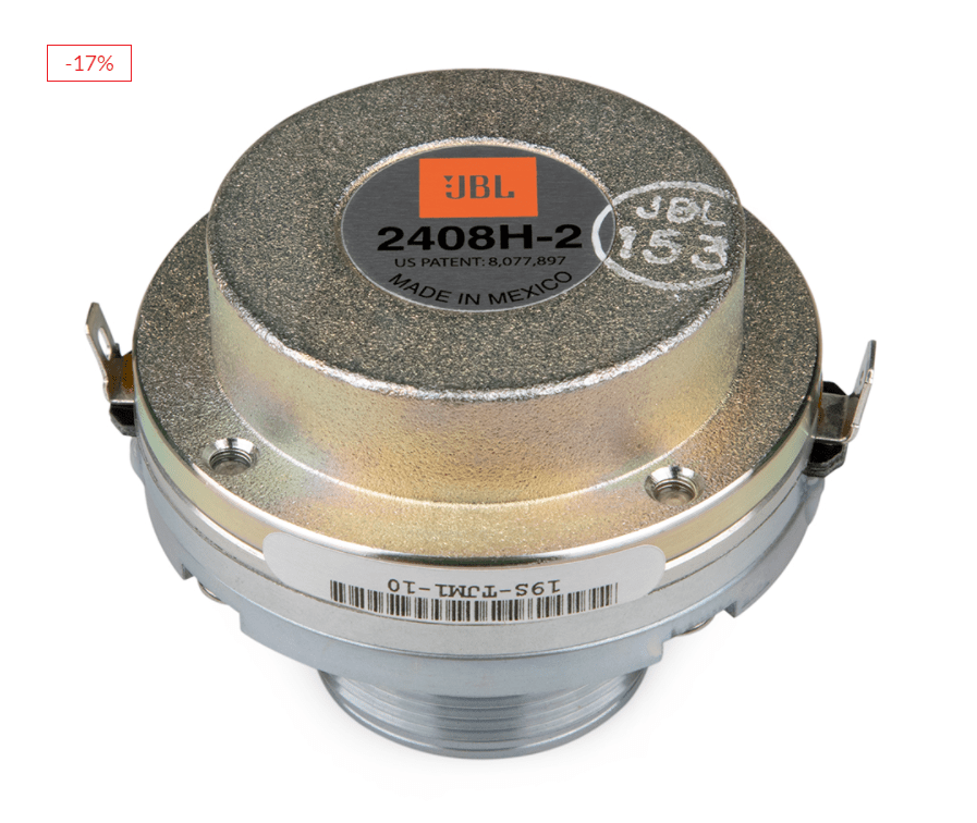

I believe the JBL 2408H-2 will fit that waveguide. You'll want to double check:
https://www.simplyspeakers.com/jbl-replacement-speaker-driver-2408h-2-5020337x.html
This is a criminally underused compression driver. It's basically a more refined take on the BMS 4540ND. The BMS sells for about $150, the JBL is $65.
https://en.toutlehautparleur.com/compression-driver-bms-4540nd-16-ohm-1-inch-exit.html
The Danley SH-50 uses the BMS 4550.

In an earlier post, I talked about how nice the JBL 2408H-2 is, especially for $55.
I had that wrong. I have the JBL 2408H-1 here in my garage. And it's very nice. But it's also 3X as much.
I still think the JBL 2408H-2 may be a compelling upgrade for the 530, especially if you "unitize" it:

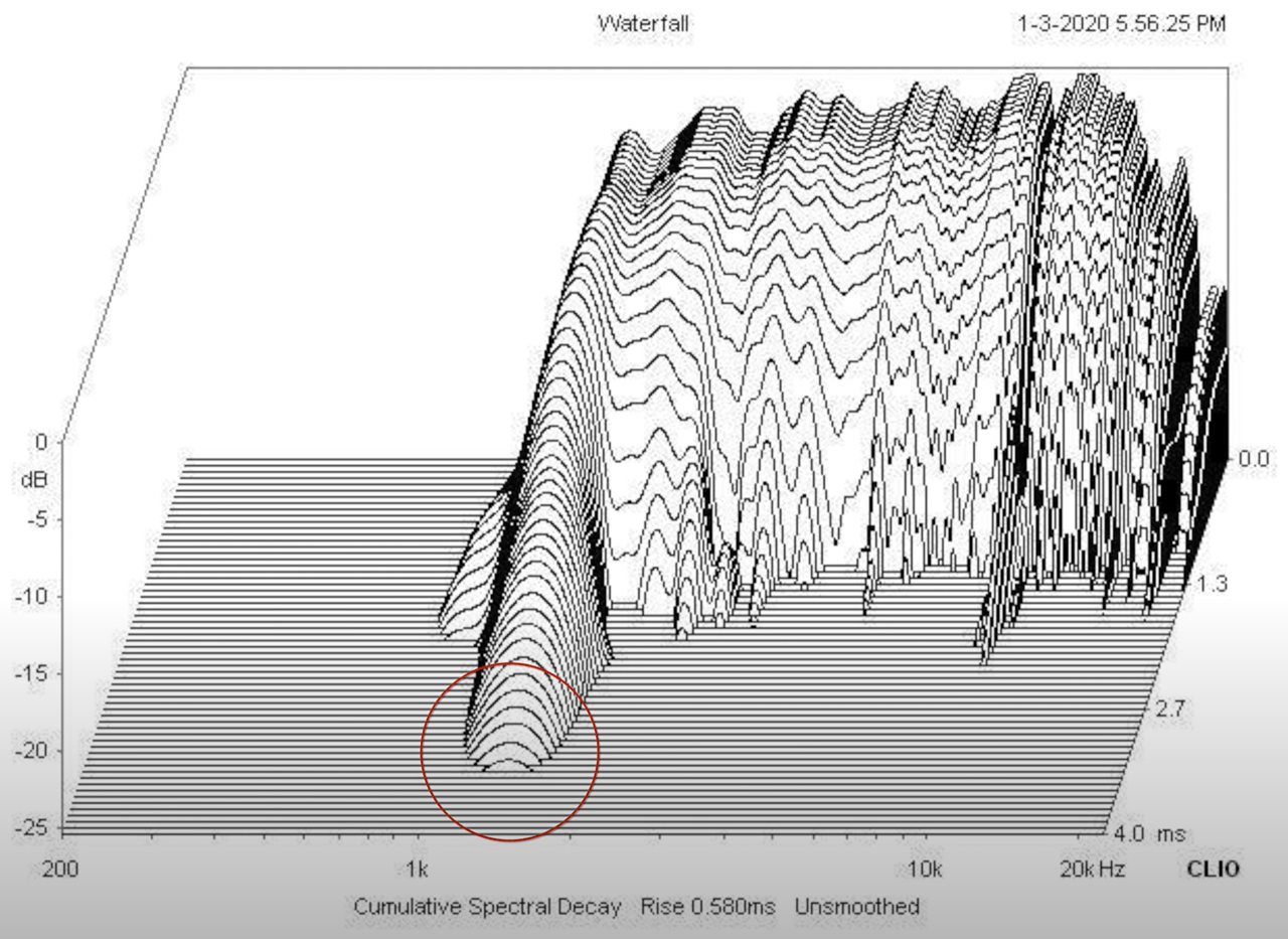

In the measurements that Danny Ritchie did, you can see a gnarly resonance in the tweeter of the Studio 530. I would speculate that the resonance is there because the tweeter in the 530, the JBL 2414H-1, has a puny motor. Combined with a really small back chamber, you end up with a peak at the low end of the tweeter. The JBL 2414H-1 is used in some JBL speakers that are 10dB louder than the Studio 530. So I think what Timbers was doing here, with the crossover, was intentionally creating a resonance on the low end, allowing the tweeter to be crossed over lower than you normally would. The Studio 530 is crossed over at 1400Hz, which is quite low for a tweeter. The JBL 2408H-2 has a bigger motor AND a lighter diaphragm (because it's a ring) so I have a feeling that it will not have the resonance seen in the 2414H-1. At the same time, the lower Q of the 2414H-1 will likely create a dip in the midrange which could be elegantly "filled in" by a couple of small midranges.

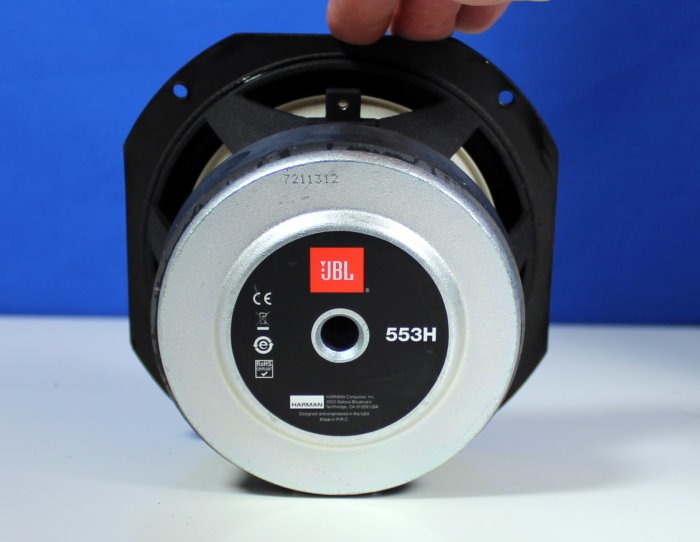

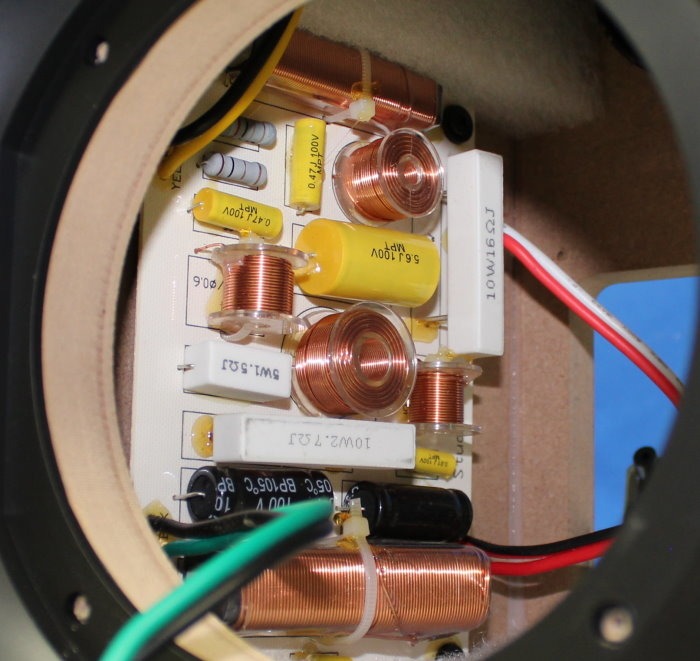

Hi Patrick B,
I’m getting confused. Are the photos above of the tweeter, woofer and XO from inside the Studio 530? Did you take these with your set of 530’s? Which tweeter is inside the 530, 2414 or 2408?
The photo is from the inside of a JBL Studio 530, which I found online.

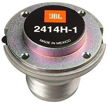

The Studio 530 uses JBL compression driver 2414H-1 (be careful when looking this up, there are multiple variants such as 2414H)
The 2414H (and it's variants) is basically just a dome tweeter with a compression chamber. I'm not saying it's a terrible tweeter by any means, but it clearly has a big resonant peak right in the midrange, which we don't want. The JBL 2408H-1 is a particularly nice ring radiator from JBL, I think it's superior in some ways to what BMS sells, and in a lot of respects it's a miniature version of the D2430K that's in the JBL M2. Both were designed by Alexander Voishvilo at JBL.
The JBL 2408H-2 is a cheaper version of the 2408H-1, with less motor. But still a LOT more motor than the 2414H-1 and also a lighter diaphragm (because it's a ring not a dome.) YMMV but I think ring radiators sound smoother than conventional compression drivers. And the 2414H and it's variants appear to screw right into the same waveguide.

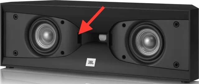

I reviewed the various JBL Studio options and decided to order a pair of JBL Studio 520Cs
I evaluated the 520C, the 530 and the 570. At first I was going to get the 570, which is on sale for $199 right now. The 570 is one or two dB more efficient than the 530, due to it's use of two woofers instead of one.
But the 520C is also more efficient, with higher power handling than the 530. I dig the fact that it's symmetrical.
As always, I can't think of a good reason why you'd want a center channel that's an MTM flipped on it's side. As years of measurements have demonstrated, this configuration leads to horrendous polar response right in the midrange, where you'd want good response.
But Unitizing the waveguide fixes that!
So my 'hunch' is that if we add a couple of midranges to the JBL 520C, we should be able to create a Unity horn that covers about 80Hz to 20khz, with polar control on ONE axis down to about 500Hz, maybe even 300Hz. (Because the cabinet is quite wide - twenty two inches.)

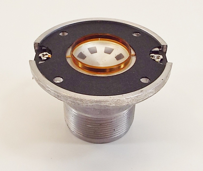

Tangent question; I have two spare 2414H-1 that I have ordered china diaphragms for (JBL part is to just replace the whole driver hence the spare magnets). Are there any worthwhile screw on horns for a unity horn project?
LOL, I almost thought this was a mid injection port! Is that just the diver for the grill mount clip?
If the 530 has a 1in screw thread can we install any CD we want to it?
