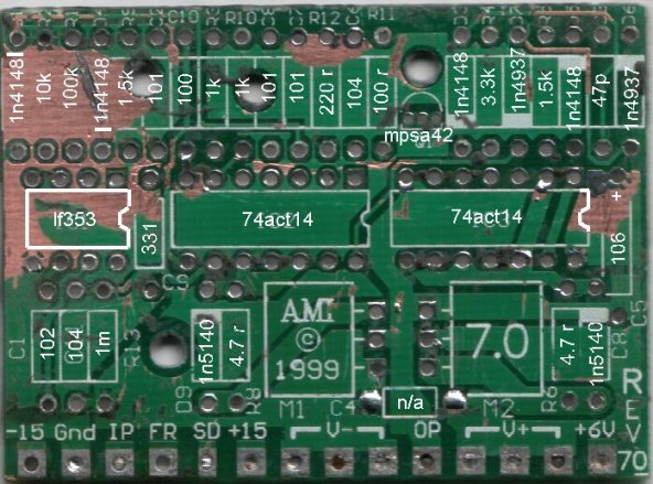

Yes, that is correct for the layout Pat, except for one mistake, on my part....
:att'n: D8 and D9 are 1n4150:att'n:
I have it down on my paper right, but when I typed it into the graphic, my dyslexia kicked in. I have them down on the schematic as 1n5140. Please accept my apology for the mistake!:smash:
BUT here is the good news:
the cap C3 that is marked with just a 47 is indeed 47 pico!
And I tested the ICs and both schmitt inverters are perfectly ok, so there goes the theory on the 6V being too stressful on them.
The ONLY 2 bad components were of course the IRL640's...those are direct shorted between Drain and Source. I already had that figured just for the fact that the 2A fuse on the main board was blowing immediately!
Hope this helps ya'll...

First to comment on the the use of an op amp as a comparator.... blech.
Second to comment on the pull down thing. This is interesting. I have to point out that while on the breadboard, you weren't sure of all the values to use, so that will change things significantly, as will the use of a breadboard to begin with, but, I still think it is an excellent point. It would seem that whole section is floatingm, not too smart. Perhaps a 10K pull down would be best placed between C2 and R3. If that's left to float a really ugly condition can occure where it sits near it's threshold and bias both it's output devices into Class A, .... meltdown. Being a schmitt trigger though, it would like switch spurriously, I'm not sure how fatale this would be while the amp is turned off, probably not very. Whatever, a 10K is cheap insurance.
D6 and D7 ..... rectifiers? Disgusting. They should have a low voltage drop, either small signal or the more expensive shottky's, more importantly, they need to be fast recovery, which these are claimed to be, for a rectifier. But, a fast recovery "rectifier" with a ~200ns reverse recovery time just isn't fast recovery for this job. No rectifiers allowed. 2ns to 4ns is alot more like it! I would be changing those to something more suitable for the application. It isn't a big deal for D7 at all, but they should be the same, the only purpose of D7 is to provide the same voltage drop as D6 produces, helps keep things in equilibrium.
Here's the other part that caught my eye that I'm getting to now.
The inverters are different.
Pat's used MC74ACT14AN, part of the ACT family, so what's the difference? VCC _recommended_ max for the ACT family is 5.5V. While for the AC family it is 6V. They're both spec'd to flat line at 7V VCC... or VDD rather.
Not a huge difference. It seems they went with logic level mosfets and gave themselves a bit more headroom on the driver supply by going to the AC family, it won't save them if they aren't bypassed.
The other difference, is their input thresholds. ACT is a TTL compatible family, which means it has a Vth of 1.5 or1.2 volts, the data sheet shows different values because it is a device with hysteresis, therefore showing thresholds of .8 and 2volts.
While for the AC, Vth is supposed to be VDD/2. The data sheet specs it at a min of 1.1 and 3.9V.
These are all given at a VDD of 5.5V. So basically the AC family, is a little more at home operating at 6V VDD, and has better noise immunity at the input.
Either way, proper bypassing of them is critical. Did I say they should be well bypassed? I think they should be well by passed.

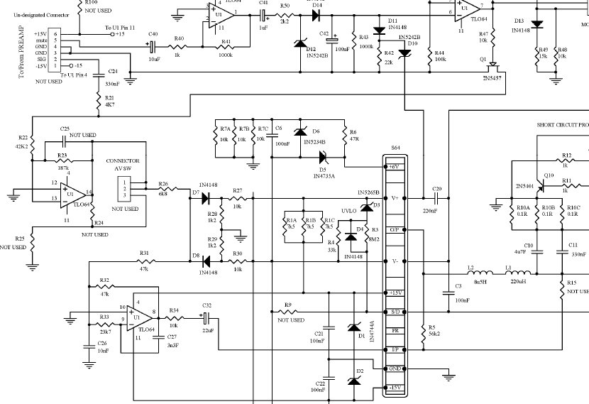

Hi, i did work on the preamp part of this stupid sub today. Many parts are toasted, almost all the diodes into the muting circuit were short.
D10,11,12,14
C42 was short as well. :dead:
It work ok now (just the preamp section), but i am wondering about something: the op amp just before the module (pins #8-9-10). If i inject a simple 100hz sine wave, it goes thru ok until it goes thru that op amp, then the output signal appears flattened, but still something sine wave. Duno the purpose of this.
also, the vcc rails for the op amp, as well as the rails for the module, are very badly filtered. So i did add some caps. It looks like it will work far better with this addition.
also, i did all the required reworks as per the lates service manual.
I may make it work on its own tonight...

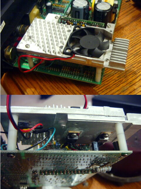

Ok, here is an update... my board is assembled and installed, kept it all stock for now. What I did differently tho is I added a nice little mod to the cooling capabilities!
Yesterday while messing with an OLD laptop, I ended up cooking the CPU, so low and behold, I had this really nice low profile, light weight, excellent thermo-conductive piece of aluminum, and it came with a really cool little 5V fan!
So, here is my MOD for the cooling, I put both hexfets under the heatsink, used isolation pads and thermo grease, then I also added a +5V regulator (on the left side of the image) so my fan can tap the +15 from the op amp and step it down to something the fan can handle. I used 2" lengths of 18ga wire to jumper to the mosfets and used heat shrink over the connections so hopfully it won't arc.
My bench test outside of the speaker cabinet was a success! At that point I took the pics, and sent them to you guys! Now, for the big test...it's going in and getting thumped! (hopfully). I will let ya know how it turns out
Enjoy the mod pics!

You might wana check if the +15vcc will not drop, it is very poorly regulated, there is no electrolityc cap or so, only very few 100nf caps, loaded with 3x 10k parralel and a 15v zener...
By only making it play with the crossover (no power module), a lot of variations was visible on the op amp rails. I cant imagine what it could be with the power module and full power. perfect recipe for toasting. adding another load on this (fan) might affect it too much.
As an initial test, i added a 470uf cap on both op amp rails...already far better..."real" regulators are on call in mine.

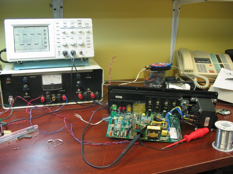

This stupid thing works...I made a caption of the set-up, and a snap shoot on the scope. It oscillates at 75khz, wich is lower than it is suposed too, 100khz.
One thing remains obscure: Once it is turned off, you have to wait very long before it will restart ok.
If you turn it off, and on before the caps are fully discharged, it wont turn on, and stuck to -vcc :dead: :hot: 😡
There is something bad with the start-up and the bootstrap chargeup, wich is controled with the SD signal, i will work on that...
