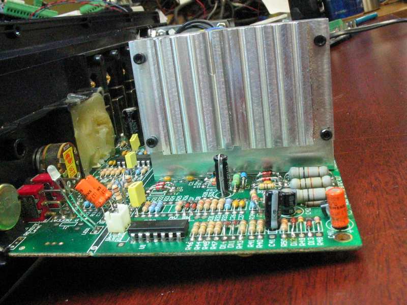

Tekko said:Nice heatsink for the module😎 YUCK its ugly originalYour refurbished one is mutch nicer
thank you, thank you.
Note that the fins on the heat sink are not finished, i have broke my 1/8 endmill...
but anyway, it is already far better, i may leave it like that. No ones will go see inside 😉
i will make it work on its own soon, i mean on its own with the power transfo , not with my external power supply. Who know, maybe something will blow on it again???

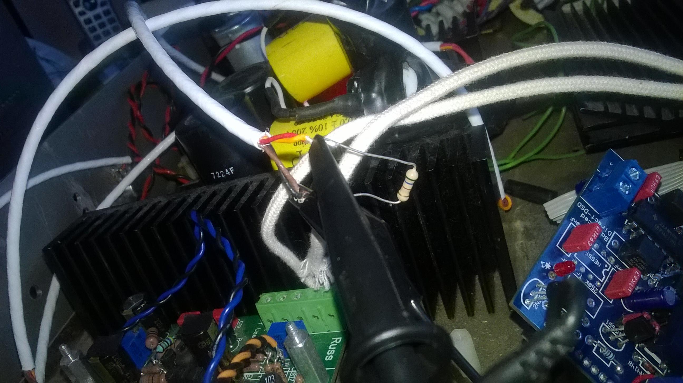

Ok, cool, it works on its own for the first time in 3 years !!

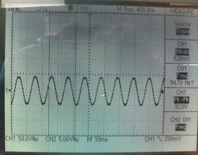

Funny too, the oscillation is now 114khz...i may re-install a 100p cap on the opamp...
I can get 90v peak to peak on a 4 ohm resistance before cliping...
so it is close to 250wrms isnt it?? (45X.7)²/4=248wrms...
nothing smell bad, it start its oscillation right away and every time...good boy, good boy.
One concern on those fets and drivers: i have instaled 1w 5.6v zener on every gates, and also on every places that seemed bordeline.
So now, i will install it into its enclosure and make it play
boooom boooom !!
