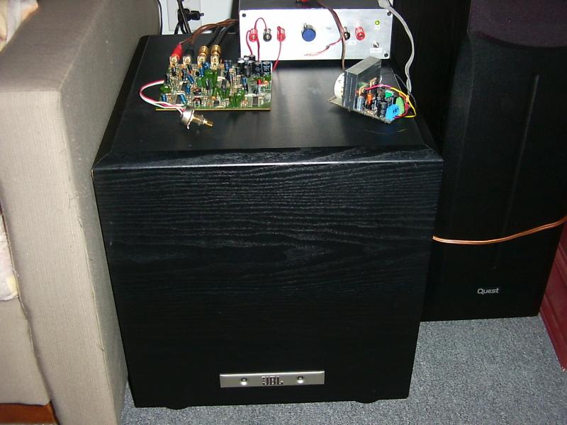

Here is a picture...you can see on the top my IR based module, and the weird board on its left...i let you find...

Hi, im back...
Id like to adress few questions about the output filter. It is done with a 220uh inductance and a plain 4.7uf cap. The inductance looks like it have overheated a bit.
I am searching in my school books the formulae of l-c filters...
Is there any improvements could be done here ?
thanks.
thanks.
