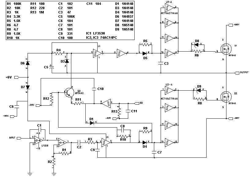

S64AMI schematic and parts list
Hopfully Pat will be viewing this, as it pertains specifically about his reverse engineered S64AMI schematic. I found several flaws in it, errors in the circuit paths, and most notibly the parts values you listed are way off. If anyone has tried to breadboard this thing by that schematic, I would bet they didn't have much luck!
If I can figure out how to attach an image, I will put the corrected parts values and the schematic on here for everyone. I don't have that program that allows me to write PDF's, so Pat, If you wish to re-write this so it is in a better format, PLEASE DO!
What I did is take a screenshot of the PDF and altered it using a paint program so at least I had something. Sorry about the large JPG fellas! I didn't want to loose what little detail was left!

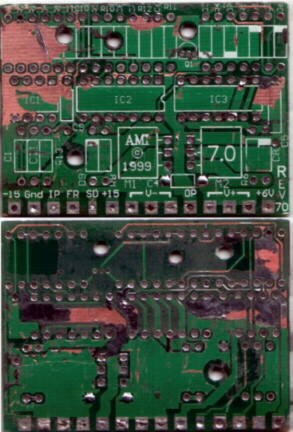

I do have actual scans of both sides of the raw circuit board, so if anyone is interested in them, let me know and I will post them too.

uploaded wrong schematic!
OOPS! Not only did I upload the wrong schematic, I did it twice! (had troubles earlier)
Hopfully I got the right one this time.
The differences are that D8 and D9 are not zener diodes, and d7 is supposed to be 1n4937.
Sorry about the confusion!
Pat,
I don't have the original schematic, but what I did is elaborate on yours. I was able to remove all the black epoxy and be able to retain all the parts, including their color bands and number codes (caps for instance). Talk about a tricky experiance! Then I was tracing through, using your schematic as refrence and noticed that the pathways weren't exactly correct (almost perfect, but I suppose since you used a mini torch to remove your black goo, things might have been burnt away) according to the circuit board traces. So I decided to expand on your start and make the necessary corrections. I also scanned the original board so if you would like to compare, to make sure I didn't miss anything, please feel free. I mapped out what goes where, it's orientation, etc. so nothing would get lost in the process of removing everything.
Hopfully the schematic will attach to one of these posts!
Jer
Jer

Hi, C3= 4.7p and C7=100p ? i dont see why they are not the same value...just wondering.
And what about C11 ??
c3 and c7 are different probably because they run on different signal levels.... i don't know. C11 is part of a completely different circuit in the schematic. I wouldn't expect that to be the same just because it is attached to the same IC.
I pulled the parts off one at a time, documenting each one as it was removed. This is how the circuit was set up.
Friday I ran across this post, yesterday I removed and documented the components, and today I reverse engineered the schematic as it was laid out on the PCB. I haven't had any time as of yet to figure out why things are the way they are.
I'm goin gto attach the two board pictures with the components removed for those who would like them. Some of the solder mask tore off the board while removing the potting, however most of the detail is still clearly visible.
