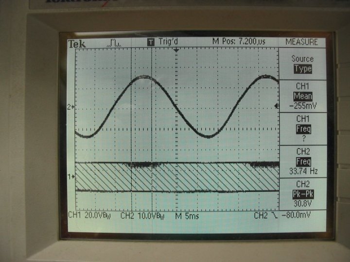

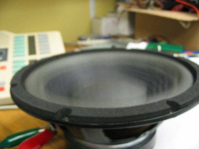

and that poor litle subwoofer...
yes, it does wooof, at 35hz...

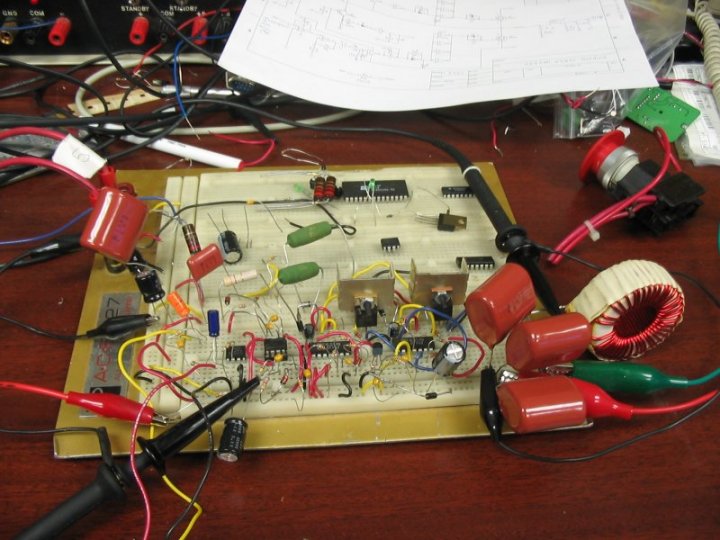

cant wait to build a board and the better mosfets...
I will do a full schematic upgrade, with all the component needed to make it work, and the gerbers for the PCB when it will be done.
I will do it a la zappulse i think...

Looks like there's some high frequency ripple/oscillation on your square wave, the gate turn on resistors are pretty small though, could be the cause of that??
It would be really cool to see a before and after of that with the new mosfets when you get them, I dont' think you'll have to wait very long for those either btw.
I see you do have some means to cool the mosfets after all (better than nothing).
There probably isn't much point trying to tune it more than it already is on the breadboard, alot will change once you get it on PCB.
It would be cool of you if you took more pictures of how it worked when on the new PCB, and then again with the new mosfets.
You might find your biggest problem is keeping those new mosfets turned off when they're supposed to be, try to keep all the current loops from the driver to the fet as short as possible, ground the drivers right on the source pin if you can.

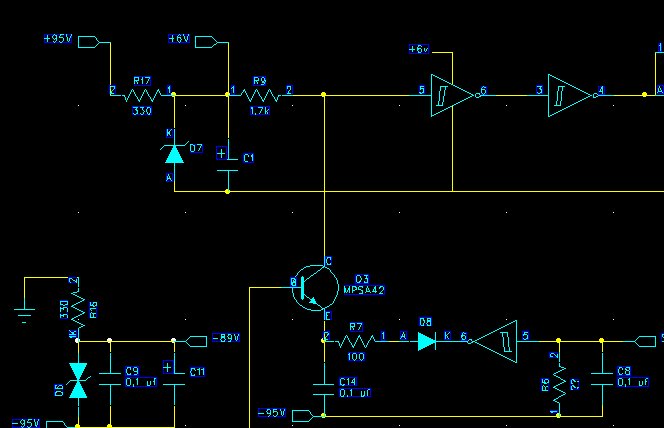

Hi Pat,
If you wire the bootstrap exactly as you've drawn it in your first "reverse" schematic I think it would work fine.
The bootstrap circuit will only charge the cap when the amp switches low, so check and see if your SD circuit allows the cap to precharge before the output stage is enabled, if it does it should work fine.
Done this way, it just dont want to start it self osscilation, if i apply few seconds my frequency generator on it set at ~100khz, then it start to oscilate by itself. Unless than that, it stays stuck at -vdd.
If that's the case I dont' think that SD/inverter circuit can be working to allow it to charge, maybe you can monitor the voltage across the bootstrap diode while you pull SD high/low and see if it does anything?

Yeah looking at it again I dont' think the SD circuit is capable of doing anything in that respect. There must be some associated circuitry on the other schematic to help this function, I am unable to follow it though.
Simple cure.
1. Add something like a 1k resistor + diode from +95 rail to the top of the bootstrap cap. You can use a zener there a bit smaller in value than your Vcc supply which sits on the negative rail uses, this way I think it will be disabled while operational, which is good.
2. Add another resistor from the ground side of the bootstrap cap (tried between the mosfets) and tie it to the negative power rail.
Should be pretty high in value, 50K?
You can get it working without the extra zener too, but it will always be taking some charge so use a big enough resistor, and just give it enough of a delay at turn on to allow it to fully charge.
See what that does for ya.

Hi, what do you think of using half the S64AMI (op amp inputs and comparator right thru the first Schmitt trigger) with the half bridge driver of the previous schematic?
May as well continue this here..
Did you make the PCB for it? I wouldn't expect it to be anything close to good until it's on a PCB, and you'll have to re-tweak it once it is, what you do on the protoboard is just good for a starting point. You can probably measure the value of the caps with a cheap multi meter right?
How come you cant' start it? Still having bootstrap problems?
While you're still fighting with this aspect of it I wouldnt' be so quick to make any radical changes to the design, but you can use a gate driver IC with it of course. Would it be simpler? You'll need at least another power supply, your old SD circuitry will be useless.
Also, while you can use a gate driver, I really wouldn't implement it as per that posted schematic, and it wont' simplify anything, you'll need extra support circuitry and an additional power supply for it, you'll gain the advantage of not needing logic level mosfets.
I believe they used those extra transistors simply to increase drive current, shouldn't be required, use a better mosfet, another reason behind that, they may have been trying to combat the crappy rise time of the IC, but it also say's it has an internal deadtime .... ~650ns!!! I wouldn't use that chip either.
