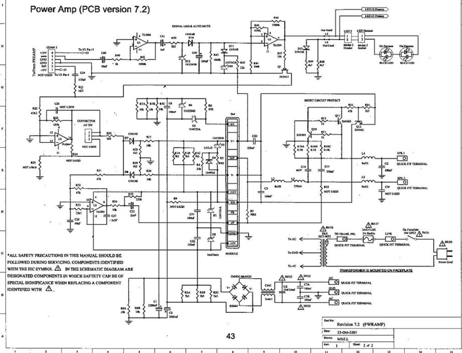

There is realy something wrong with the schematic for the SD input, there is a zener diode tied to v+, a 33k to it tied to v-, and the 8.2mohm resistor is connected to the tied of the zener and the resistor so on should read there +vcc-Vzener, while it should have -vcc+Vzener to get around 6.2v to the SD input, referenced to -vcc.
If i take measurements on the circuit while the module is not there, i read 88.2 volts.
The zener and the resistor just needs to be swaped...😕
There is UVLO writen around this part of the schematic.

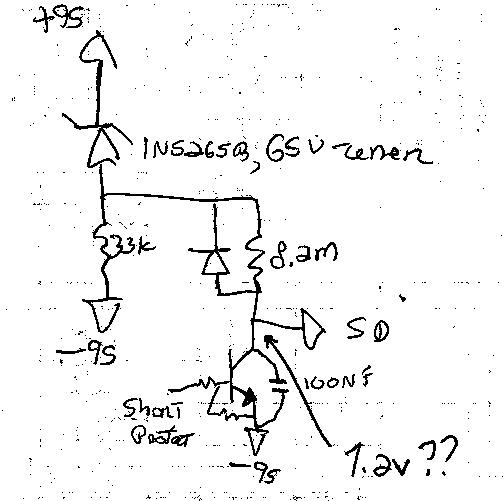

Someone will have to explain me something:
look at the schematic.
This is what the original schematic shows. the zener diode is a 65volt one.
SD input of the AMI module should never be more than 7 volts, referenced to -95v.
I am getting 6.2 volts with the schematic is show you now, so it is "ok"
i dont get it, i was expecting to see +95-65(Vzener)=30v, referenced to ground, but something like 125 volts if referenced to -95v😕
The 8.2mohm resistor is responsible to charge the capacitor at the input of the schmitt trigger inside the AMI module, as a "soft start" ?
If i take measurements on the circuit while the module is not there, i read 88.2 volts.![]()

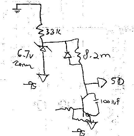

Hi, i finaly made this sh*t work on a breadboard.
The basics seems to work, i am able to get sounds out of it with 15 volts rails.
I have redone the schematic with power logic. There is still some parts that i dont got the value.
C3 and C4 are not on my proto and it seems to work good, i did try some caps in there, from 10p to 100n, no changes. Duno value.
I have a signal generator and a techtronics scope and can see the actual sine signal if it gets distorted or bad,...it is fairly good for now until cliping wich occcurs at close to vcc.
C6 also bugs me, it seems that it just limit the free bandwith of the osccilation, even if it oscillates at only ~20khz for now, cant make it go to the 100khz it should. C7 also seems confusing, i have replaced it with a resistor because the op amp was not able to lower its output enough to trigger the first shmitt trigger.
So C7 is a 4.7k for now. C2 also is an unknow cap value, i have put a 0,01 for now and it works.
SD when high ground the emitter of Q3 thru d8, enabling the circuit to self oscillate. It is part of the muting circuit and soft shut down, it enable the amp to stop without a thump.
the upper shmitt trigger is powered thru D6, when the signal input is low, it charges c1.
the overall circuit is also very instable and very dependant of the output filtering stage. as soon as i put inductor/caps, the free oscillating frequency drops a lot.

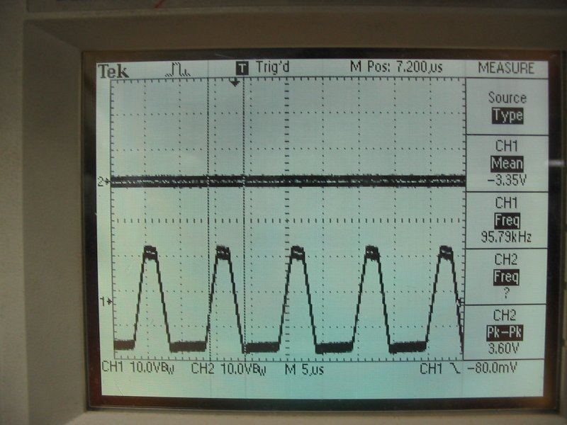

I have changed the power supply on my bread board from 12v rail to 30 v rail, and the mosfets are irf840 wich are not very suited for the task. There is no heat sink as well on them
I managed to get 25v pk to pk on a 4 ohm load, with some begining of audible cliping.
I am stumped. It smell bad too, the mosfet are glow red 😀 .
This is roughly 75wrms i think.
I will order some better mosfets and will build a pcb, there is some emi that i can see on my scope.
This begin to be a fun project, i have tweaked the caps and now i got around 100khz free running frequency.
