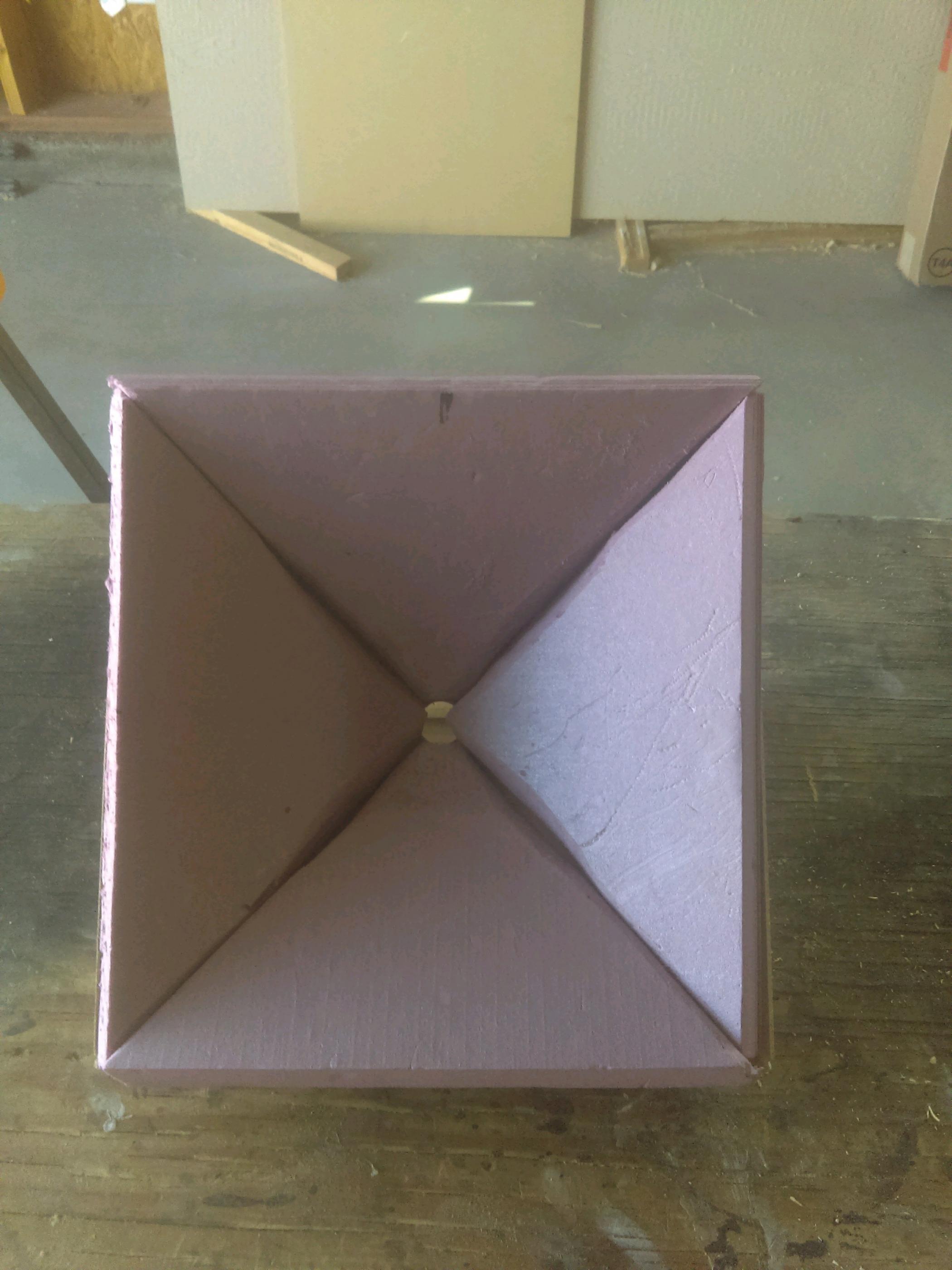

Foamboard M2 Waveguide
I am not sure if this was covered in this thread or not. I have been following it but this thread is getting old. I finished my garage so I have a place and some time to test out some of the things that I have been wanting to try. I wanted to prototype an M2 type wave guide out of foamboard. Has anyone tried this? Can this work? I was looking at the Eminence ring radiator for the CD.
I hate to be a bummer, but if I was building a waveguide out of foamcore, I'd stick with an oblate spheroidal waveguide.
They work REALLY well.
I started this thread, and the M2 waveguides are fun, but they're not really something you can "guess" at. I tried going that route in the beginning, and it didn't work.
Mabat's software is the way to go, if you want to make them.
Eh, I think conical is fine so long as you get a nice round over to baffle.

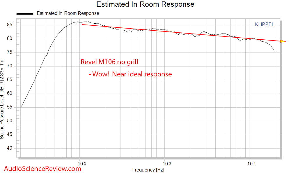

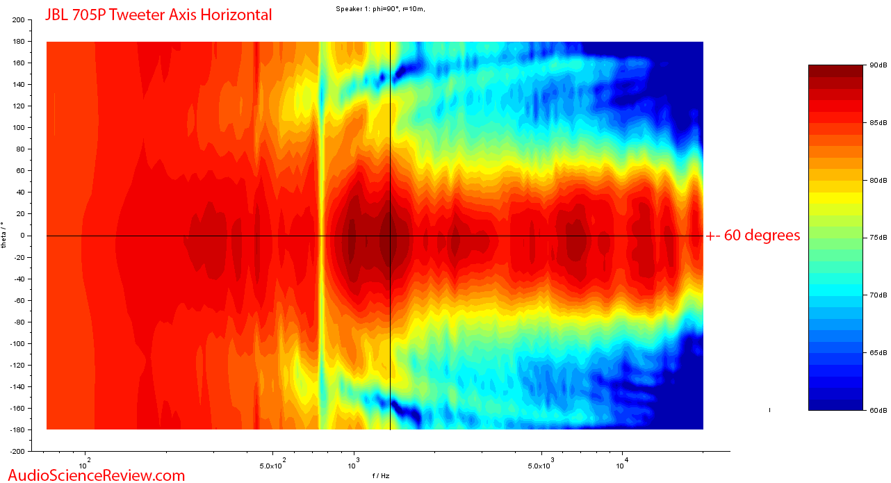

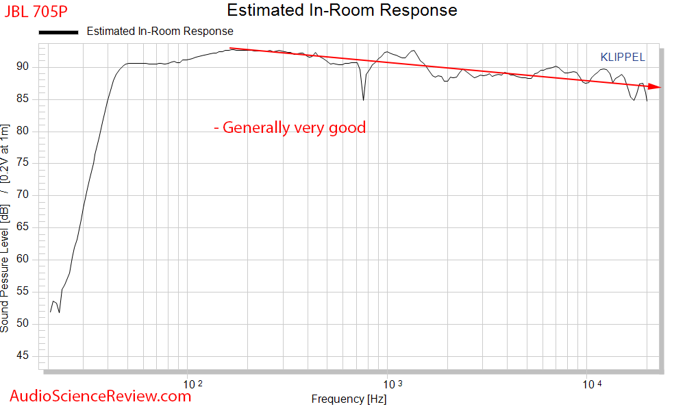

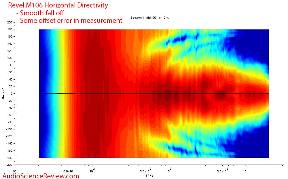

It's kinda the thing I've been agonizing over for about two years now.
Basically after listening to a JBL 4367 and a Revel back-to-back, I think the Revel was quite competitive. I was surprised by how loud and dynamic conventional speakers can be these days.
I spent a ton of time evaluating why the Revel performed as well as it did, and for me the big takeways were:
1) Enclosures are waveguides. I have a thread named this; in a nutshell, you can manipulate the width and the depth of a loudspeaker enclosure to control directivity much lower than what the waveguide on the baffle would lead you to expect. For instance, the Revel M106 has a waveguide that's about 15cm in diameter (2267Hz) but it offers directivity control down to about 500Hz. I believe this is due to a synergistic combination of enclosure and waveguide. IE, we don't need 40cm wide waveguides, we just need to factor the enclosure shape into the overall design.
2) Yes, compression drivers can hit 120dB. But do we need all that? 110dB is a good number I think, and that can be achieved with a good dome tweeter. This particular factor is particularly influenced by the 'house curve' that Samsung uses. In particular, you may only need 110dB at 100Hz, 105dB at 1khz, and 100dB at 10khz. (Because the house curve is sloped down.)
I've attached measurements of the Revel M106 and the JBL 705P. I think what you'll notice is that the JBL has really well controlled polars (because it has a compression driver) but that the M106 has smoother response overall.
JBL 705P Studio Powered Monitor Horizontal Contour Speaker Measurements.png51.3 KB · Views: 475
JBL 705P Studio Powered Monitor Spinorama CEA-2034 CTA-2034 Predicted In-Room Response Speaker...png16.3 KB · Views: 460
Revel M106 bookshelf speaker spinorama CEA2034 Predicted In-Room frequency response measurents.png16 KB · Views: 466
Then you look at the Neumann or Genelec which I also think plays loud enough and they also have really good directivity and smooth responses. The Kiii speakers also go for narrow cabinets and domes and with their cardioid DSP system have what many say subjectivity are the best sound. Cost and size does not equate for me though.
