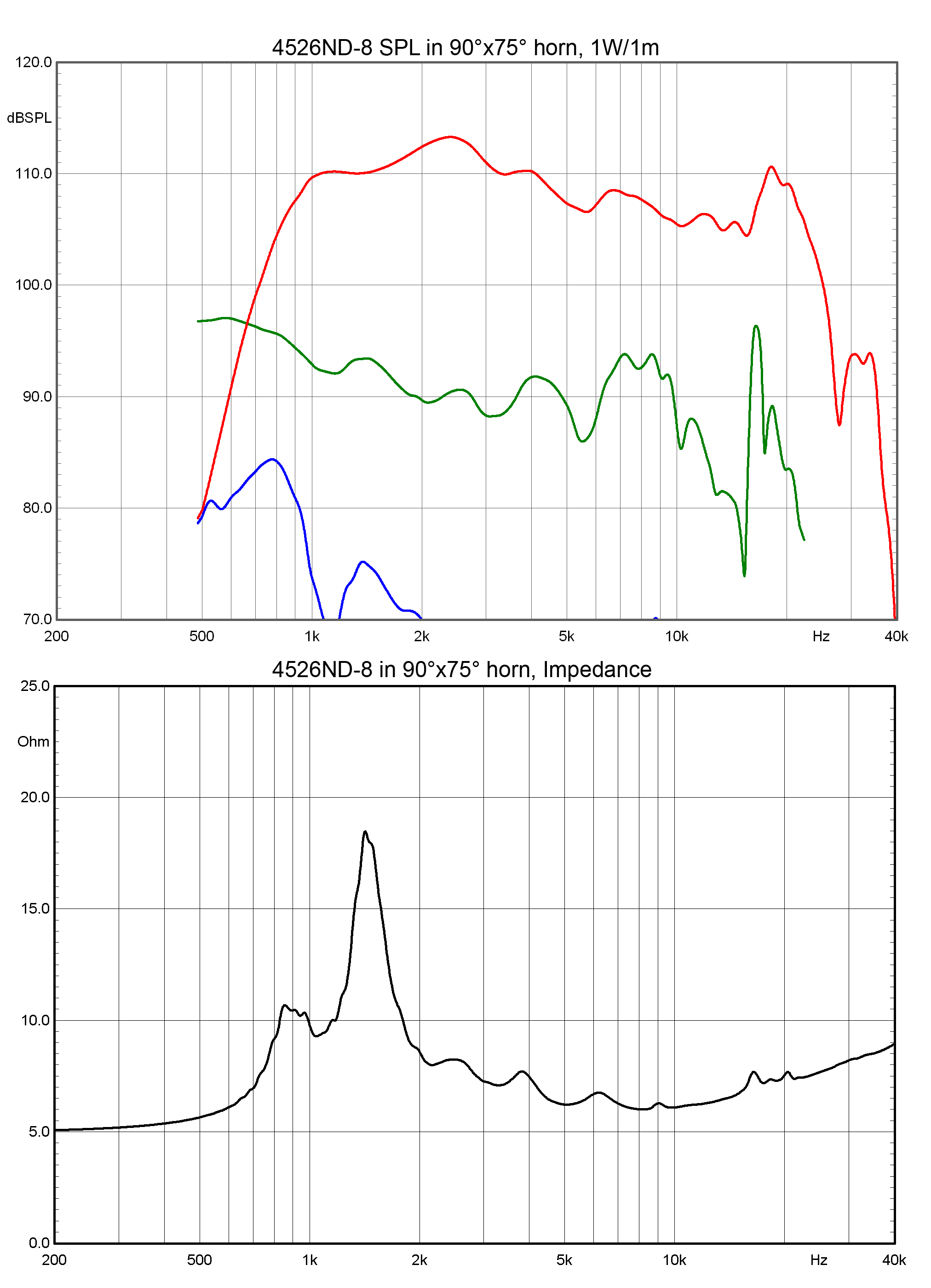

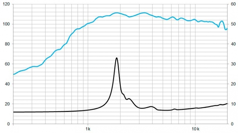

What you guys think about Beyma CD-1Fe 8?
Above 2000hz graphs looks interesting.
Any idea how it compares to BMS 4526 0.63"?

Here's the frequency response of a BMS 4526HE that I put on a 3D printed Unity horn. Thread is here : Nexus - World's Easiest Controlled Directivity Loudspeaker
Here's an Eminence N151 on a QSC waveguide
The performance of both is good, but I think the Eminence is tough to beat. The cost is about the same. It's readily available.
The thing that Eminence taught me, is that it's possible to get beamwidth control all the way to 20Khz IF (and this is a big "if") the phase plug is right.
Geddes was saying this for years, of course.

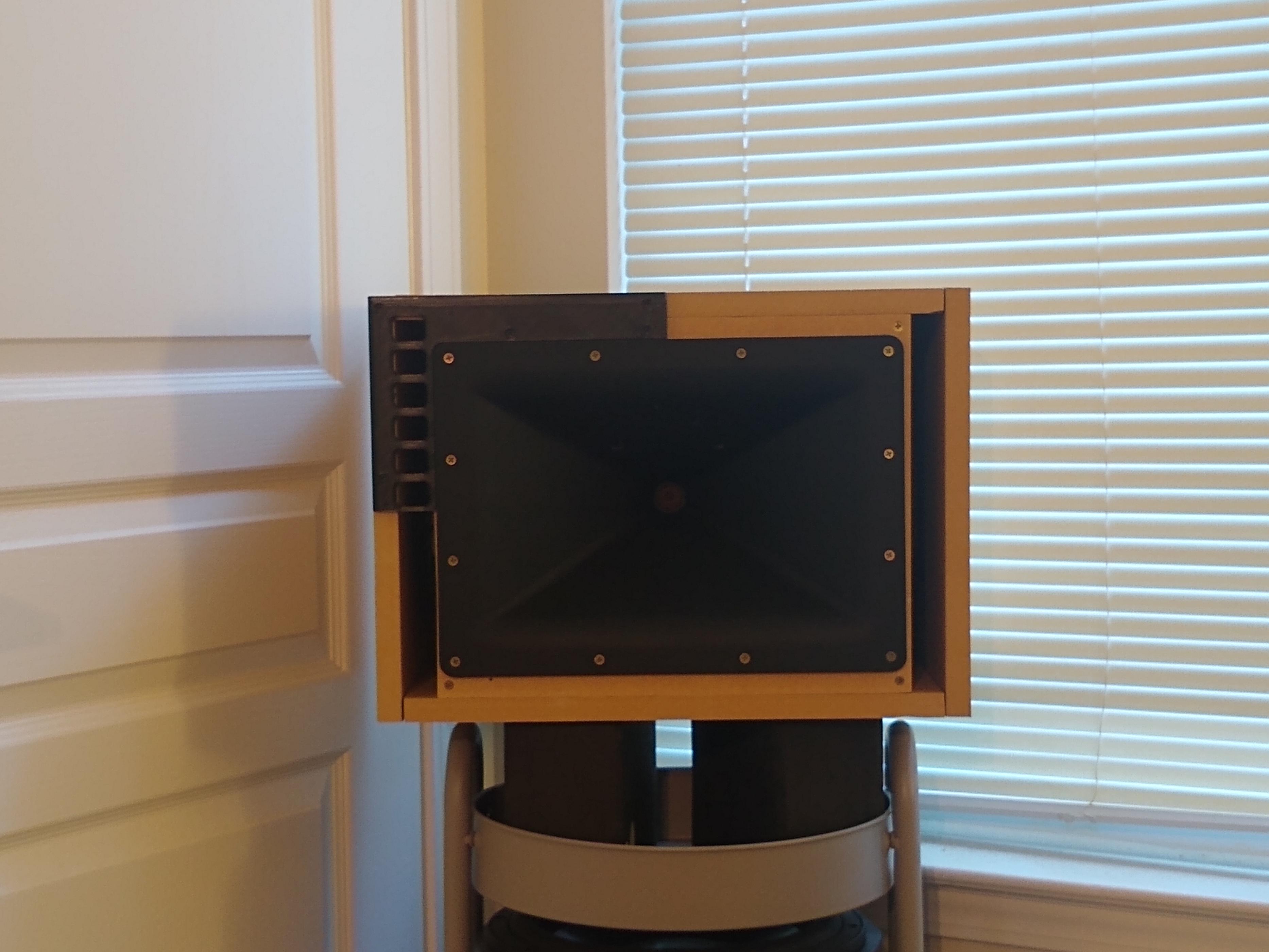

Currently getting close to finishing a similar project, an 18x13x12in phrn 1014 MEH. The second picture shows one of 4 3d printed baffle covers to make the wg flush with the cabinet. Bass drivers fire out the slots in the side with the goal of doing something similar to the small syns. Midrange is attached using the same method as the small syns as well.
Drivers are:
Hf108r
Tf0410mr
8fg51 (x2)
