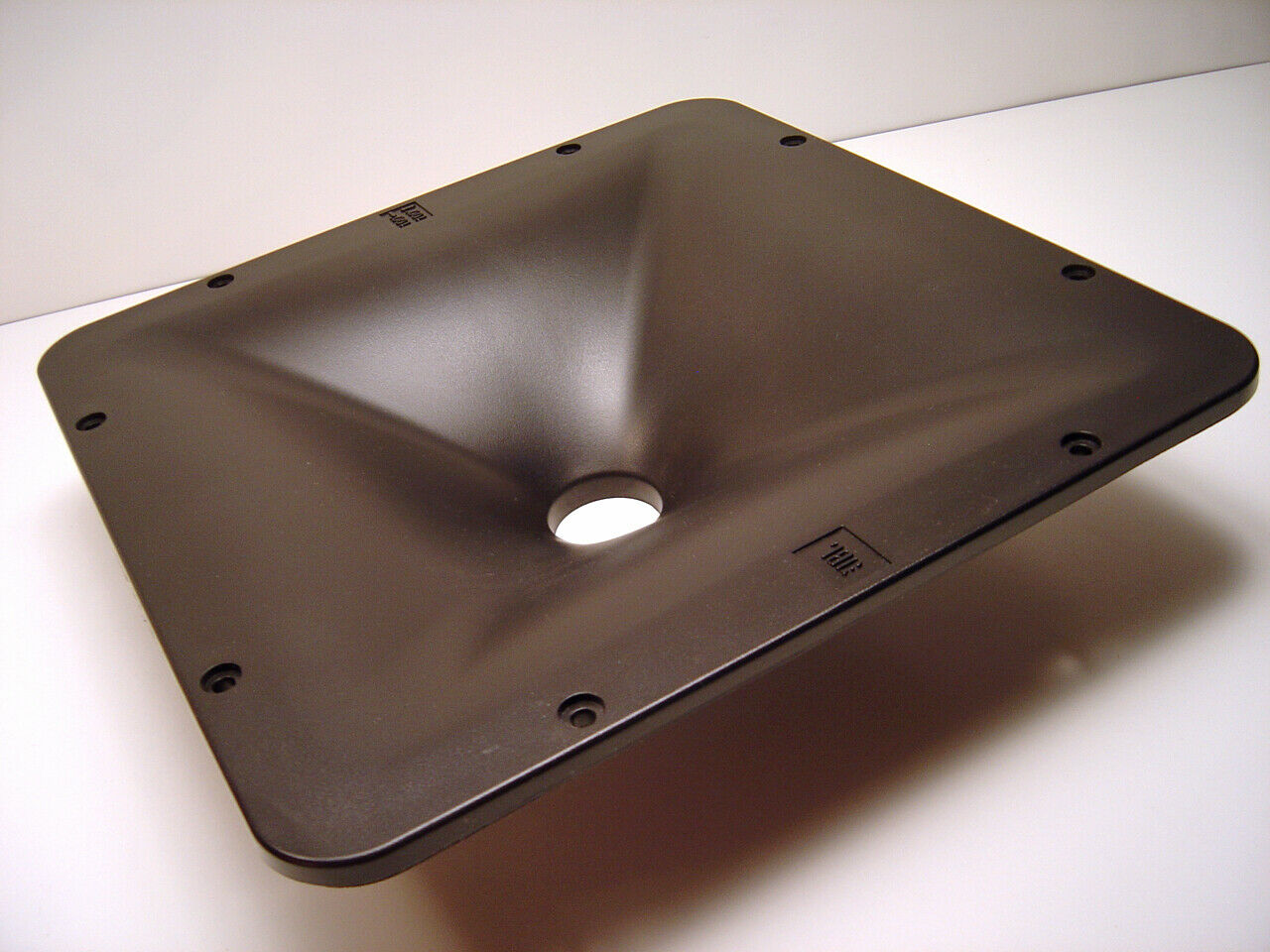

The familiar "X Shape" returns in the patent.
If anyone wants to build these for themselves, some things to note:
1) As noted in my last post, the "X shape" widens the pattern vertically *and* horizontally. I know this is counter intuitive, it would seem like an aperture would make things beam, but it doesn't. It widens them.
2) The six pointed star, elongated vertically, creates a wide horizontal beam and a narrow vertical beam.
3) If you wanted wide vertical and narrow horizontal, turn the aperture 90 degrees.

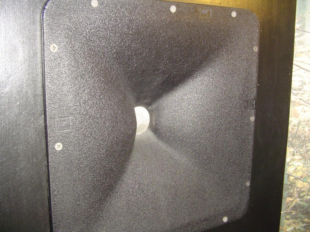

Here's a round horn. Since it's round, the pathlength from the throat to the mouth is equidistant across the entire horn.
Here's a square horn. Since it's square, the pathlength from the throat to the mouth is NOT equidistant across the entire horn. On the X and the Y axis, the pathlength is equal. On the diagonals, the pathlength is about 40.4% longer. See Pythogorean Theorem for more.
It wasn't immediately obvious to me, but the geometry of the Unitized Image Control Waveguides is designed to equalize the pathlength from the throat of the waveguide to the mouth. If you read up on the patents, Sprinkle makes this clear.
IE : The X and the Y axis are curved. The diagonals are (nearly) straight. Because the diagonals are straight, the lengths is "equalized" with the X and the Y axis.

Any idea how long this has been going on? This is a Progressive Waveguide circa 2002 has a definite resemblance to the M2 waveguide.

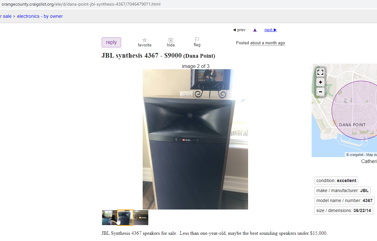

Is it worth to buy the jbl 4367 parts and make a clone thanks
IMHO, no.
For instance, you can buy a used set of 4367s for $9000. (See attached.)
The D2430K compression drivers are $1200 a pair.
I'm not aware of a way to purchase the woofers, but I'd assume they're around $1500 a pair, at least.
So once you go that route, and you build a cabinet, you're looking at an investment of around $3500ish.
The big factor, is whether you plan on having these speakers forever. If true, then you can build a set that's comparable to a 4367 for around $3500ish. But if we assume that you'll sell the speaker at some point down the line, it's going to be way easier to get most of your money back if you buy a real JBL 4367, versus a clone.
IE, nobody wants to buy DIY projects; if you invest $3500 in JBL 4367 clones, it's going to be challenging to get your money back.
YMMV
