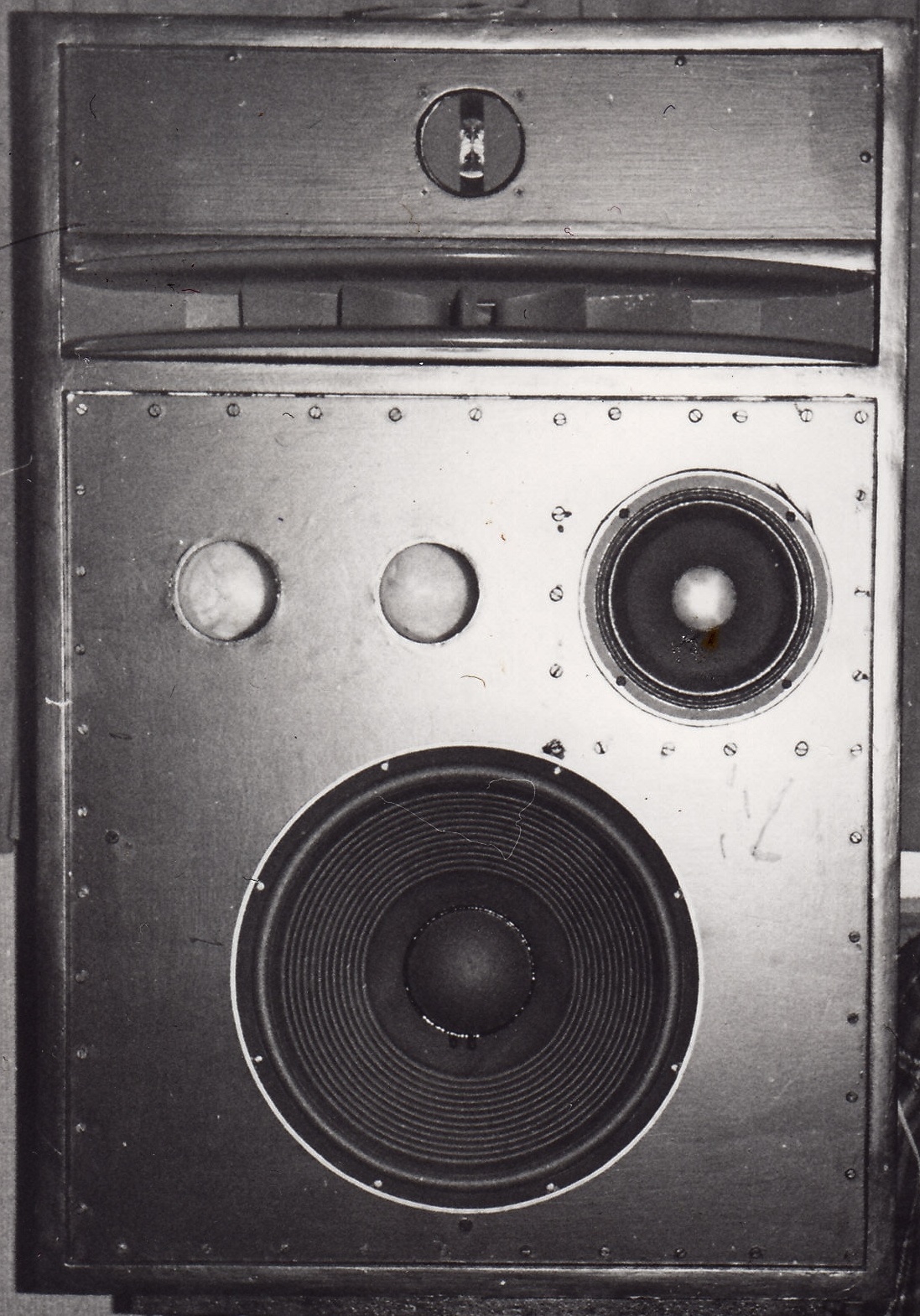

See picture of my JBL active 4way for not so poos from 1978. Ander Weckström (Gradient) calculated the cabin size on a HP calculator. I built an active crossover from drawings that I later found that KEF also had been using.

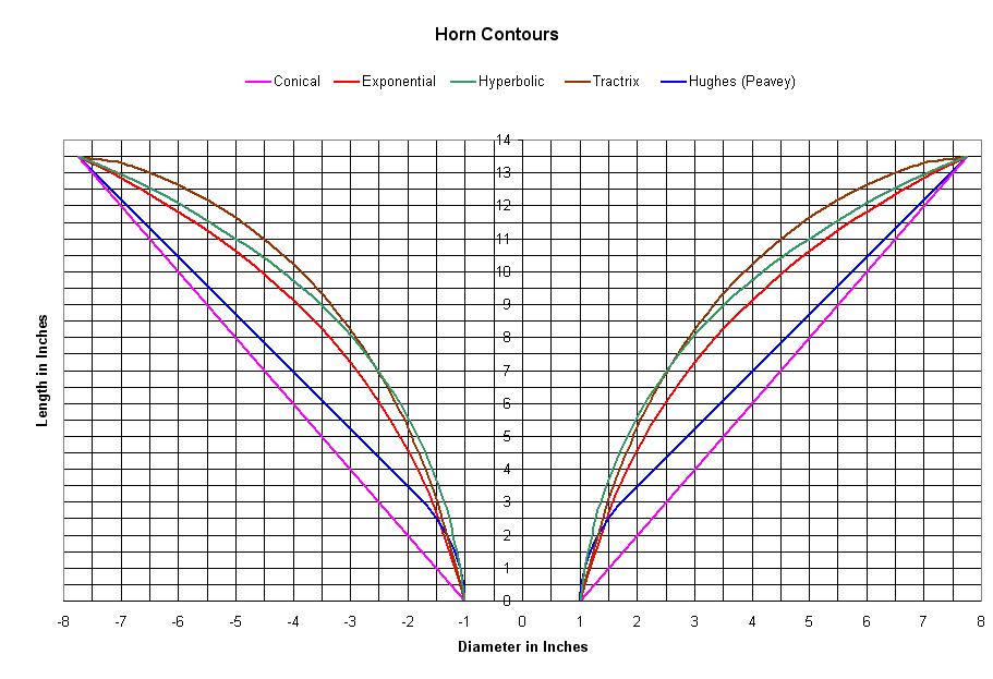

If you look at the oblate spheroidal curve, the entire point of it is to create a smooth transition from one angle to the next.
For instance, if a compression driver has an exit angle of zero degrees and a conical horn has an entrance angle of 90 degrees, there's going to be a discontinuity at the transition from throat to the waveguide.
In the old school diffraction horns, nobody paid any attention to diffraction, and that's why there are these sharp edges at the edge of the diffraction slot. These sharp edges create diffraction. That diffraction behaves like a second source delayed in time. This is really bad:
1) Because it's delayed in time, it screws up intelligibility
2) Because it's delayed in time, the radiation from diffraction off the sharp edge is out-of-phase (because of the delay) and that adds comb filtering to the overall response
3) Because it's delayed in time and the radiation is radiating from a different point in space than the driver itself, it screws up imaging.
Diffraction is just BAD NEWS.
Now, there's a simple "fix" for diffraction: just smooth down those sharp edges. And that's exactly what the OS curve does.
Mabat's software works the same way. But instead of "morphing" from a circular throat to a circular mouth, like the oblate spheroidal waveguide, Mabat's software allows you to morph from a circular throat to nearly any mouth shape you can imagine.
Does that make sense?

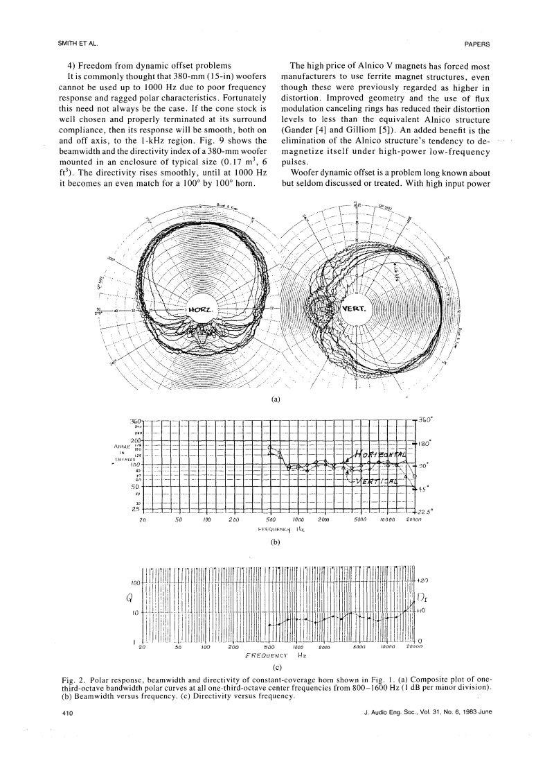

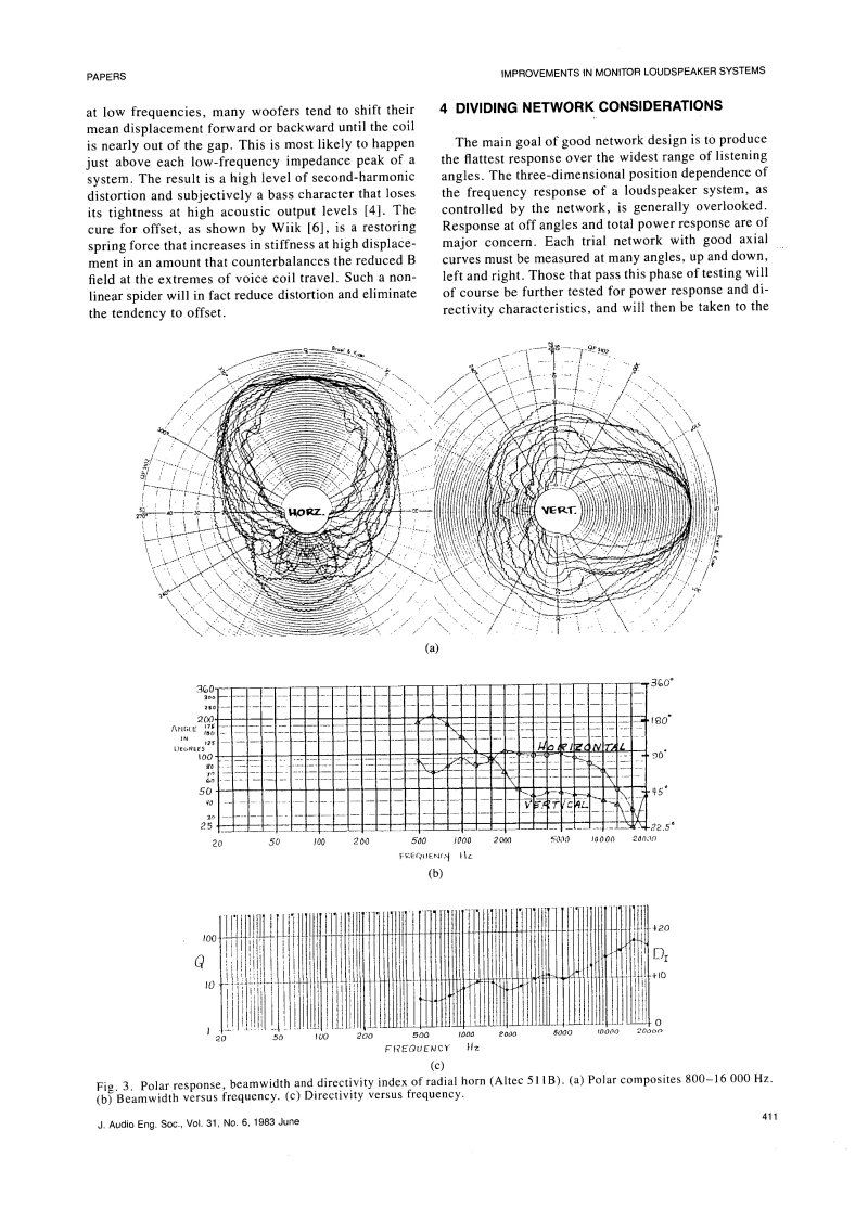

Hello Patrick
If all of the above is true how do you explain how even and uniform the polar response is and how free of lobbing the 2344 Butt Check horn polar plot is? Wouldn't you expect comb filtering to show in the polar plots? It's leaps and bounds better than the Altec 511 which is clearly not a CD diffraction horn.
Rob :)
Hello Patrick
Rob :)
