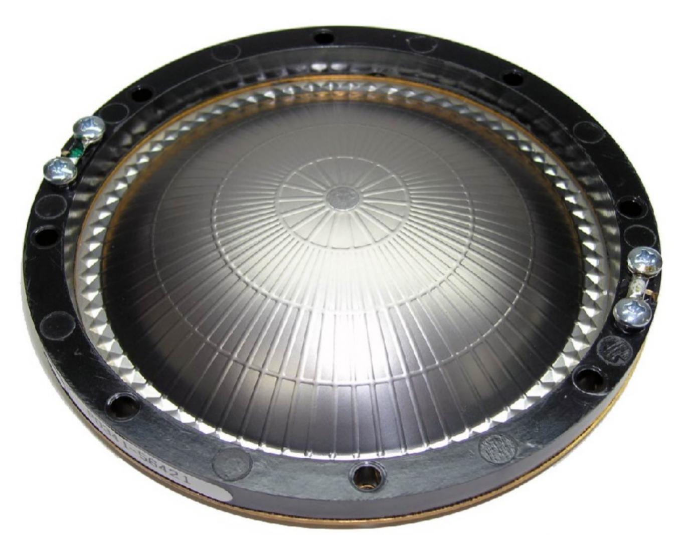

A 1" compression driver will generally have a surface area of about 15cm^2
A 1" tweeter will generally have a surface area of about 5.07cm^2
The big difference is that dome tweeters have a surround, so the xmax can be as much as 3-6x higher.
Similar to how domes outperform ribbons: the ribbon has higher efficiency, but the dome's displacement advantage wins if you need a low xover.

New BMS 5530/5531 ND 1" driver can be crossed at 850Hz if you have two. I assume that you can get away with just one if you play at home.

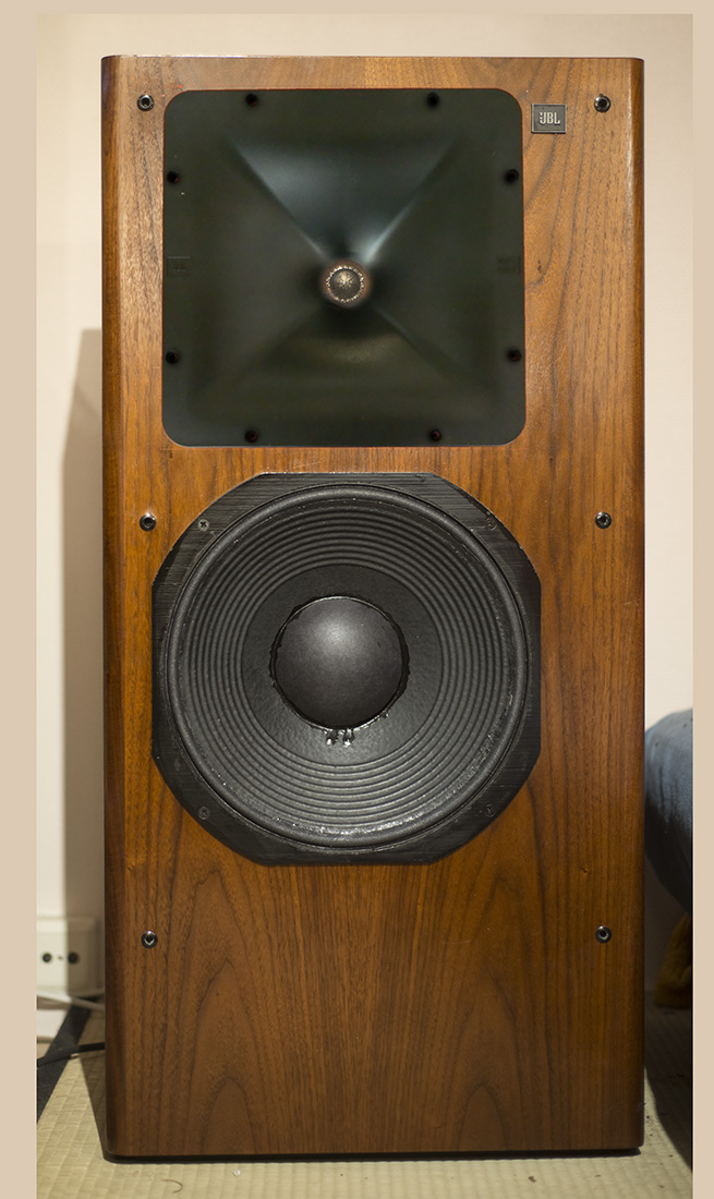

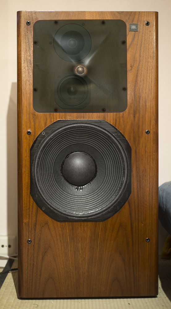

Ok, here's a suggestion from a friend. I have a set of JBL 240Ti. They have a nice LE14-H woofer, 104h mid and 044Ti tweeter. New to me, only a couple of months, so I'm just getting familiar with them. However, 044Tis have a damping foam plug behind the dome, that either shinks or crumbles with time, and they usually need service at some point. I'm sure this is familiar to many here.
The suggestion is to replace the mid and the tweeter with a 2450SL compression driver and a PTH1010HF-1 waveguide. As you see from the pictures, it would fit neatly in the box.
Optimally, this should be driven by DSP crossover and biamping. I have some budget suggestions available, but open to anything.
Another solution is to keep them passive and modify the network in the 240Tis, let them cross at 900hz as is, and let the 2450SLs play from there up. (Would need some attenuation).
Third is to try to restore the tweeters and keep them as they are, but that would be no poor mans M2... .
Sorry to say, my theoretical competance is beginners level and I'm getting in on the deep end. So, I'm interested in opinions, since you guys have lots of experience and knowledge. Would it work? Alternative driver choice? Waveguide? Crossover point?
Dagfinn

DSP is the only way to go if you want to be able to seek and find the best balance with whatever you put into the box.
2way "miniDSP 2x4" (minidsp.com) with suitable 4x power amplifiers is an easy solution. If you want to integrate DSP and power amplifiers in to the box then Hypex FA122 is an quality alternative.
Bee prepared to install some L-Pass on the compression driver as it is so sensitive that you will hear "hiss" from the amplifiers. I use L-Pads with about -15 db.
Download REW that is a free program to measure your setup. Mini DSP will sell you a suitable microphone. Just about everybody uses these.

The challenge with M2 type speaker is that they are 2 way. How can you extend up and down without leaving a hole in the middle?
JBL M2 has a horn and driver that can do it down to 800Hz. Also, the 15 driver can extend up in the middle but there will always be a problem with the physical reality that a big driver will start to beaming from 800Hz up.
So this leaves us with the question of which driver and horn to mate with the LE14-H woofer. And where to put the crossover frequency.
Here is a link to LE14H-3 driver tech info.
Here is information that shows that 240Ti has a crossover point at 900Hz.
So now the easy answer to witch horn would be the M2 horn. But it will not fit in the box.
So maybe one solution would be the JBL VTX F12/F15/STX825 horn that I have used. I however don't have a driver that can cross below 1000Hz. But there is forum writing to find where this horn has been used down to 800Hz with some of the 245X drivers.
Seek for JBL stuff here.
