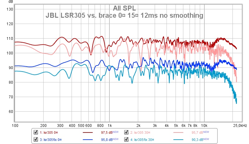

Juhazi, thanks for the write-up and measurements of your mod! I've been using these speakers for about 3 years and have been quite impressed, but i'm always looking for diy mods. I'll be trying this one soon.
Did you happen to get measurements for your cross braced cabs with the back plates installed? It would be nice to see an overlayed response graph of both the modded cab and the stock cab fully assembled. My apologies if you already did this.

I checked my measurements again, here better comparison of std vs. with center brace fix. Spl for distortion measurement is not equal - look at distortion details more than percentage!
In 0/30¤ response measurements diffrerences come mostly from slightly different position of speaker and microphone.
