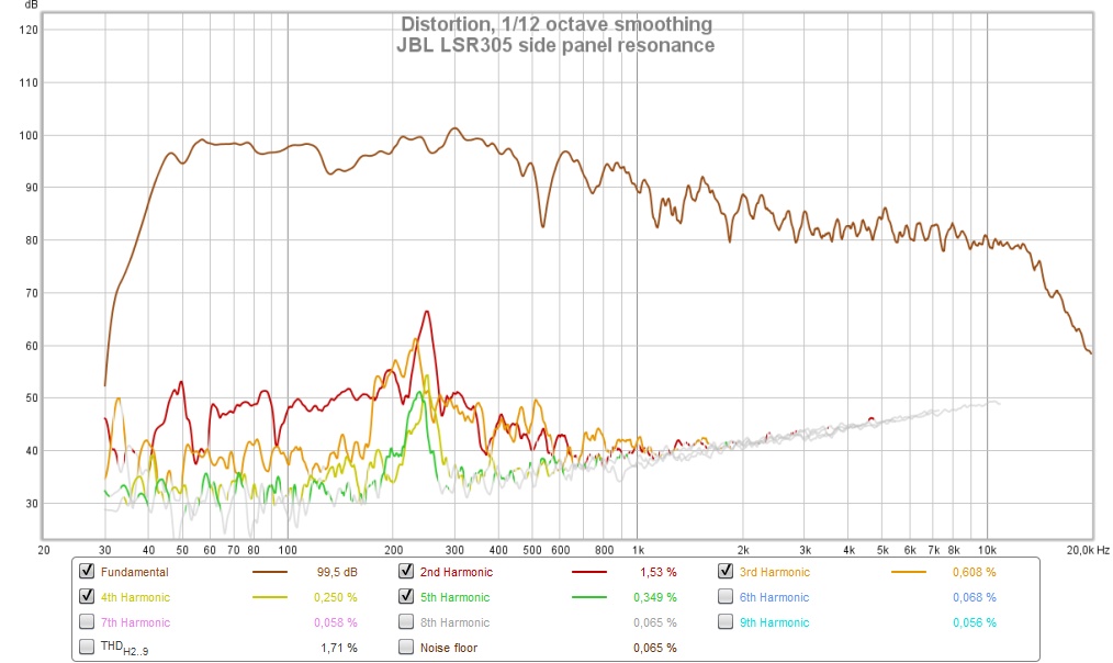

I ran some measurements and listened to a single speaker today. Measurements line up with noaudiophile well. Sound is very impressive but there is a strong coloration making them sound boxy, also knucle test result is poor. I put the mic almost in contact with panel and every measurement showed strong distortion around 240Hz. It is obviously a 1/1 wall resonance based on height of the cabinet. --> http://semimac.org/wp-content/uploa...-Vibration-Analysis-Loudspeaker-Enclosure.pdf

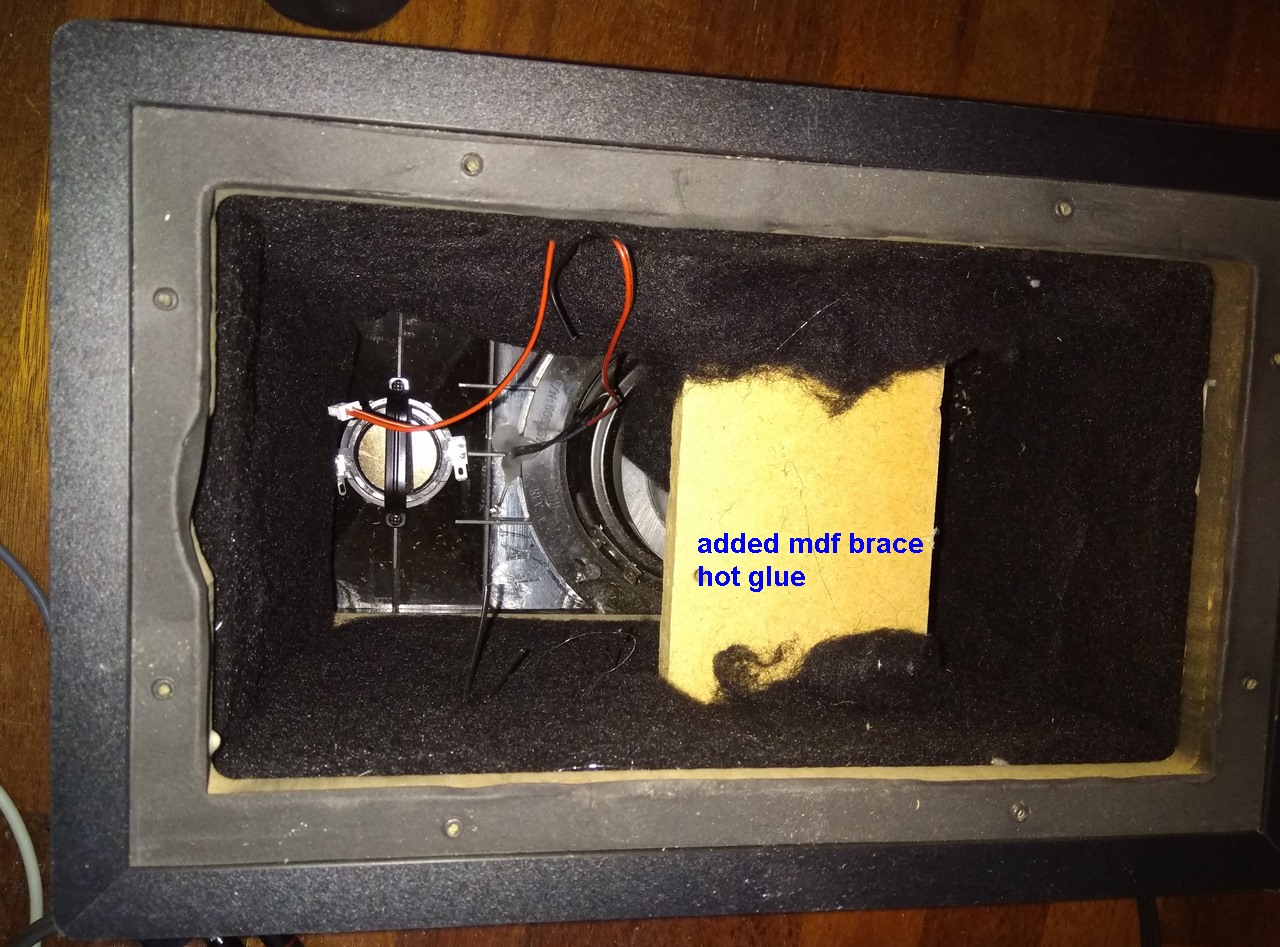

Internal cross-bracing should kill that well, I'll try that during next days and report my findings!

I use UMIK-1 and REW. For this resonance test I held the mic's foam-covered head in contact with the panel. The metal body didn't touch panel. I played a normal sweep at same spl level as in other measurements (roughly 85-90dB/1m)
The amps are not terribly effective and like XRK said, bass gets stressed easily. Normal mesurements show remarkable distortion below 400Hz. Some of it may be resonance-based, but it is not as peaky as the panel measurement.

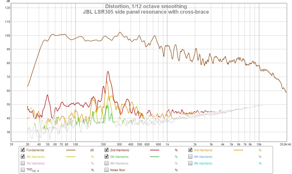

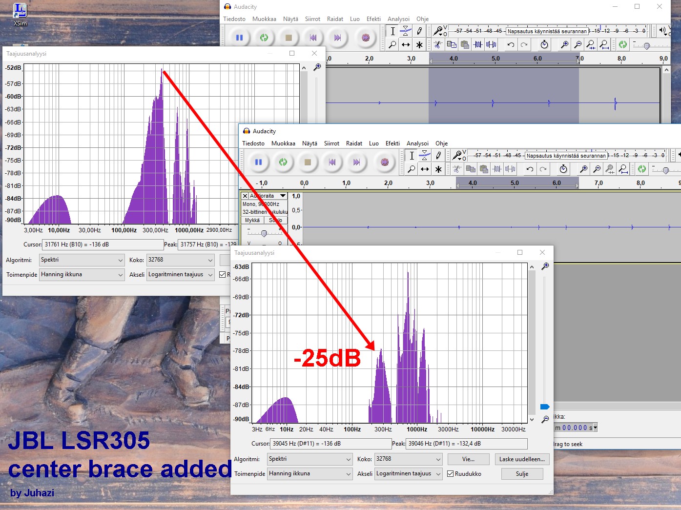

An internal cross-brace made -25dB reduction in resonant sound, measured with backplate opened and knockin the side panel. Distortion peak measured at 60m (2') was reduced too. Me happy for solid 1 hour "work" on these. I hope that my daughter willl be happy too for her new desktop speakers!

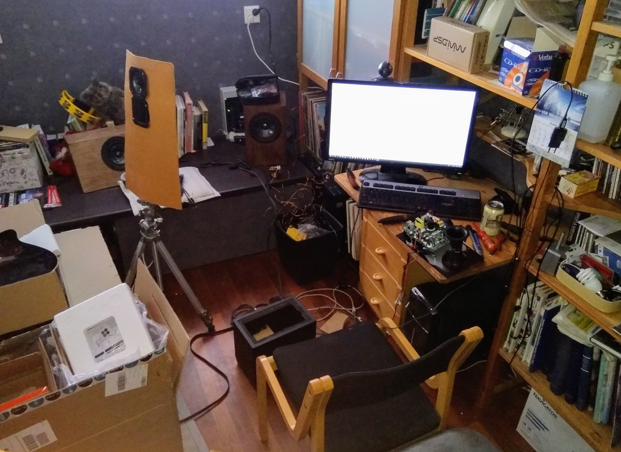

Great work with the brace and love your workspace. :) And it's not like hot glue is even that intimate of a bond. (maybe playing a damping role?)

So I used Audacity to analyze sound of knocking the cabinet. My calibrated UMIK-1 microphone was the source and recording was set to mono 16-bit. The opened cabinet was laying on the carpet, I held the mic's head on level with the open back and knocked the sidewall of cabinet with my midfinger knuckle several times.
Then I painted several knocks in the soundstream window and clicked "Analyze" and "Spectrum" to get spl/f graphics. You can adjust parameters of analyzer if you want, more samples means more low end and resolution.
The problem is that knocks aren't equal, but taking several knocks in analysis will make sort of averaging.
I have learned this myself and I use this or modified methods for several other purposes too. The challenge is to make it reliable/repeateble. Nice to check the sound of different guitars this way! Some luthiers use this kind of method too and there are several published articles.
