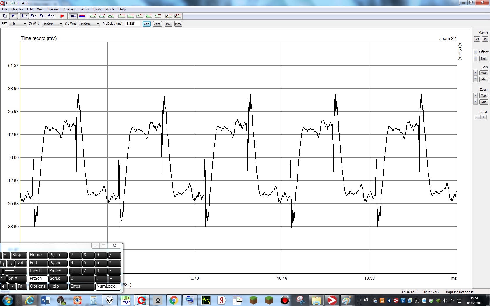

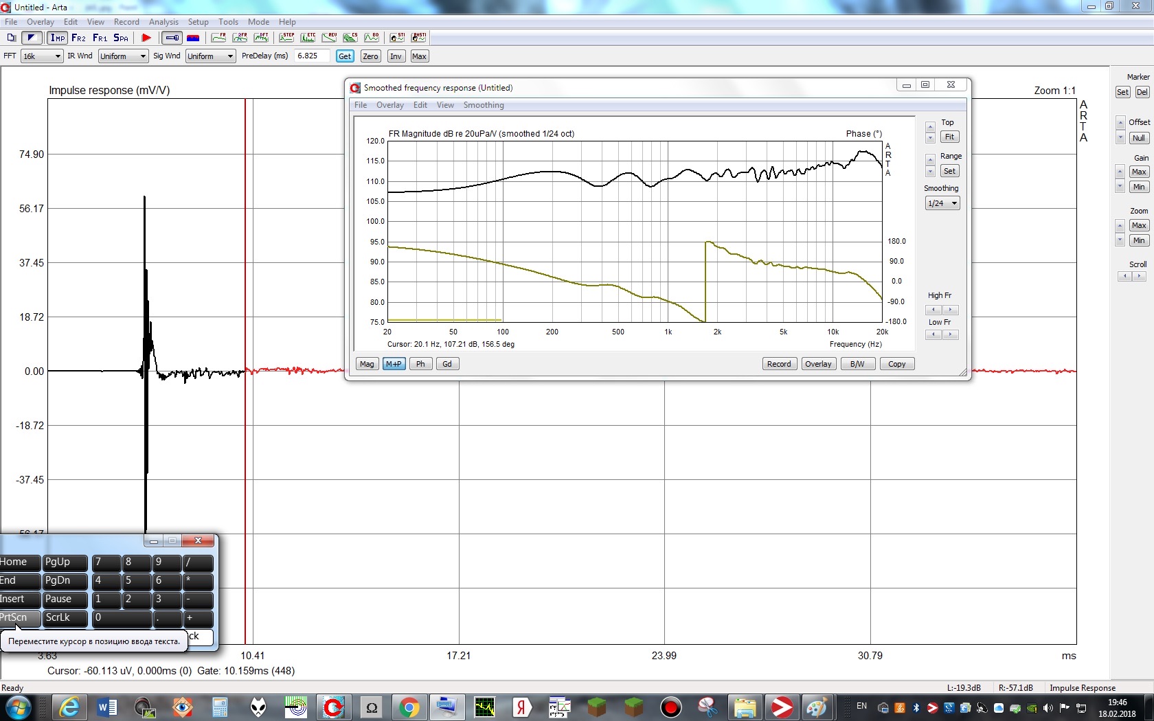

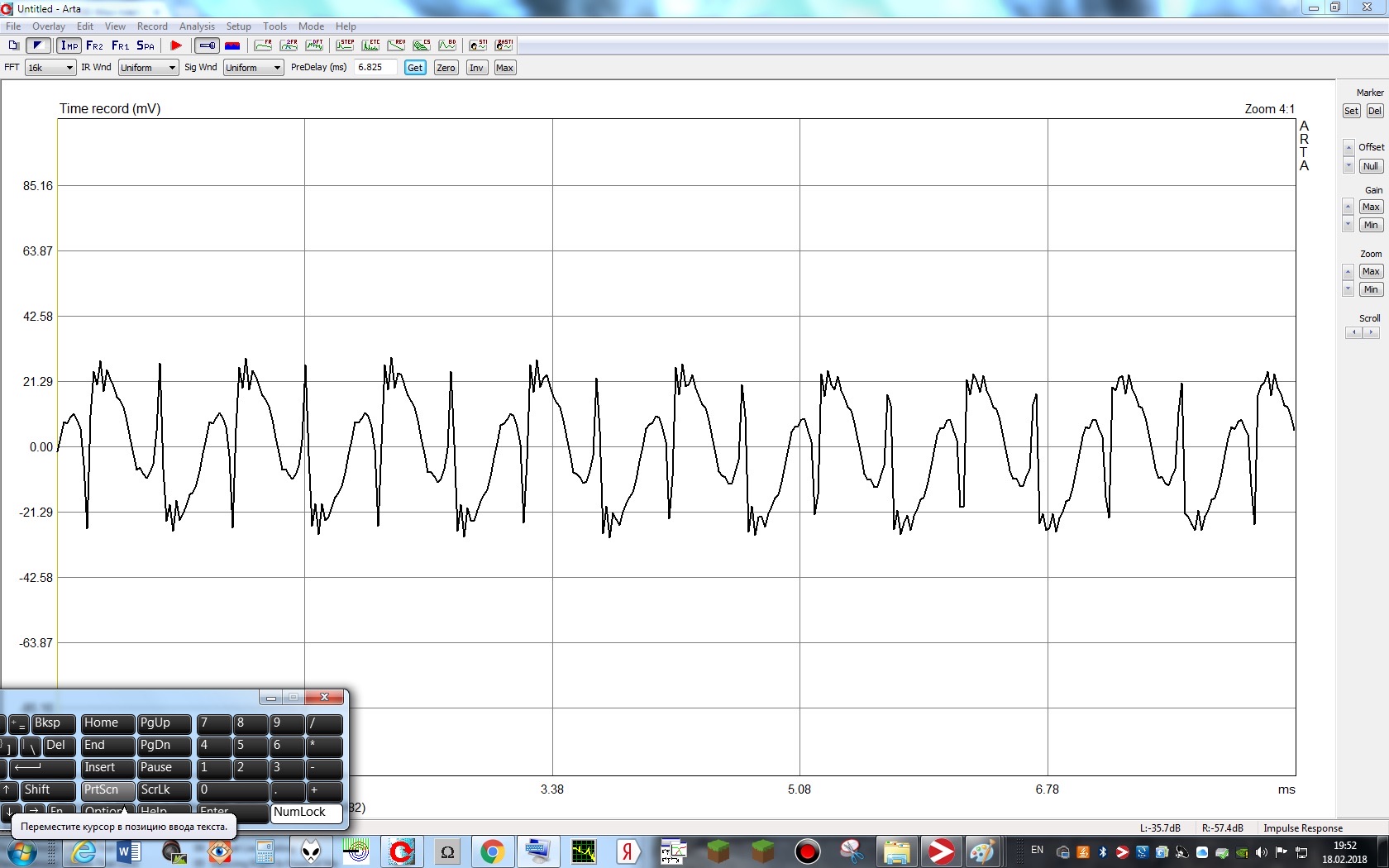

This file will make LSR305 transient perfect when playing from Foobar.
Download "convolver" for Foobar and put this file "FIR.wav" to it.
After that 305's will play meander and will have ideal Step response when playing from Foobar.

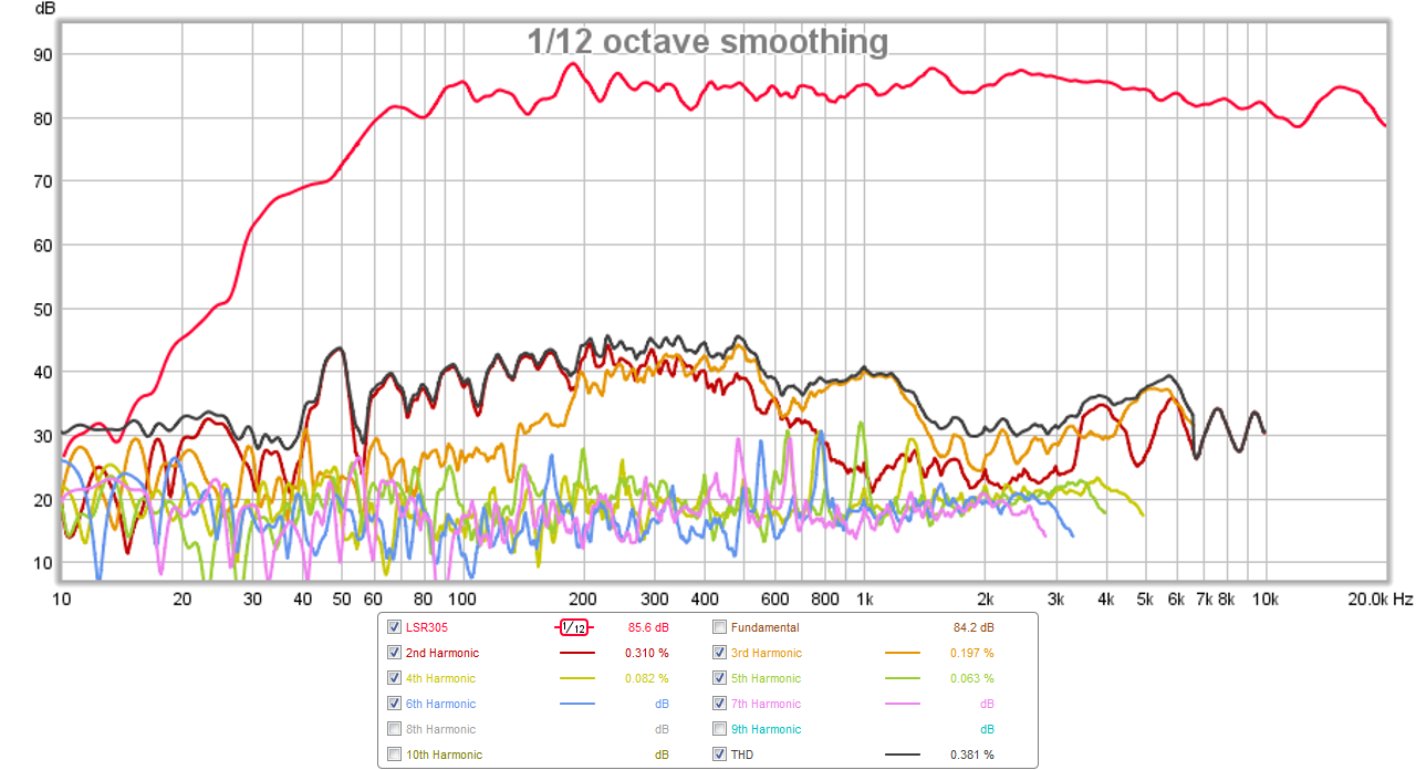

I did not have peaky distortion rattle on the LSR305’s I measured but a broad hump - looks like panel resonances which dominate though. The 3rd harmonic from 200hz to 600Hz is especially troubling.
It was a bit disappointing considering all the rave 5 star reviews I read prior to buying them. Also, the published response was flat - not waivering like this.

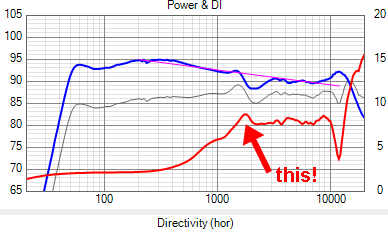

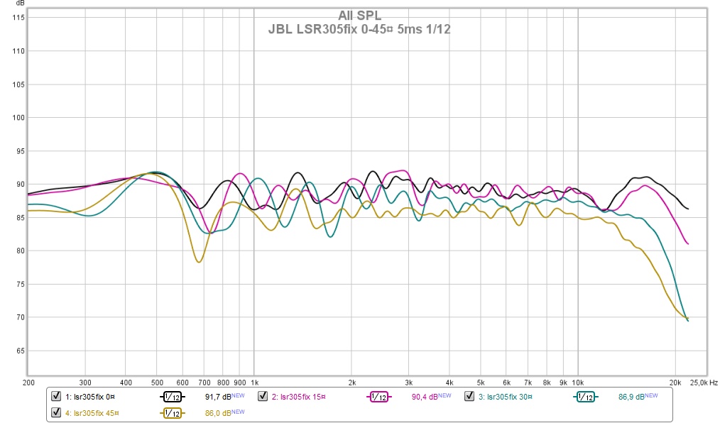

kimmosto,what do you think is causing that wiggle in directivity xo ? Xo is LR4 @1700Hz

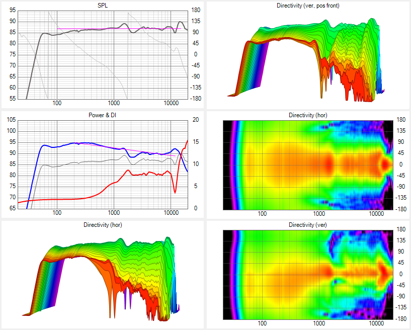

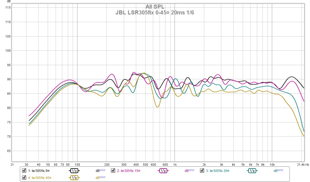

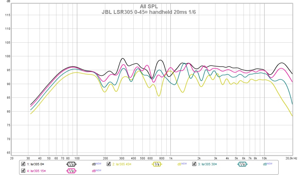

Here some more of my reasurements before and after tweaking. All done quick and dirty in mancave, mic held by hand and angles estimated visually.

Forgot to say that before and after tweak measurements are from different units.

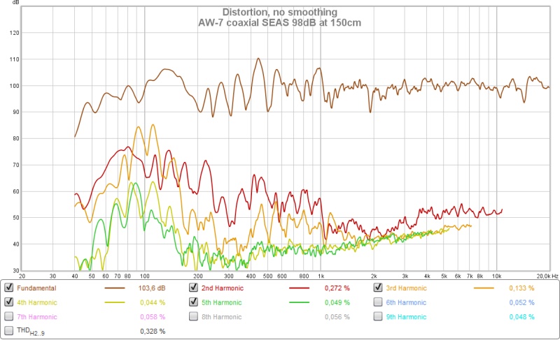

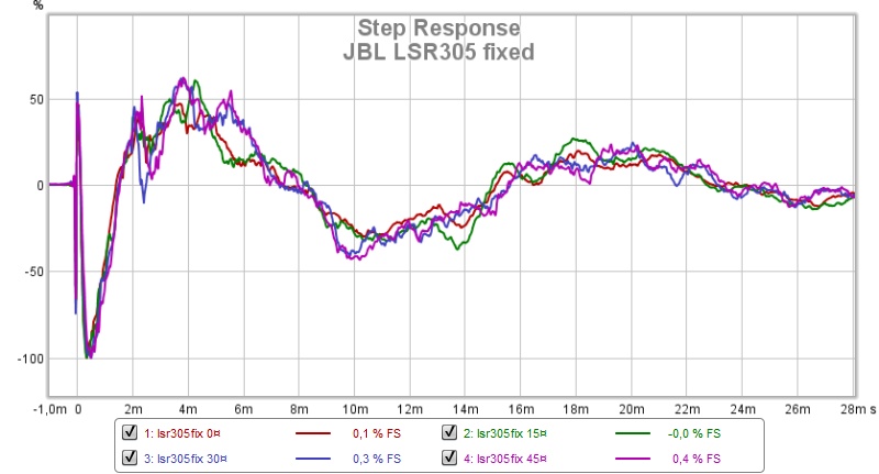

Here distortion measurements of a fixed unit. For comparison a diy SEAS 18-Coaxial in a 24mm MDF closed cabinet of almost same size.

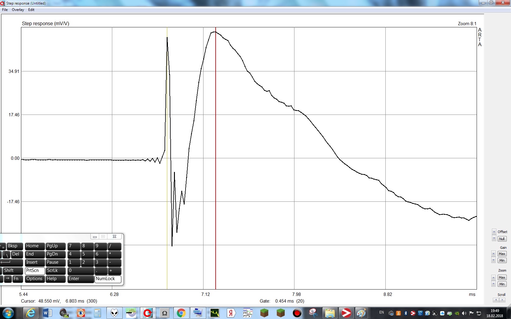

Also step response of LSR

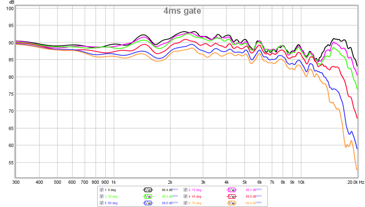

My directivity measurements show that the waveguide does an excellent job. The wiggle neat 1700Hz is the crossover point - I guess they don't have the time alignment dialed in well enough that there is cancellation in what I assume is an even order XO. It is all DSP so not sure what it really is without surgery thereby voiding ability to return.
