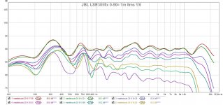

That is not "horizontal DI". It is directivity index which is calculated in both planes, and the wiggle is coming from vertical plane - as already told.
OK, but the headline of the graphics I quoted is "Directivity (hor)" Misleading!

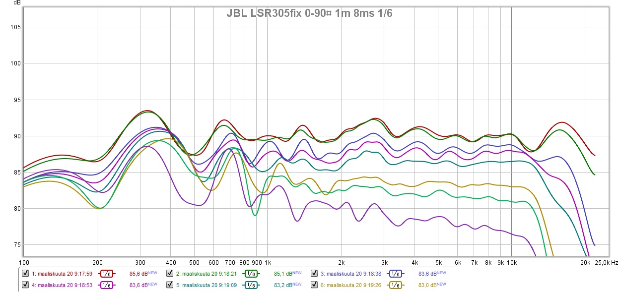

Xrk, my guess too is that not-so-perfect time alignment and not-so-perfect slopes are causing most of the response wiggles around xo. LR4 makes narrow transition zone, perhaps softer LR2 might give smoother responses.

I am planning to use a 4" mid with this waveguide and cross it around 3,5-4kHz. I have a pair of Peerless neo/aluminium domes. Well, now I have these 305s to be used as models. If or when I make a mold/cast, tweaking of it's shape begins! Children's plastic clay or plumber's putty can be used for testing different shapes. Suitable recession is also important, to get timing to match as well as possible

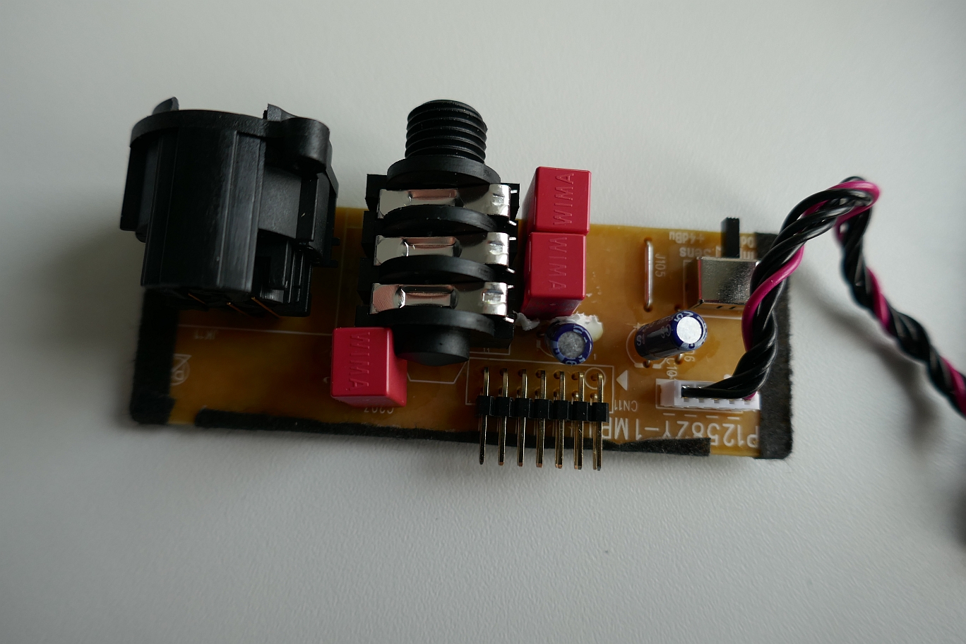

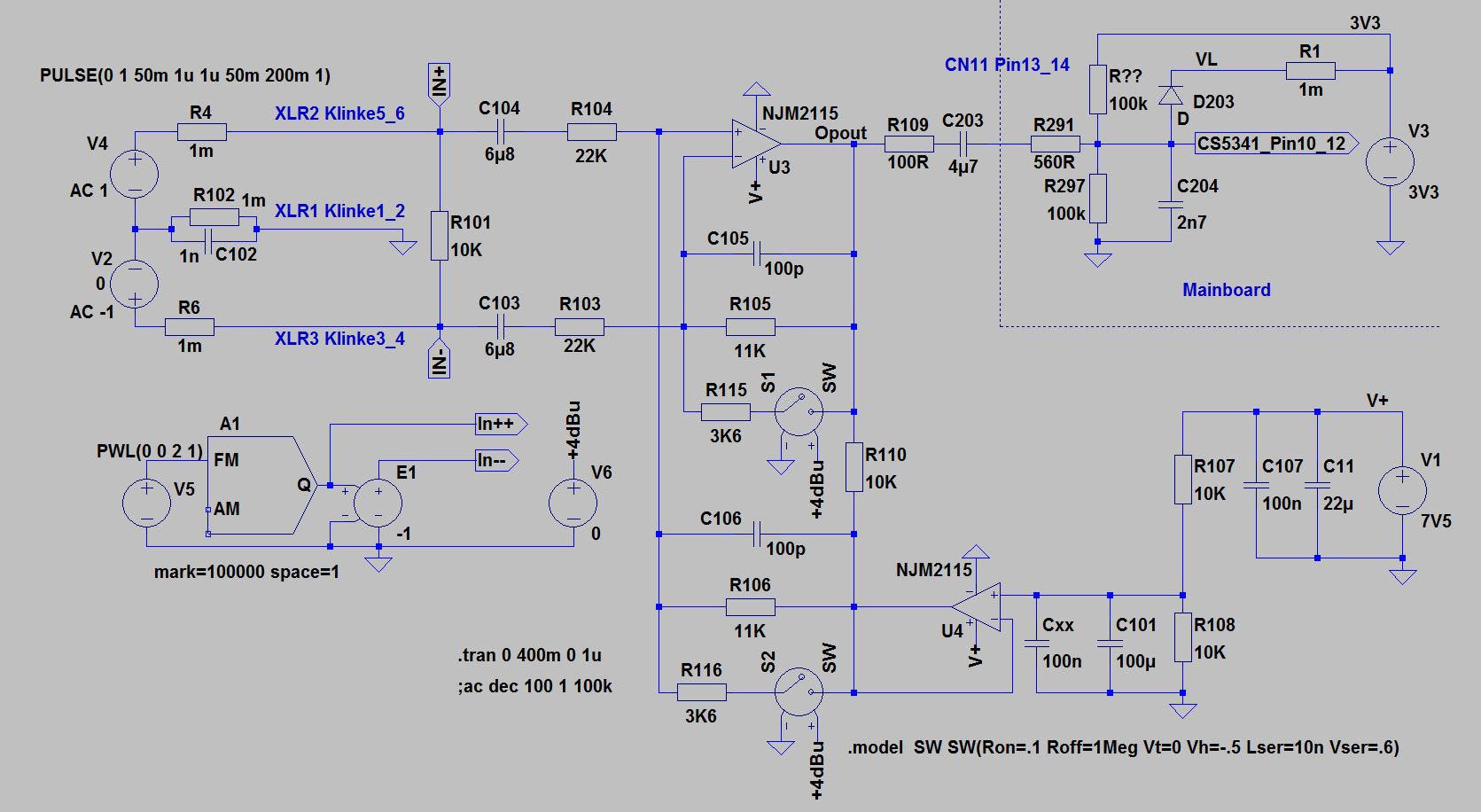

For those who want to look a little deeper into Electronics I have extracted Schematic from Analog section.
- Coupling Capacitors to Opamp are Electrolytic Type 100uf. I do not believe
that Film Caps sound better. Nevertheless I changed them because of
reliability. I had already several Electrolythical caps in the past which get
"dry" with the time. Attached Picture shows Wima Foil caps with 6,8uF.
Space is very limited, bending of Lead wires is necessary.
- OPamp Mod. Used OPamp is NJM2115. I did not change because I do not
believe in Sound difference of OPamps.
Mods that have effect on Sound:

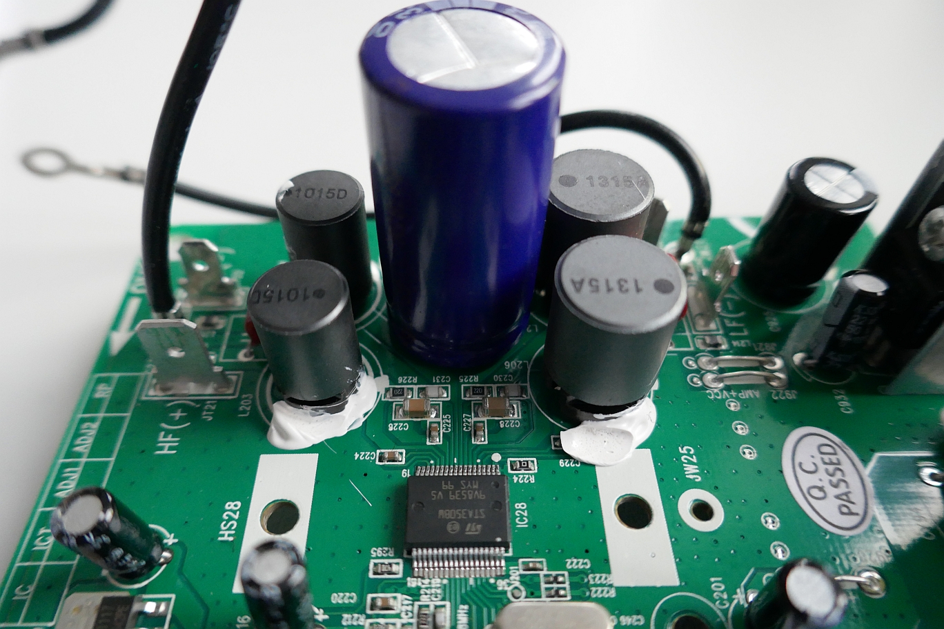

- Buffer capacitor change of STA350BW changed form 1000uF/35V to
4700uf/35V (Dark Blue Capacitor, please refer to attached picture)

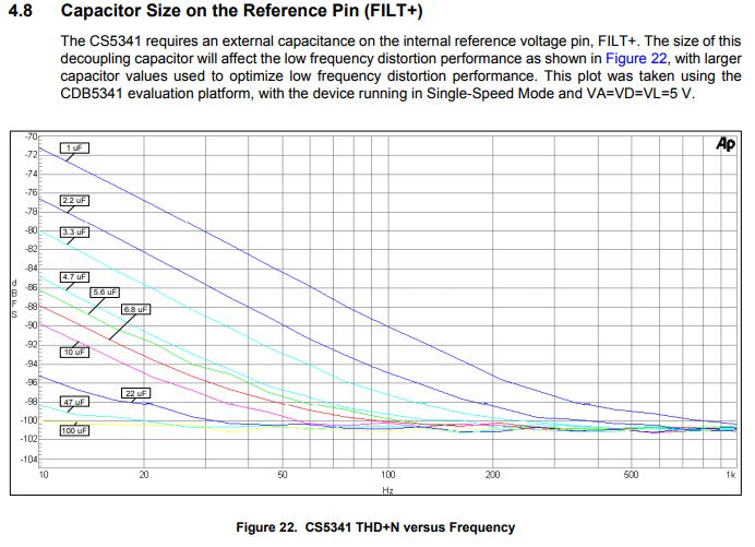

- Capacitor on Filt+ Pin of CS5341 AD Converter:
According to latest Datasheet of CS5341 100uF decreases Distortion Level
at low Frequencies dramatical compared to used 1uf in current PCBA
(Light blue capacitor, please refer to attached picture)
How does it sound compared to unmodified Electronic:
More Punch and cleaner sound. Test it

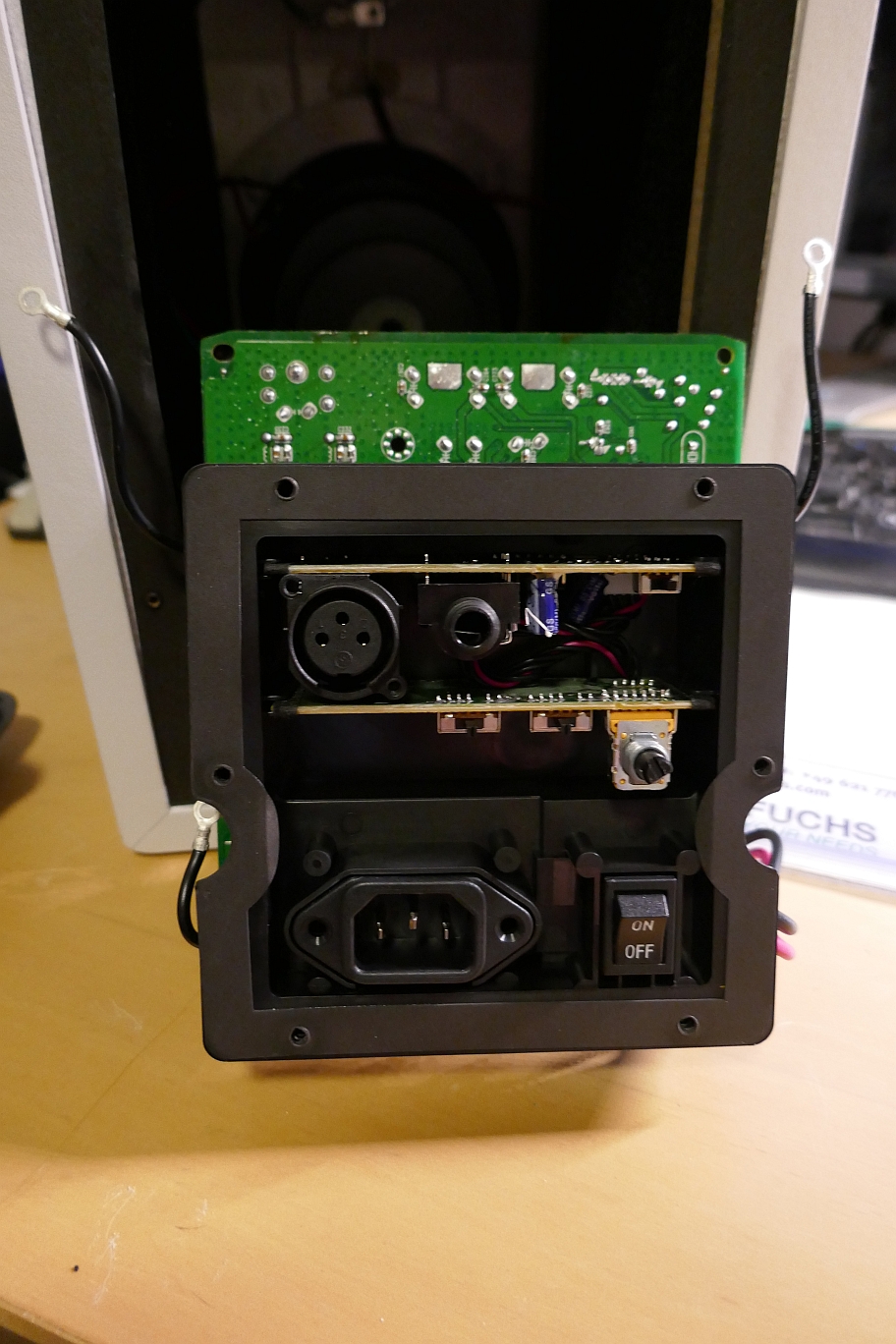

Some hints for assembly:
- It is not easy to assemble "Analog section back to mainboard. Therefore
suggestion is to assemble first black cover of Analog section and then slot
in Analog electronic with visual inspection if all Pins are in right connector
inserted. It is possible to shift to left and right by one.
Have fun
Eljo

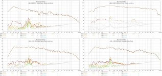

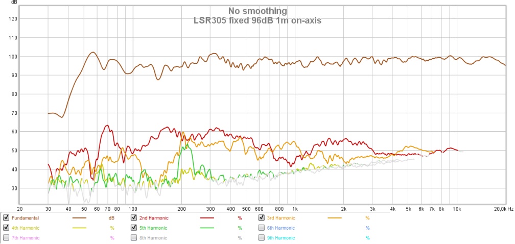

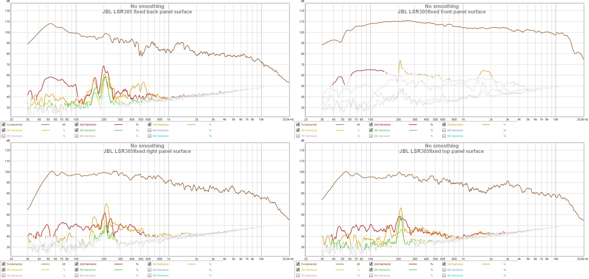

I made some better quality measurements. This is a really nice active speaker for the price! Well worth opening and adding a cross-brace!
Do you have any ideas why bracing smoothed frequency response, but increased distortion?
Yes I do. Because those two measurements are not directly comparable at all! They were taken in different environment, different distance, different signal level. First one was just a quickie because cabinet resonance was so annoying that I had to do something any way. Posting those findings occurred to my mind later on. The "better" measurement was done by my own stardard procedure and environment.
