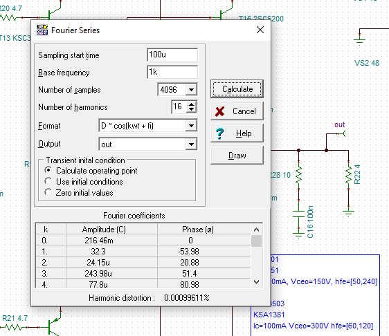

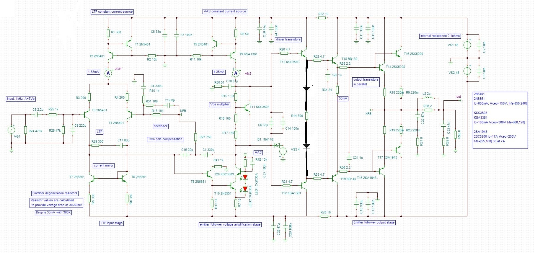

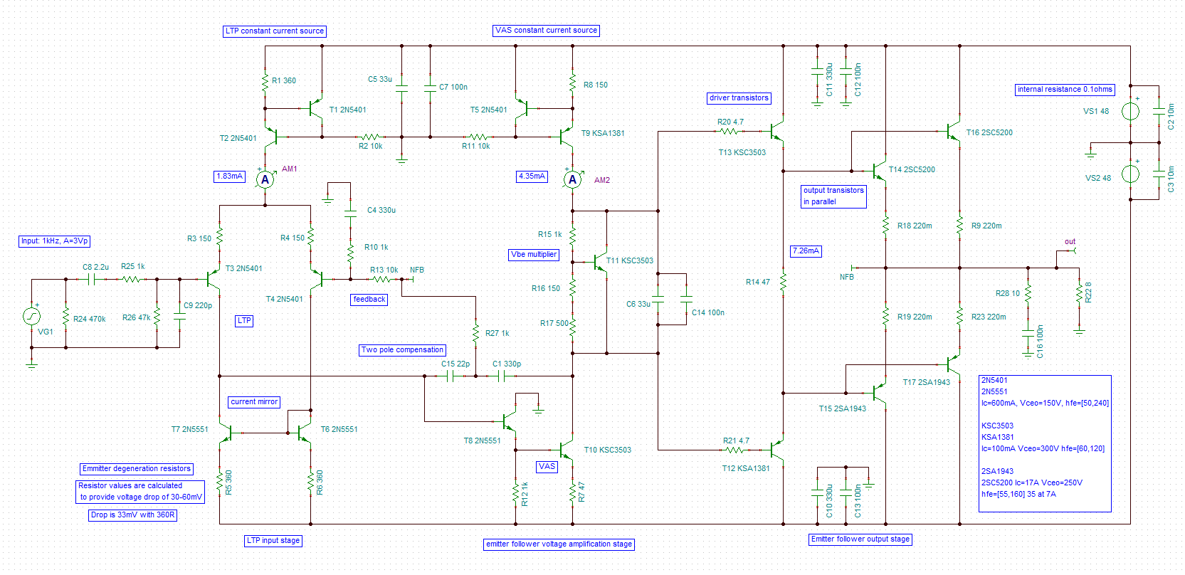

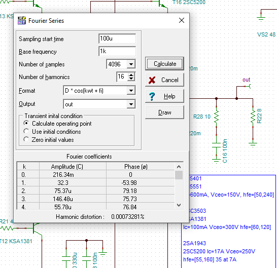

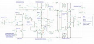

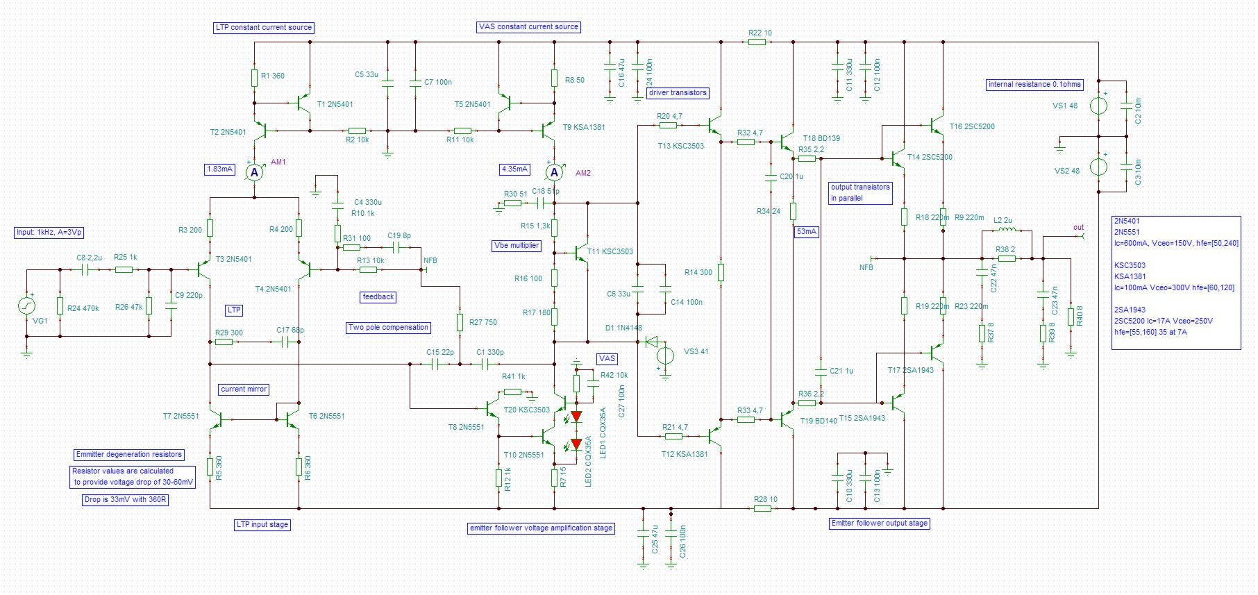

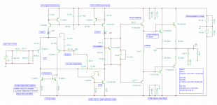

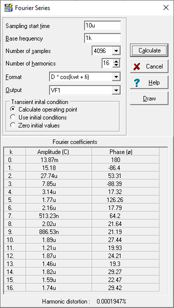

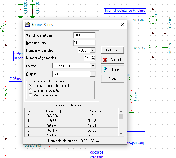

JAT501 simulated using TINA TI and possible improvements
Removing paralleled output transistors actually makes it JAT501 with added one extra transistor (not counting ccs) and two pole compensation parts.
thd improved to 0.0014%
  • jat501-improved-sch-v2-OPS-not paralelled.zip

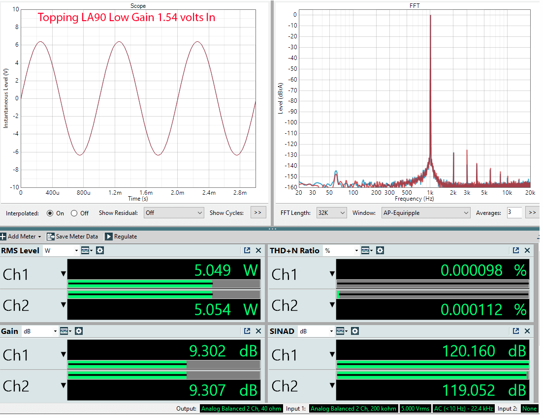

Might be, there is few tricks
Keep the amplifier gain low.
Composite amplifier. Dual Diff , Complementary Cascode Vas
Or yes Power section is basically a follower. So if you can add feedback
/error correction around the output section.
even just Direct coupled or no capacitors in feedback.
Lots of ways to do it.
I can direct couple the simple amp I posted earlier
and set the gain very low. Which does it at 1 kHz
Distortion is -86 dB at that point
at high frequency, probably not, closer to .003%
which puts highest harmonic about -70 dB
Additional feedback / error comp would likely do it.
With preamp and tone filters and highpass for sub.
its rather pointless to care. distortion is meaningless
at that point. with CD playback or bluetooth stream.
blah.. distortion way above even a simple amp.

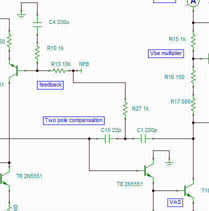

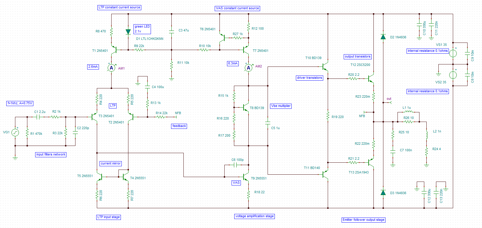

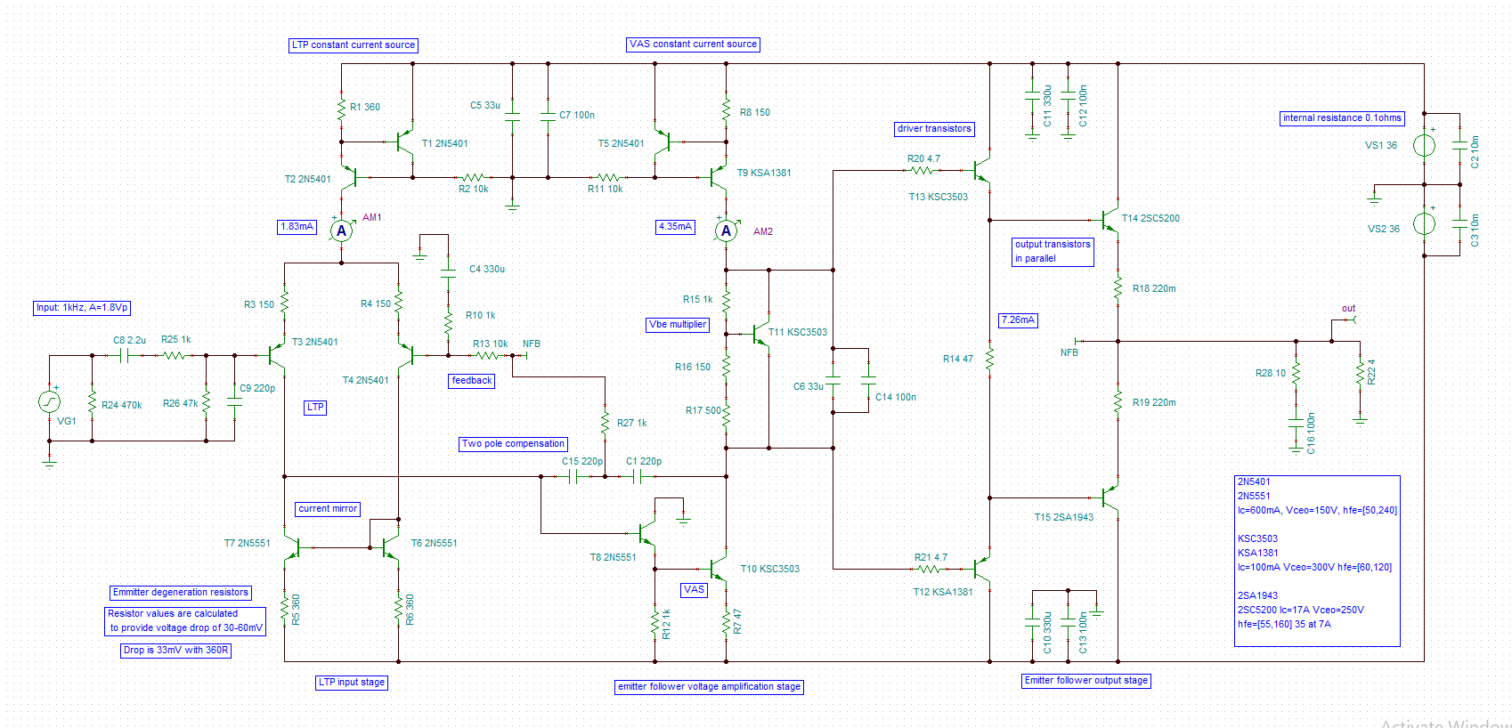

Playing with two pole compensation values here.
Looks like C15 values are best in the range of 15p to 100p
C1 values 220p to 1000p
and resistor > 1k
As it is, 22p and 220p, the ratio of capacitors of 10 gives best distortion performance

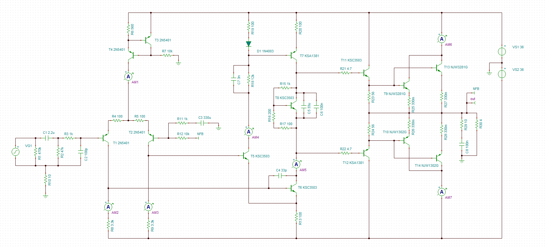

Doing a very simple model , and comically tossing in a diode
bias string LOL. This classic topology below will perform same results
or better, with tremendous reduction in parts count.

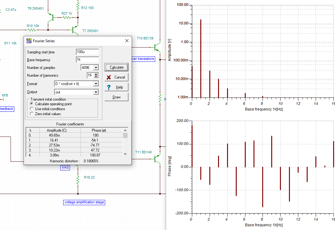

How did you get such low distortion?
I have put it together, but I can only manage 0.04
