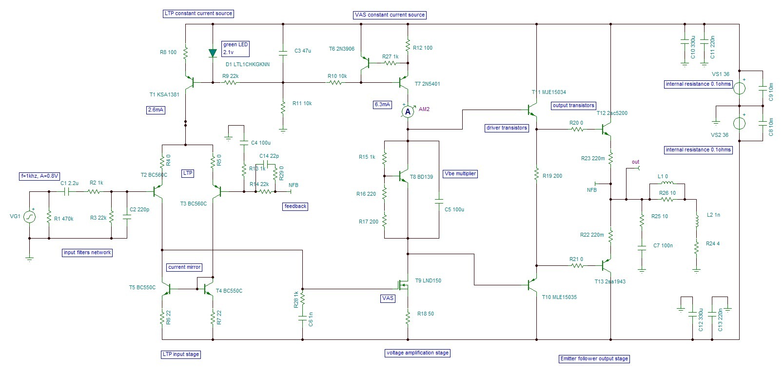

JAT501 simulated using TINA TI and possible improvements

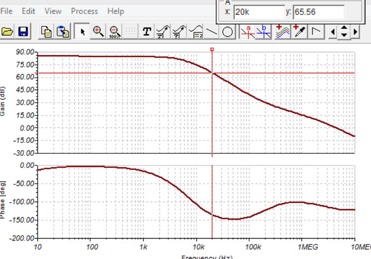

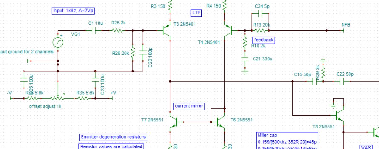

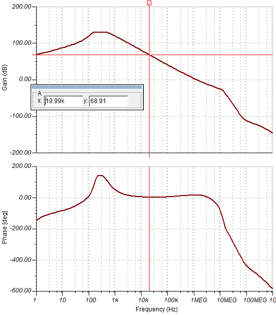

This capacitor is called lead as is leads the phase. It dates the tube Era. It is also possible to add a series resistor to C15 so that when the second pole starts, it gets a zero and let's the second pole act alone for a while.
When you run the AC anaysis, you can see the phase margins.

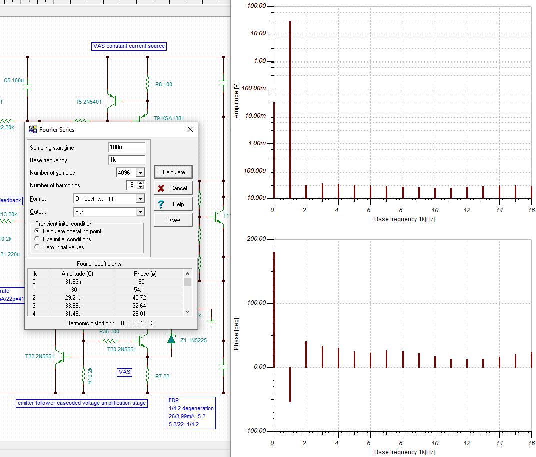

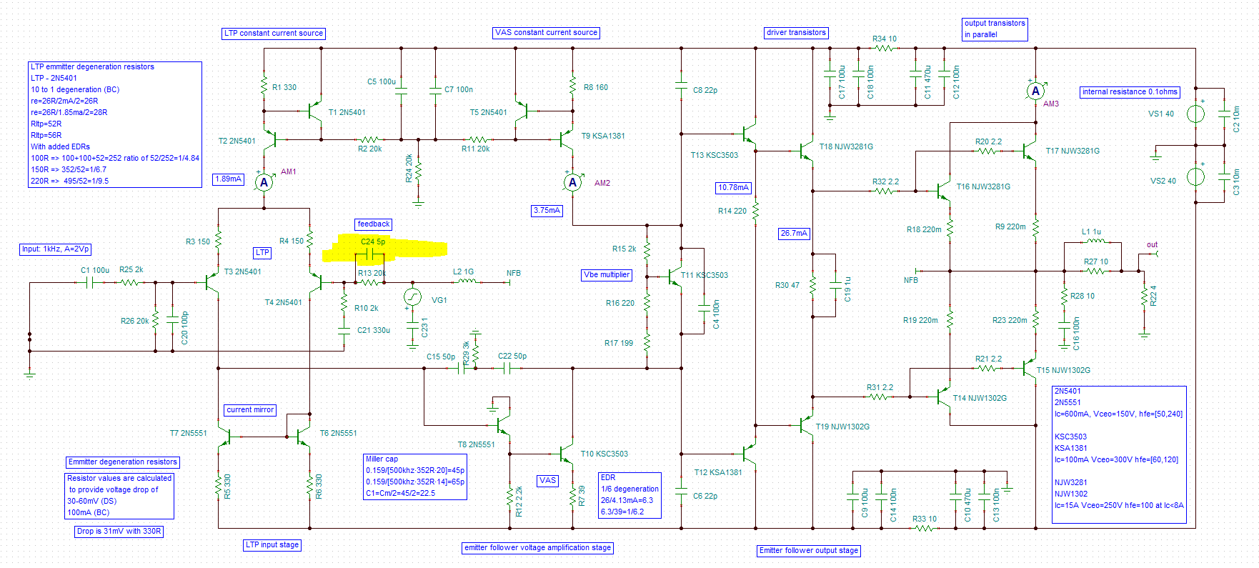

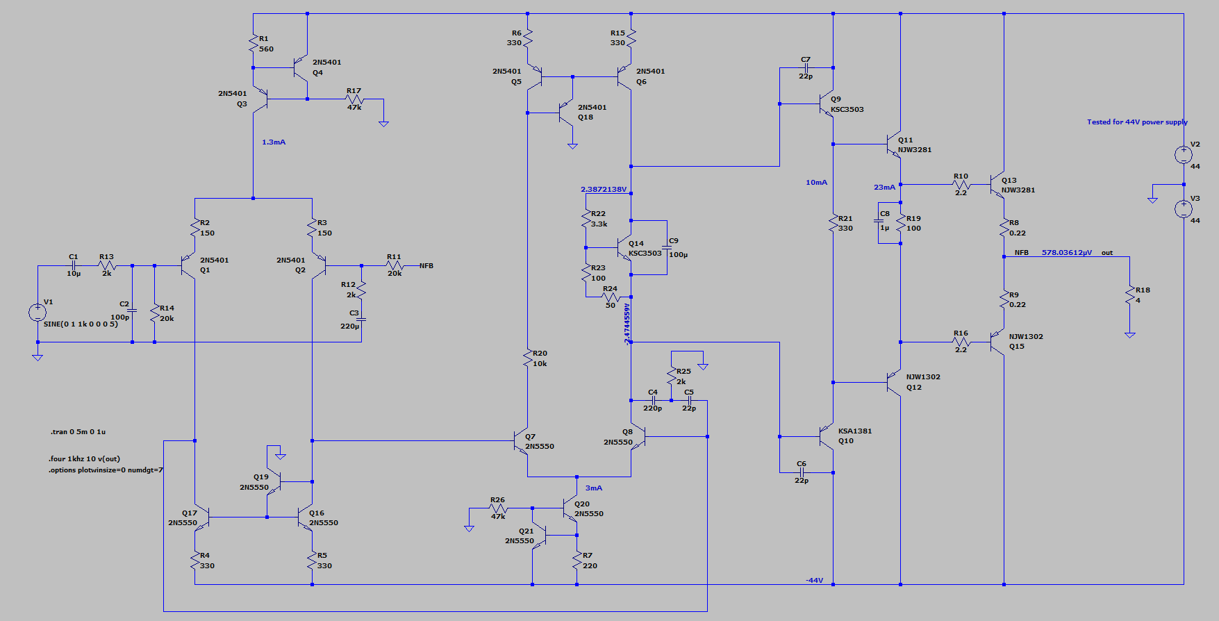

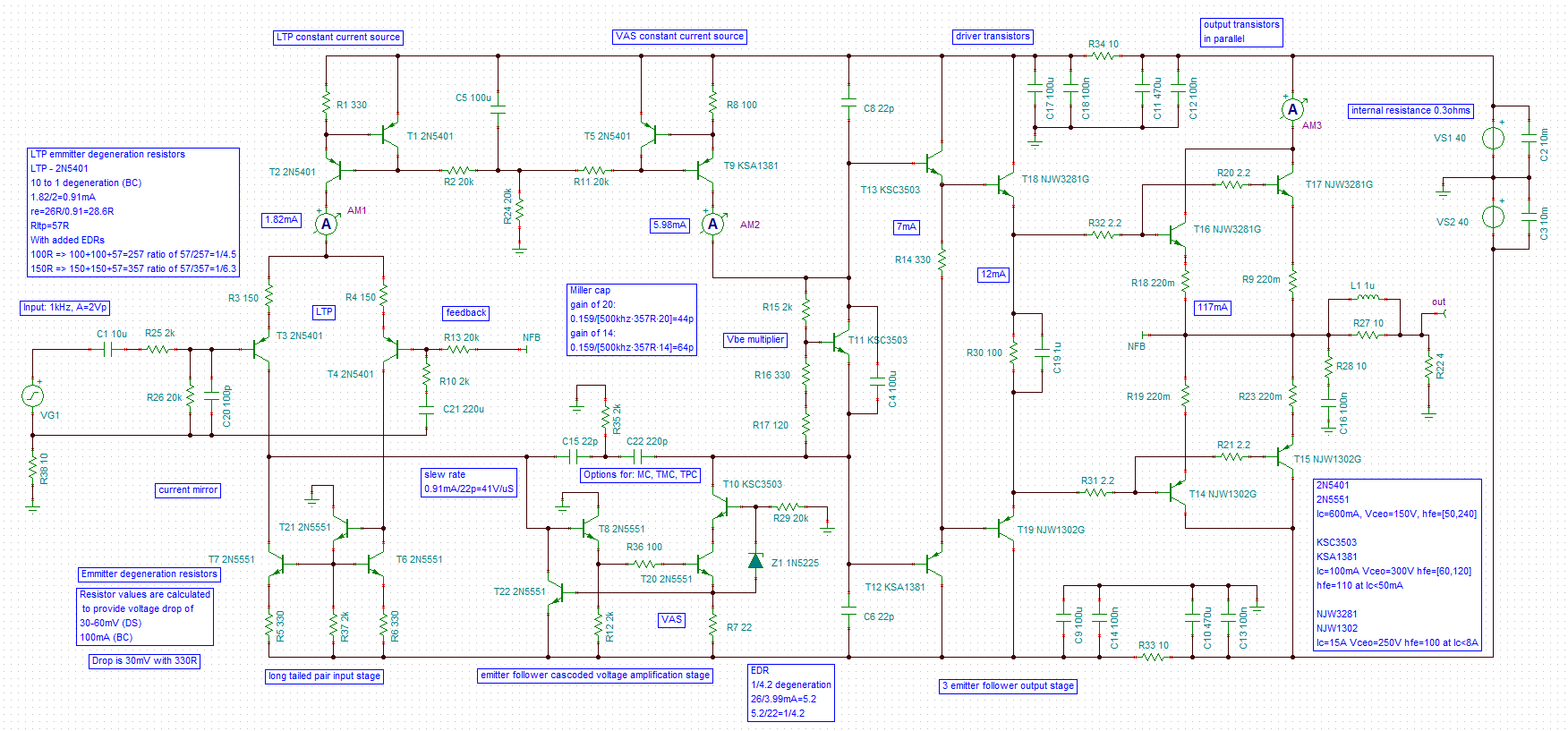

Here is the latest revision - added helper transistor to the current mirror and clipping transistor to VAS. See attached.
I wonder if 2n5551 and 2n5401 are the best transistors for the job?
I have been looking at this KSA992 and it seems like it has crazy hfe of 500 comparing to around 150 for 2n5401.
I am planning on using SMD parts for IPS and partially for VAS. Here are parts that I found:
Dual matched 5401 and 5551:
FMBM5401
FMBM5551
Single 5401 and 5551:
MMBT5401
MMBT5551
I am also considering SMD version of KSA992:
FJV992
And it looks like MPSA42 is great for VAS so I have found SMD version for that one:
MMBTA42
Other decent hfe at 65V SMD transistors are:
BC856BW
BC846BW
Dual / current gain matched versions:
BC856BS
BC846BS
And medium power
BCP53-16HX
BCP56-16HX

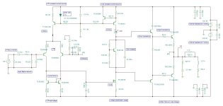

You have diverged too far to be still called JAD50. I did a quick sketch of enhancements to the original. The C5200/A1943 I use are from Toshiba and have more distortion than yours, despite I have 0.006% instead of 0.2% with 65db@20khz with perfect square wave.
