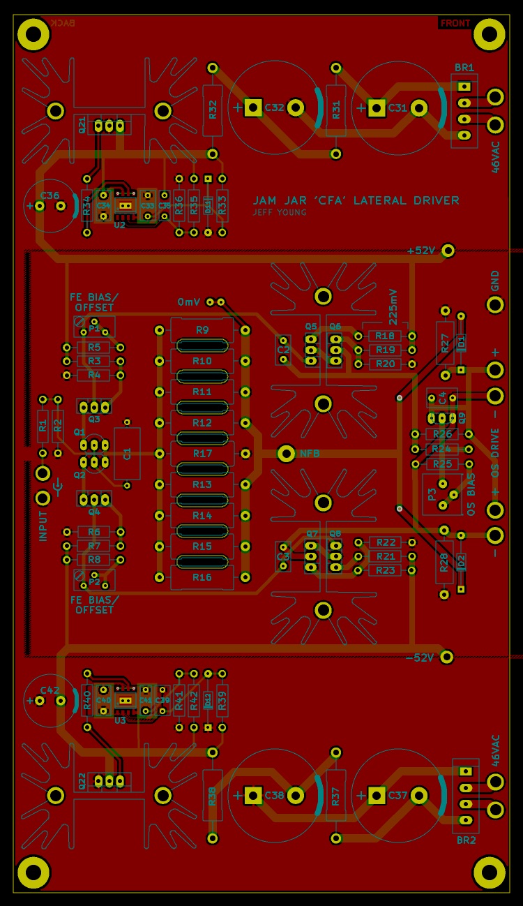

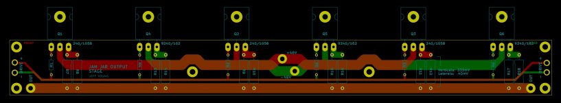

I've retired the SixPack and BuzzBomb names since both have lost the properties from whence their names originated (SixPack now has 12 output pairs and BuzzBomb now has reasonable stability and short-circuit survivability).

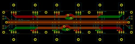

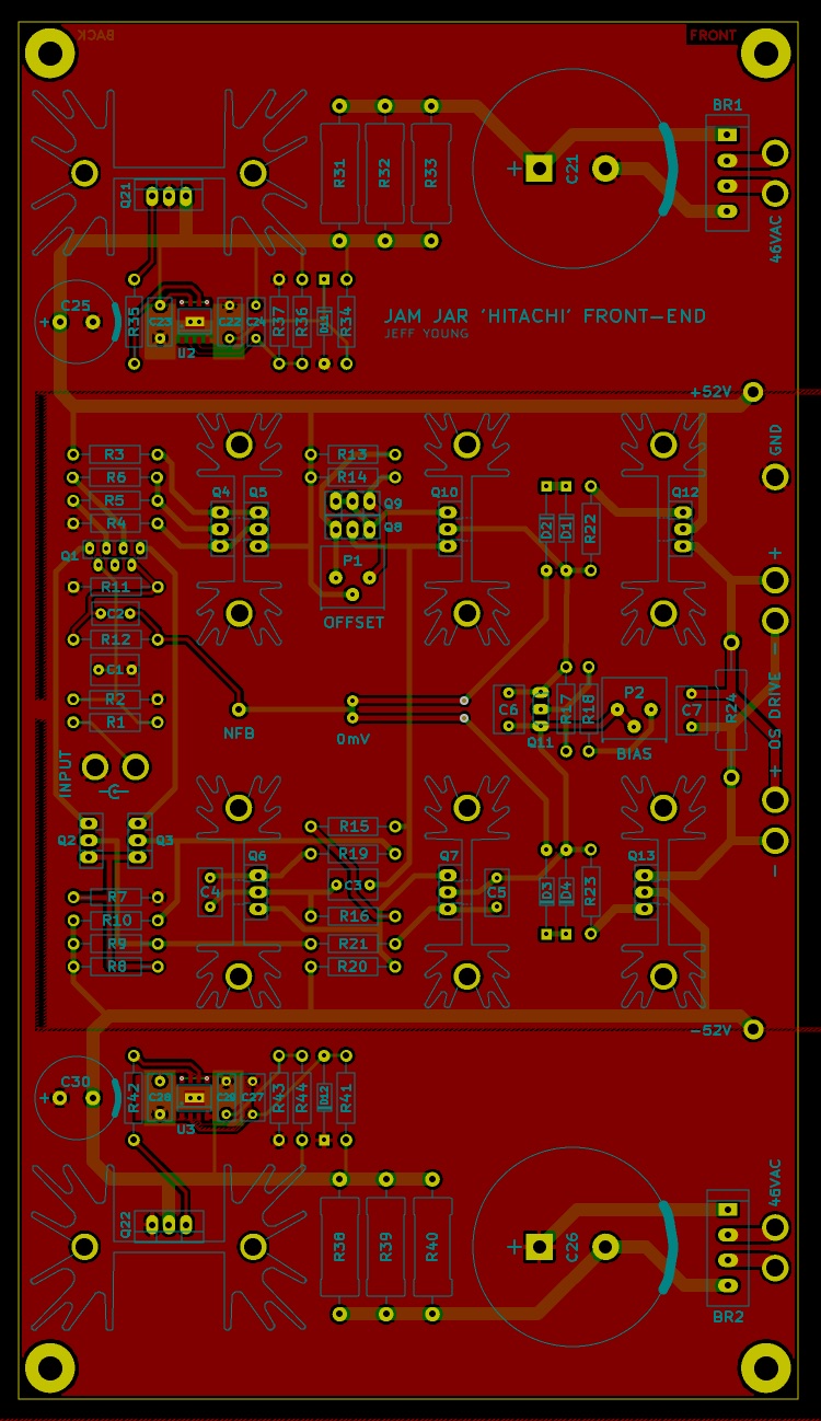

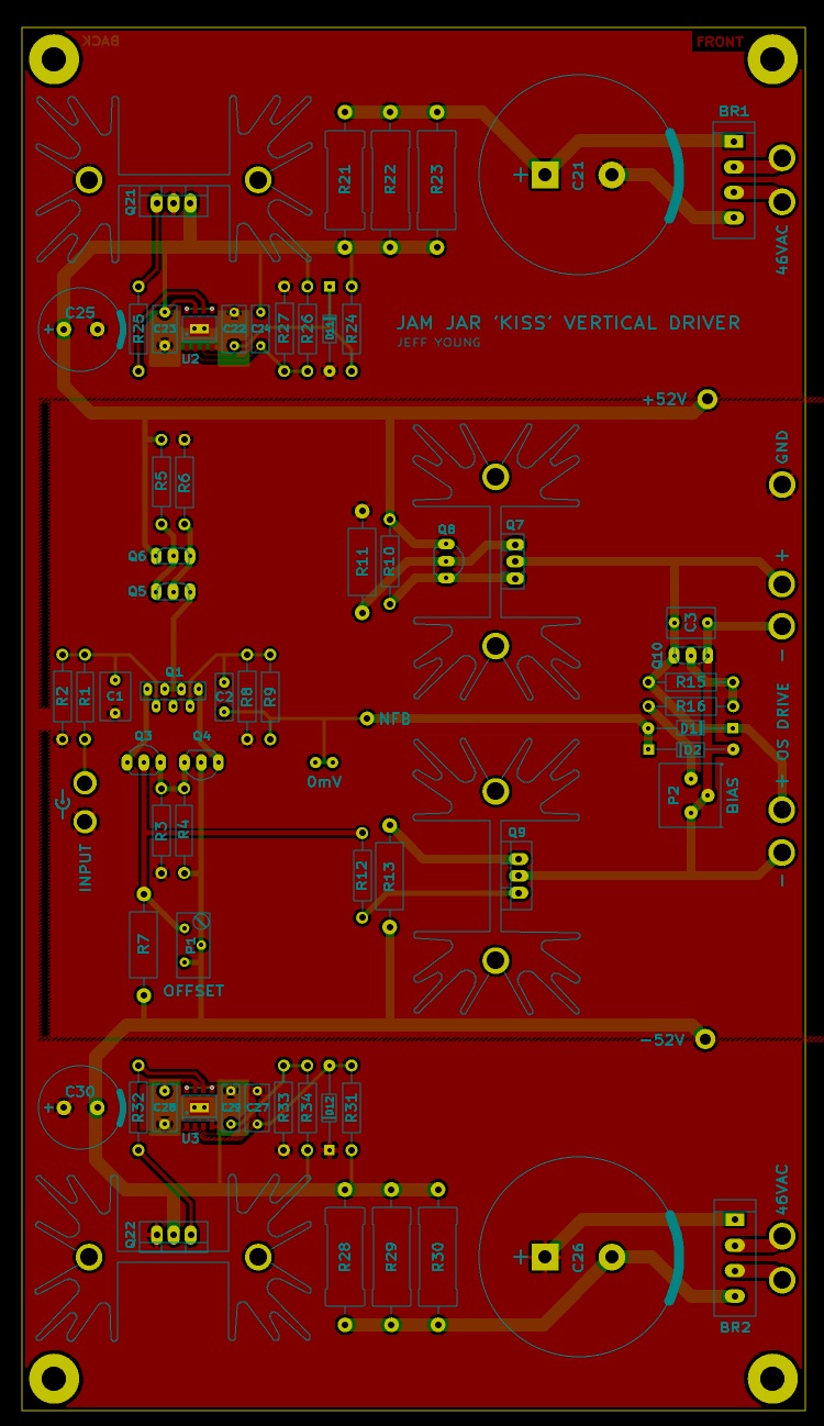

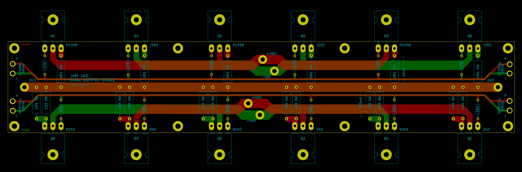

I've also modified the Hitachi schematic so that it contains values for driving either laterals or verticals. This allows one to build 4 different front ends to drive a set of dual-mode output boards -- or one could just choose a single front-end topology and and a single output stage and build that.
Jam Jar 'KISS' Vertical Driver
Jam Jar 'CFA' Lateral Driver
Jam Jar 'Hitachi' Front End
Jam Jar Dual Output Stage
Jam Jar Output Stage
Schematics in PDF; layouts in JPG.
Jeff.

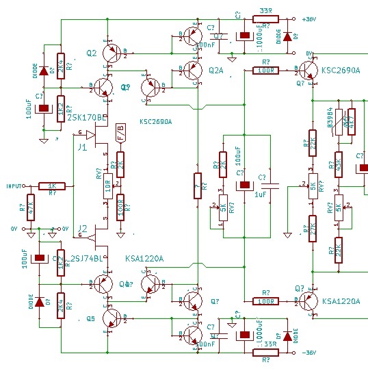

You said folded cascode...
First idea, maybe something like this? Ignore the O/P.
I can't comment on the actual question, but if you put the capacitor in parallel with the resistor on your front-end cascodes I think you'd also want base stoppers for the cascode transistors.
Personally I like simple and leave out both. 😉
...I think you'd also want base stoppers...
I was thinking along the lines of a capacitance multiplier, if the trannies go poof, I'll add some base resistors 🙂

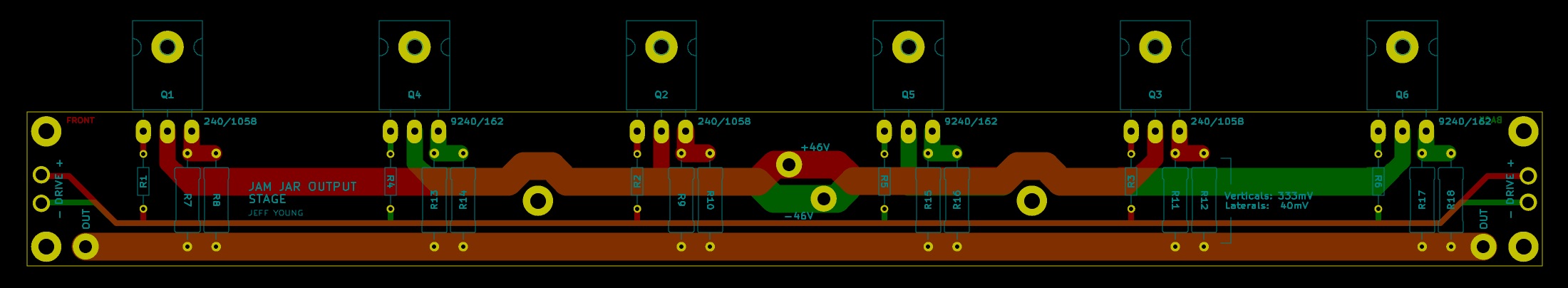

Hi Jeff
1) Lateral Mosfets have a pin out configuration of GSD, not the regular pin out of GDS.
2) I think it’s best that any driver stage that is used is also installed on the output boards like Jam suggested and also like on F4.
Yikes. So indeed. Sort of puts paid to the universal output stage board....1) Lateral Mosfets have a pin out configuration of GSD, not the regular pin out of GDS.
I'm resisting this. If I put the drivers on the output board then I need an output board design per front-end (which makes them more expensive, and means I can't just mount a set of each drivers and swap front-ends in and out).
No problem.

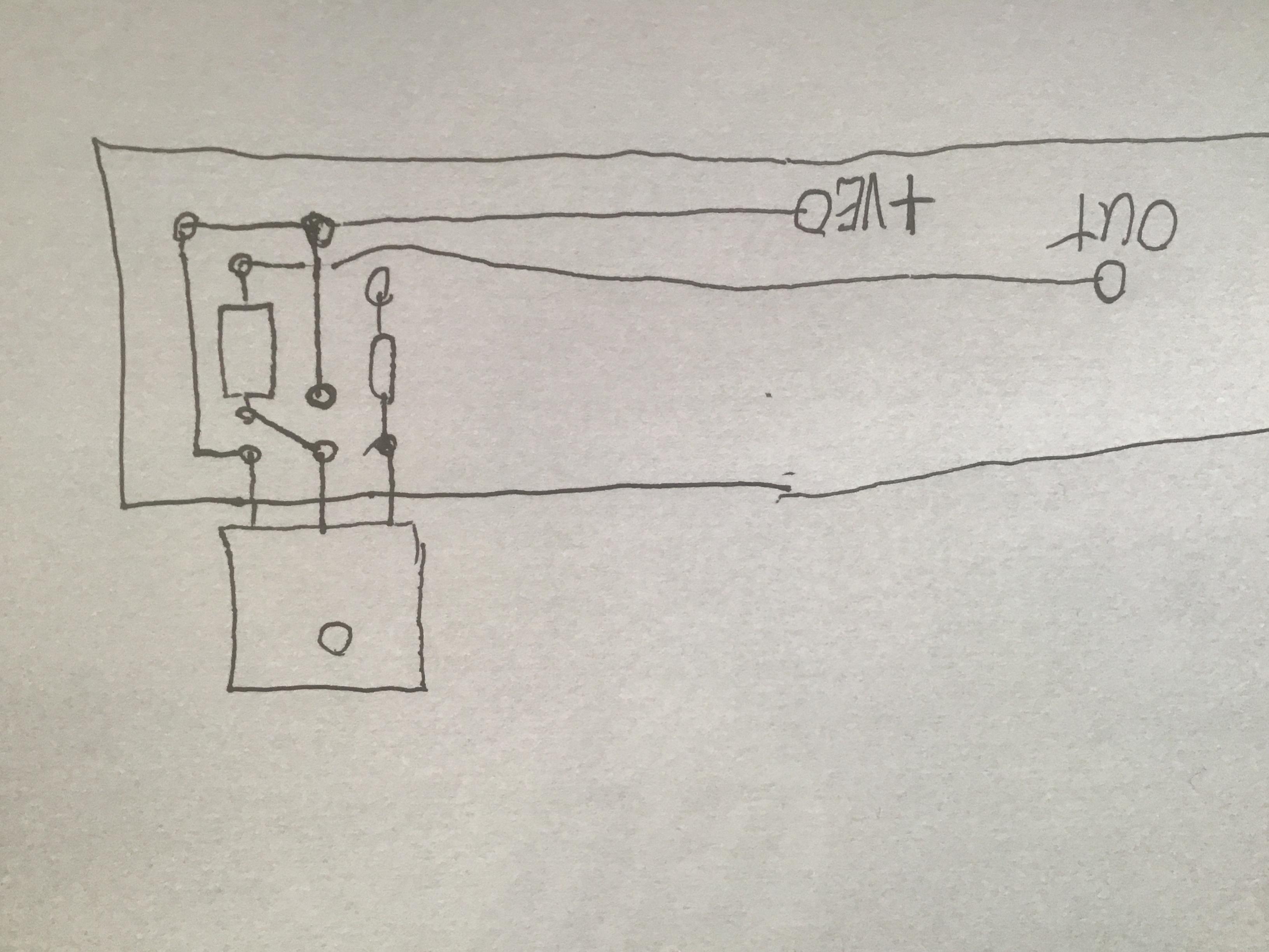

I think you could make it work with jumpers.
If you want some ideas I could draw it on paper.
That's a great idea -- but why not use the resistors as jumpers? Populate one set of resistor holes for verticals, and another for laterals (fortunately the gates don't move).
I think this might be over KiCad's head, though, so I'd have to go without DRC. 😉

Lateral configuration with jumpers.
I didn’t label the jumpers hope it is obvious where the jumper wires are.
I can label if you need, or draw blank pcb without any jumpers inserted so it is clear.
