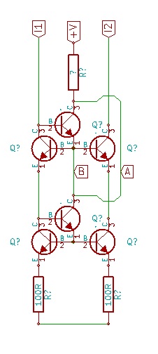

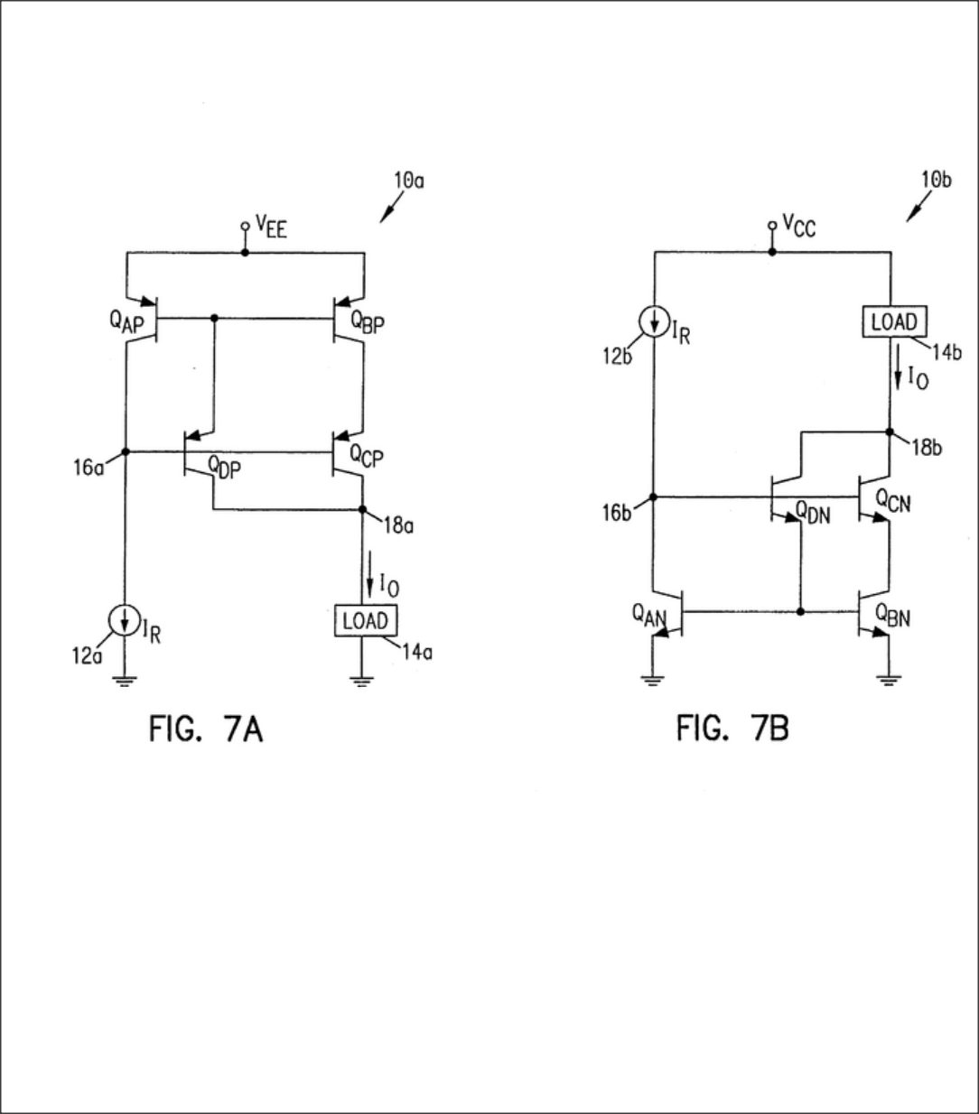

The simple current mirror has an Ib error which is corrected in the improved mirror.
The cascoded mirror is two simple mirrors stacked; if I wanted to address the Ib error issue in the cascoded, I assume connection A is is the way it should be wired, my question is, would connection B work or would it introduce it's own problems?
Sorry for the dumb question, I'm still not spice compatible

This patent should answer your questions.
US5283537A - Current mirror circuit
- Google Patents
...but close observation it is just a cascoded current mirror with early effect correction, which has the problem of reduced voltage swing I posted earlier in the thread .........there is a possible solution.....think in reverse.....

Thank you Jam, Figure 6 confirms connection A.
...which has the problem of reduced voltage swing...
I'm not worried about losing a couple of volts over the mirror, I can just crank the supply if I need to.
I like the folded cascode idea, I'm still still chewing it over, it takes a while with only half a brain cell. These days it's mostly on the fritz!
I'll add the other mirror to the list to try
