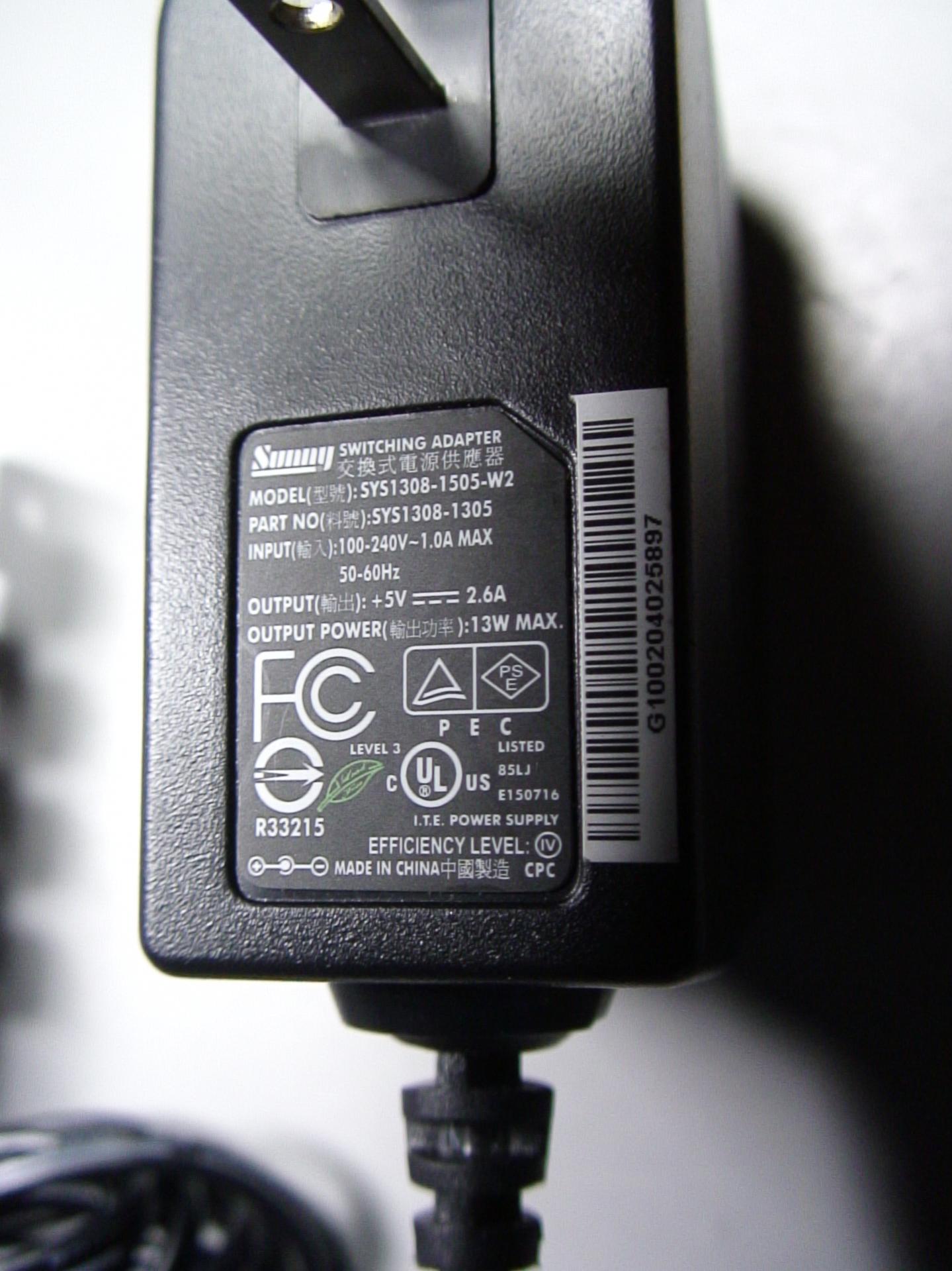

For power I have always used a leftover 5V wall wart plucked from the pile. (I'm sure you have a collection too) SoIL4x4's suggestion for the regi-reg is something I might try in the future.

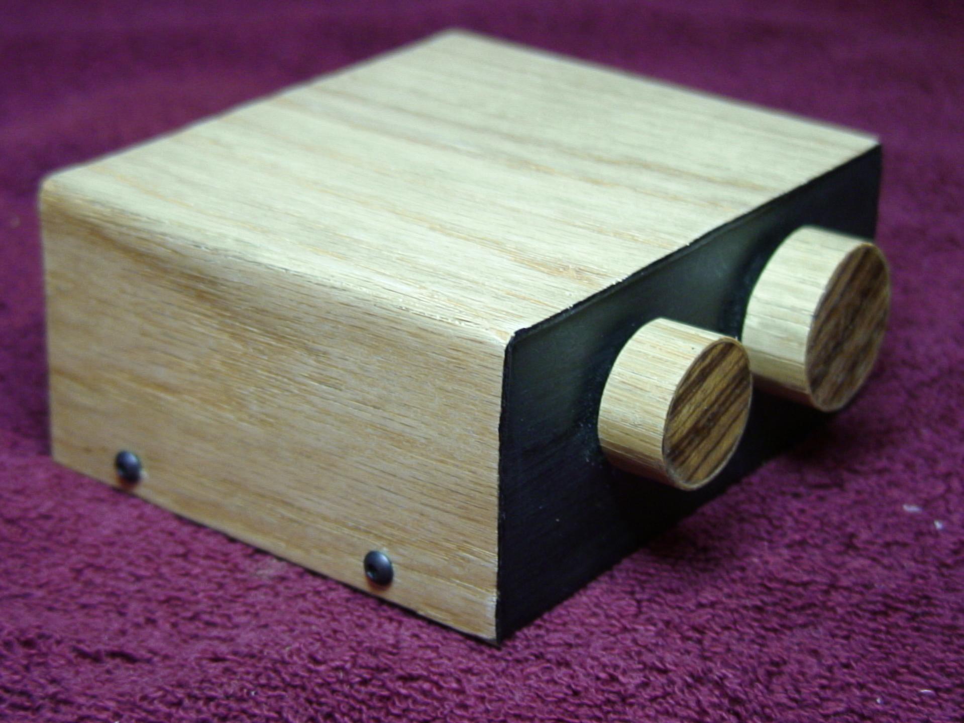

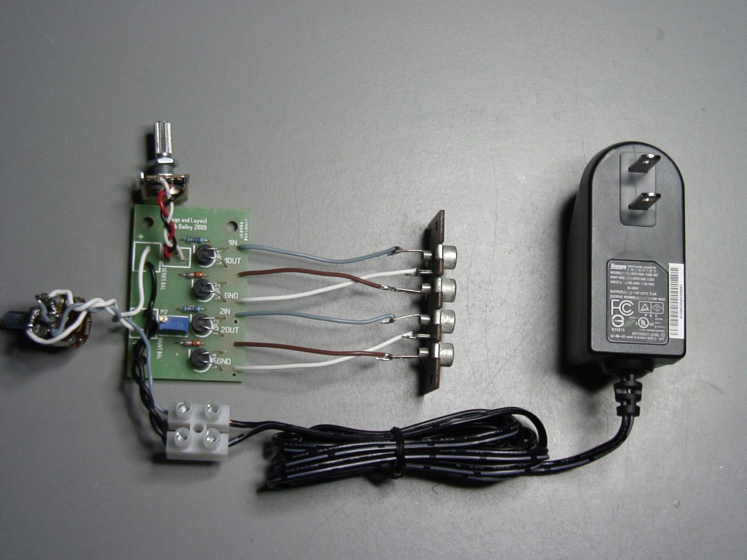

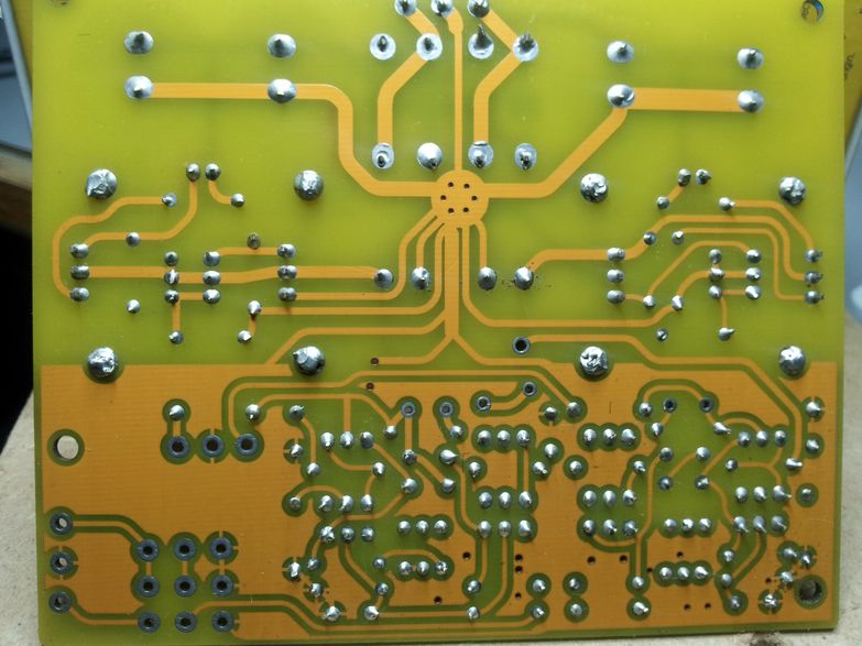

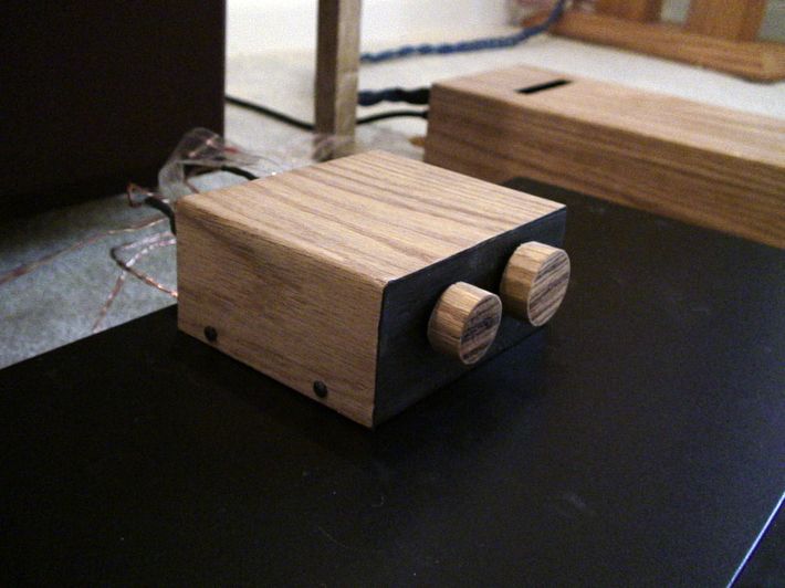

So on picture 2 of the 5 you just posted, that is Uriah's LDR correct ? That's what I have. Which pot is the volume ? Is the other pot the balance ? Is the balance (in this case, LDR) not for panning left to right but for tuning to find equal volume for both channels ?
I thought I read somewhere that a switching PSU like in a wal-wart is not as good. Also, I suppose we should only say Lightspeed when talking about the George Stanshef (sp ?) version ?
Yes, that is the Lightspeed.The big pot is volume.The small one is balance but it only operates within a small range. It should probably be called a "centering" pot as it does not effect the volume overtly.
There are probably beter ways to power this, but what I have works for me. I got the Lighter Note before I had a chance to investigate.

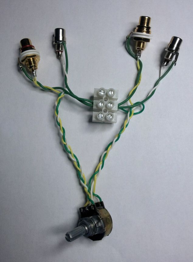

You are correct in all of that. It's also why I recommend that single pot (again Dario's discovery) in the picture. One quality pot is much cleaner and has fewer potential anomalies than any collection of resistor, caps, diodes, ICs and such IMO.
The LDR pot does not need a extention shaft, it can be mounted next to a transformer at the front of the chassis. Only leads from the LDR module to the amp and input RCA's need to be short and high quality. The Silonex light resistors must remain cool during assembly and use. A person could use a LDR module in place of a Alps 27 pot to control a JC-2. A JC-2 only controls volume if one adds a volume pot, attenuator or LDR at the front end of it. Otherwise, it's just a input signal booster.

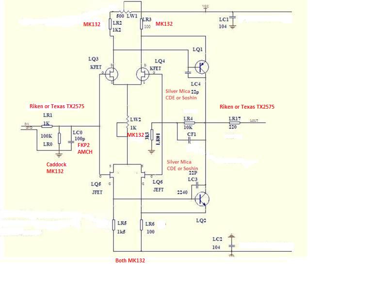

Here is a preliminary shot at some parts substitutions from Dario. A version based on hands-on experience will follow in a few weeks.
......but all that Caddock would cost a fortune, I would probably use them only for LR0 and, maybe, LR01.
LC0 should be also important and I would use a Amtrans AMCH or , at least, a Wima FKP2.
Looks like it will be another fun ride. All suggestions, theories and opinions (about the pre 😉 ) are welcomed. I'll do a cost estimate of this package and post it shortly.

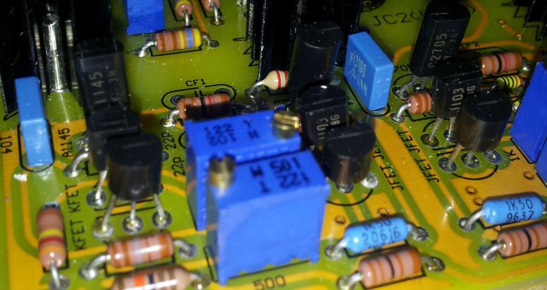

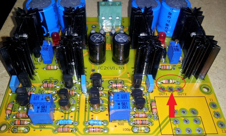

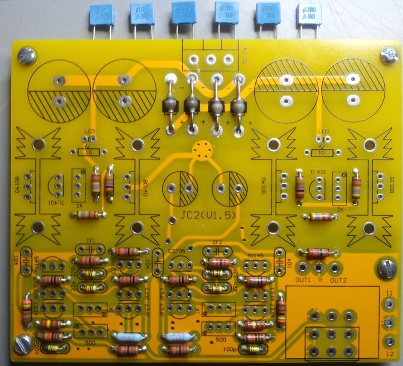

Just for the fun of it I also ordered one of this kits 😀
One thing I noticed; In the picture of the kit the PCB is printed V1.5 while on the board which he is selling separately it says V1.6

I just asked him the question via Ebay.
Maybe it's an old picture like you said. Just wait and see what he will answer.

This is the reply I just received from Jim's Audio.
"The schematic is the same since v1.2. The changes are only some trace rerouting.
The current kit in stock is v1.6."
So, mystery solved. 🙂

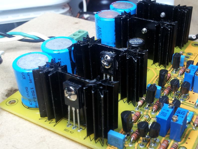

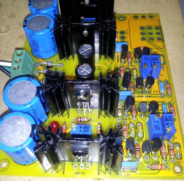

My kit arrived today. 🙂
Regards
Wow. That was quick. How does it look?
Great, It will be interesting to hear your impressions. Make sure you pay attention to all the transistor numbering/markings. I had to start over cause I didn't. Everything is pretty straight forward. Double check that there are no cold solder joints before powering up.
