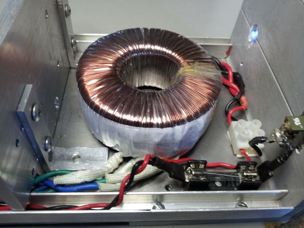

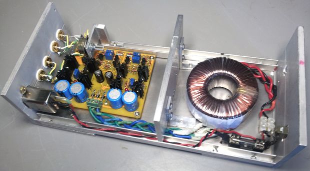

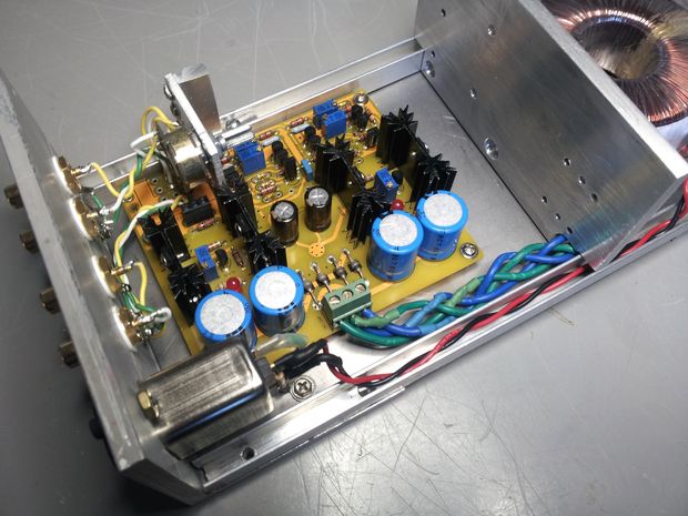

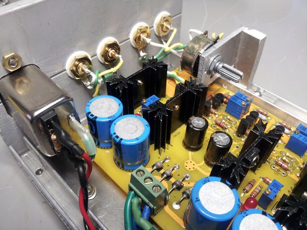

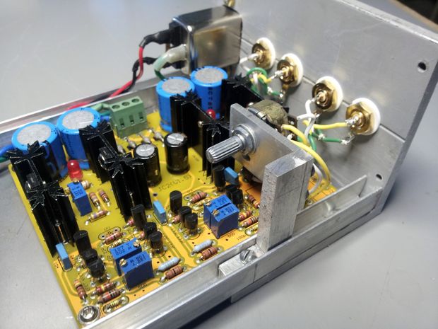

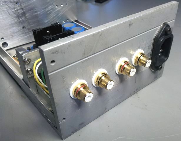

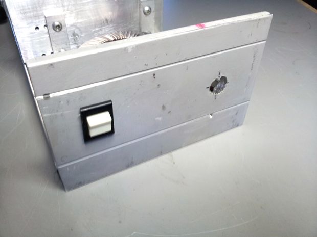

Here are some photos of my current build process. Still needs pot shaft extension, clean-up and painting.

Great work so far Bob. I am very interested in this project, it may be a good alternate for me if the LN does not work out. Mating it to the MyRef FE project is a great idea too. I think having more FE RC users with a similar setup will help the group agree on the improvements of various component swaps. The price is hard to beat too. A savvy builder could probably build a finished stock unit for around $100.

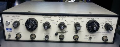

Out of curiousity, have you ever run a square wave through the pre amp?
I'm curious to know at what frequency the square wave starts to visibly start rounding off.
This is an arbitrary request, i know it would have little to do with the subjective sound.

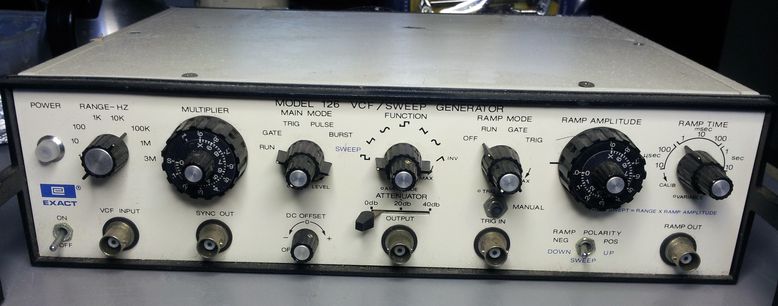

I just started collecting tools to get into this area. Installed RMAA6 and Visual Analyzer, dug out my signal generator - but it will be a while till I understand what I am doing.
I did shoot off a message to Stanton requesting any publishable data he may have from the development process.

Antek AN-0518 right now and have no problems. I intend to try an R-Core at some point primarily because I've never had one and they are reported to be quieter. The toroid itself is silent and there is no hum from the JC-2. The only advantage I could imagine is just cleaner power to drive the circuit.

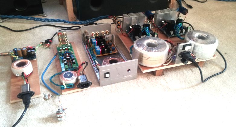

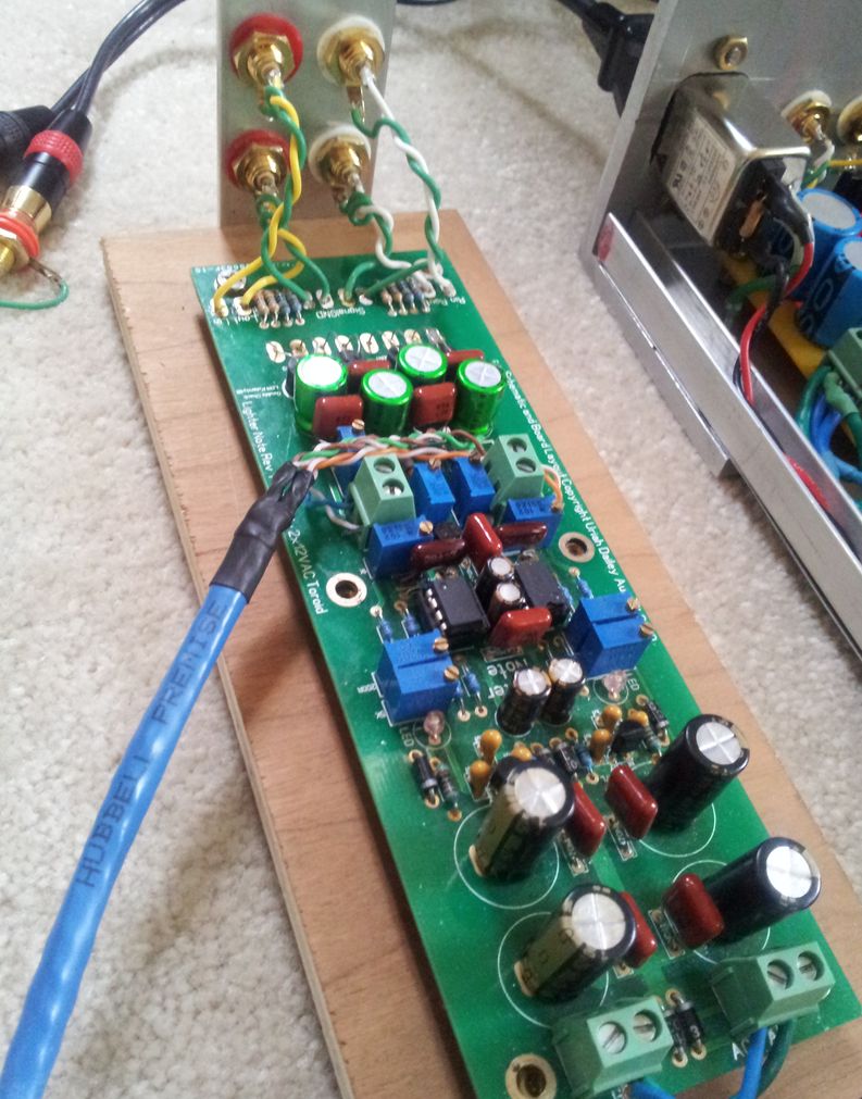

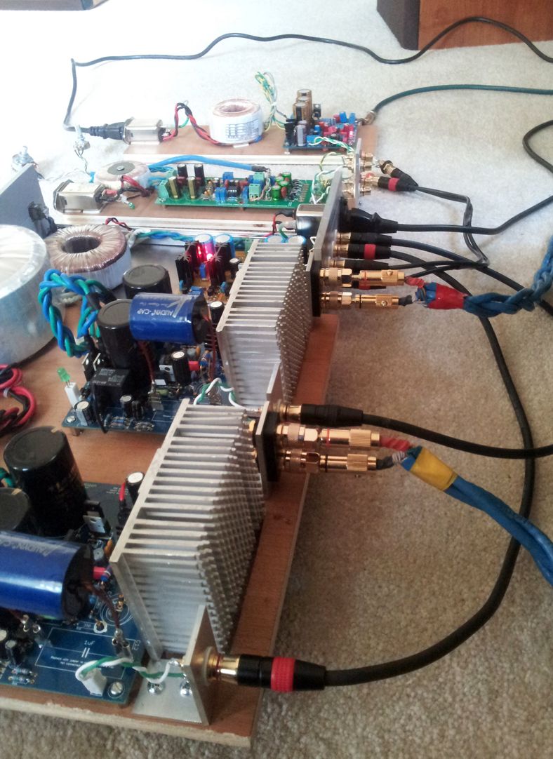

FYI,

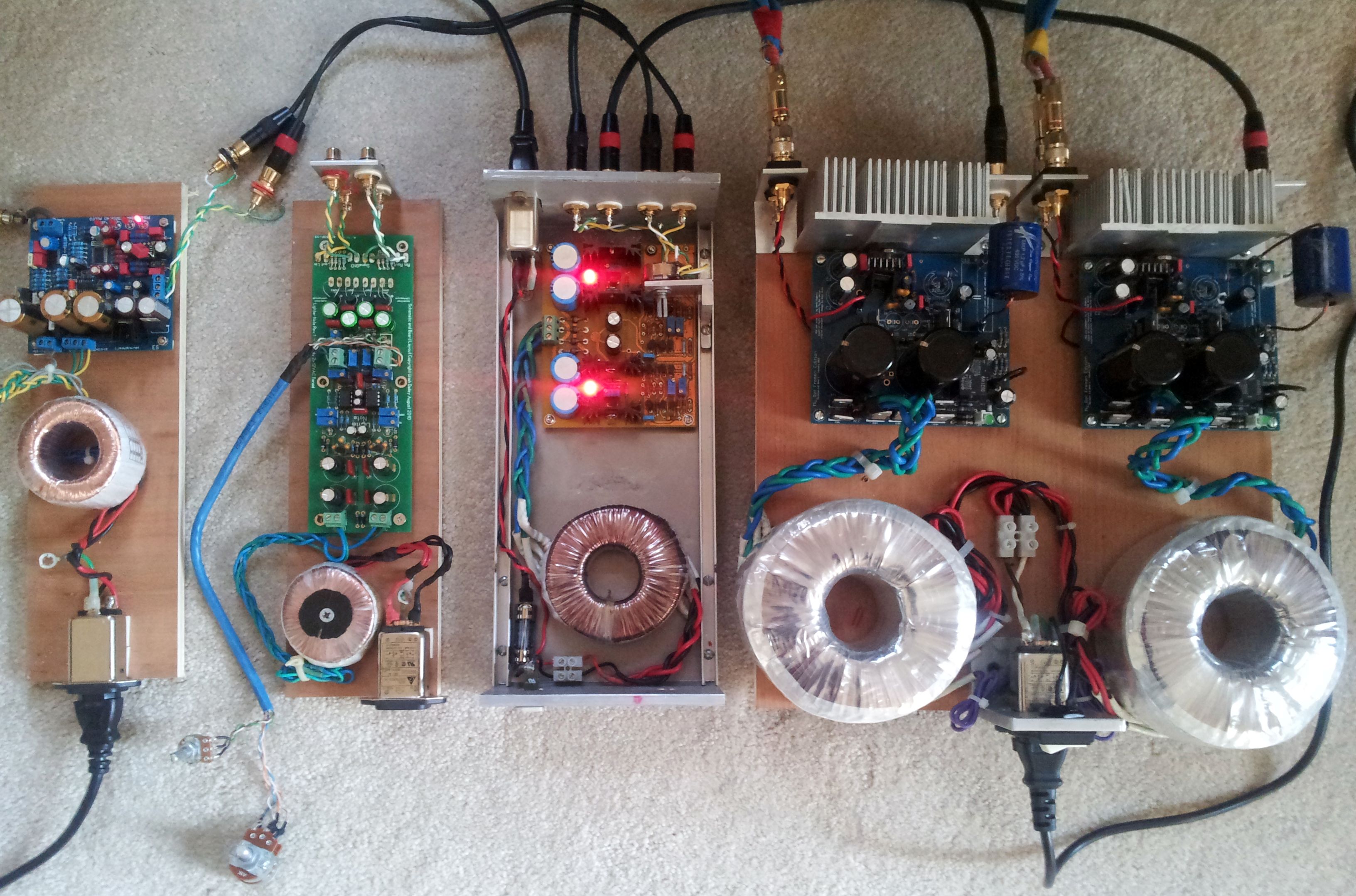

I did some testing this morning. The Lighter Note had been in a different build till last night when I reconfigured it as a stand-alone piece with new wires and RCAs. This was the first time I was able to try it with the FEs. The source was the Mini DAC fed with a computer. I set the volume on both the Ln and the JC-2 to peak ~ 88 db.
The Lighter Note still sounds as clean and pure as ever. There are element of sparkle, airiness and immediacy I have never found with any other device. Bass is full and controlled, mids are punchy and balanced and I get the impression there is nothing being left behind on the source. A pleasant surprise was a lot more available SPL when attached to the FEs. I could not max out the LN pot as was necessary with the V1.2 and V1.3 builds. I would assume that is much the result of the giant 300VA toroids as well as some of Dario’s approach.
The JC-2 held its own, was super close with a few cravats. More than ever I detected some horizontal drift as the volume pot was adjusted. It was serious enough that I wasn’t sure I was getting a truly centered image. I used some audio software to create a mono version of a song with a strong vocal (Paul M’s “Say Say Say”) and played it through the system while adjusting the LN balance pot. The musicality and range of both units was a very, very close match. The stage width was almost identical but the LN had a clear advantage in depth.
I still think the JC-2 is a top choice here for a few reasons.
1. The “Swap & Twist” dance (Dario’s Salsa shuffle) we did on the FE beta run convinces me that proper component choices and placement could recapture the superlative upper end of the Lighter Note. Same for the depth of stage.
2. The stage drift is not present with the JC-2.
3. Cost differences – The JC-2 may be a more likely choice for builders on a tight budget.
I do want to state clearly that I still believe Uriah’s LDR devices are IMO – top notch. He has openly stated a redesign of the Lighter Note is in the works with the goal of simplification and I suspect he will also address the drift. I'm sure some of what I have mentioned can be corrected by adjusting the many on-board trimmers while listening to live signals, as Uriah suggests. To date I've done all my calibrating on the bench with a VOM. Nothing needs to be changed in terms of sound quality and purity. I’m looking forward to his quick recovery and more of his magic tricks.
I’ve also taken the time to read through the other two JC-2 threads and am more convinced than before that this is a great point of departure. It appears Stanton has done his homework and several people are quite pleased with the results.
I did hear from John Curl and his response was similar to that from Parasound. Paraphrasing – “Have at it boys, just remember that the eBay offerings are not my circuits/implementations, nor those of M Levenson or Parasound."
So there we are. There's lots of schematic and components variations on the other posts for those so inclined.
